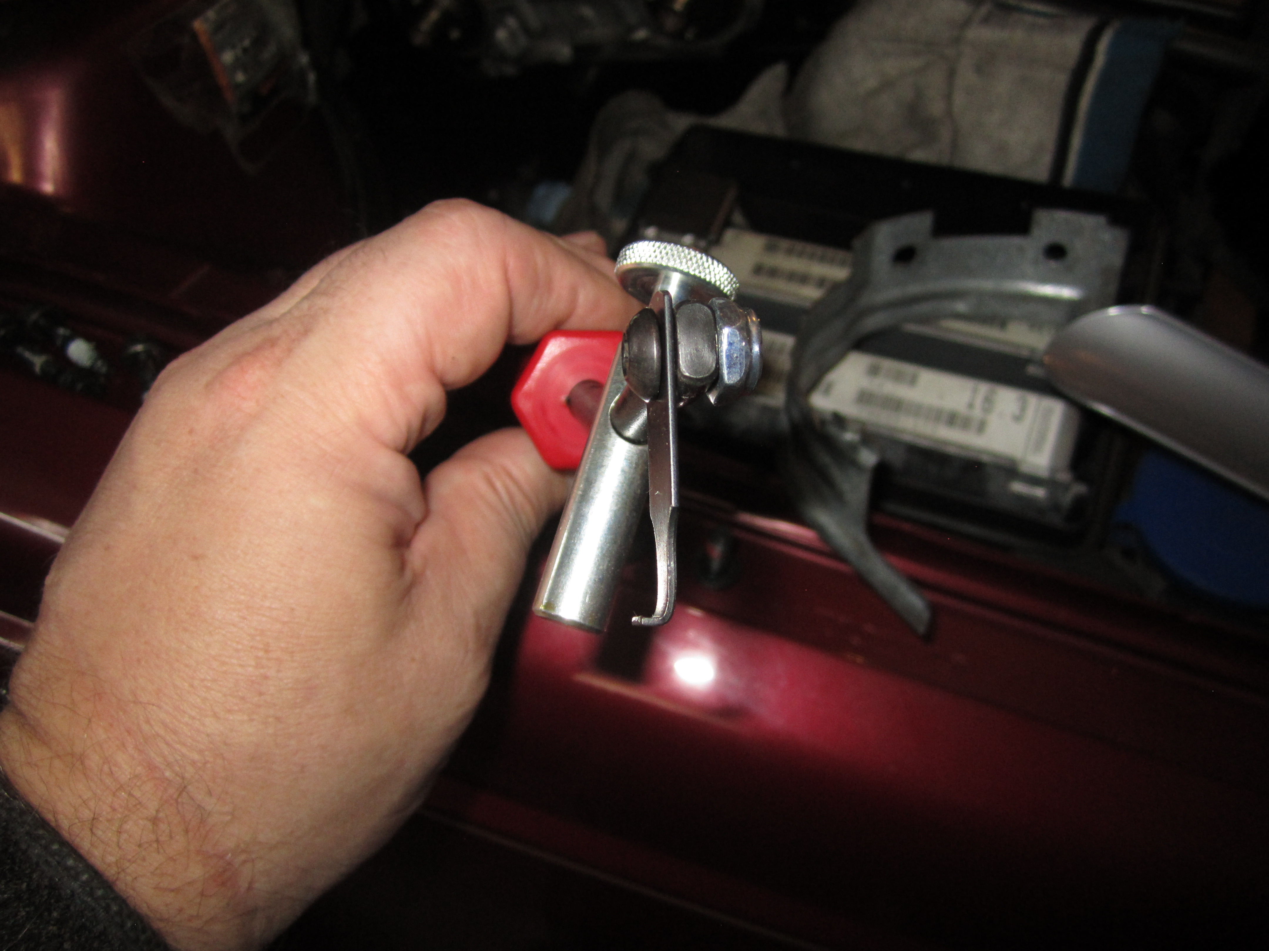

Thought I'd give an update on this. I purchased a Lisle shaft seal puller and tried if for the first time today on the intake front cam seal. Worked very well and I am suitably impressed for a relatively cheap tool. All you do is inset the shaped blade into the inner edge of the tool with the leg with the thumb wheel on it loose and turned 90 degrees, turn the blade 90 degrees along with the leg, tighten the leg so it is parallel to the extraction leg and using the silver leg as a prising tool it just popped the seal out easily and no fuss or damage.
You can see the silver movable leg.
This is the part you push under the inner edge of the seal against the shaft/cam then rotate by 90 degrees so it becomes a hook.
Tool comes with a spare extra leg and can be set up for left or right operation.

I don't understand what the silver adjustment part of the tool is for???
