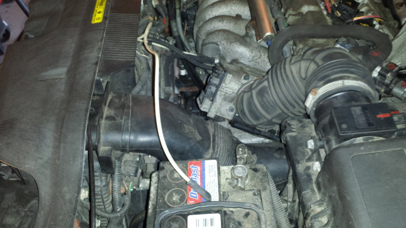

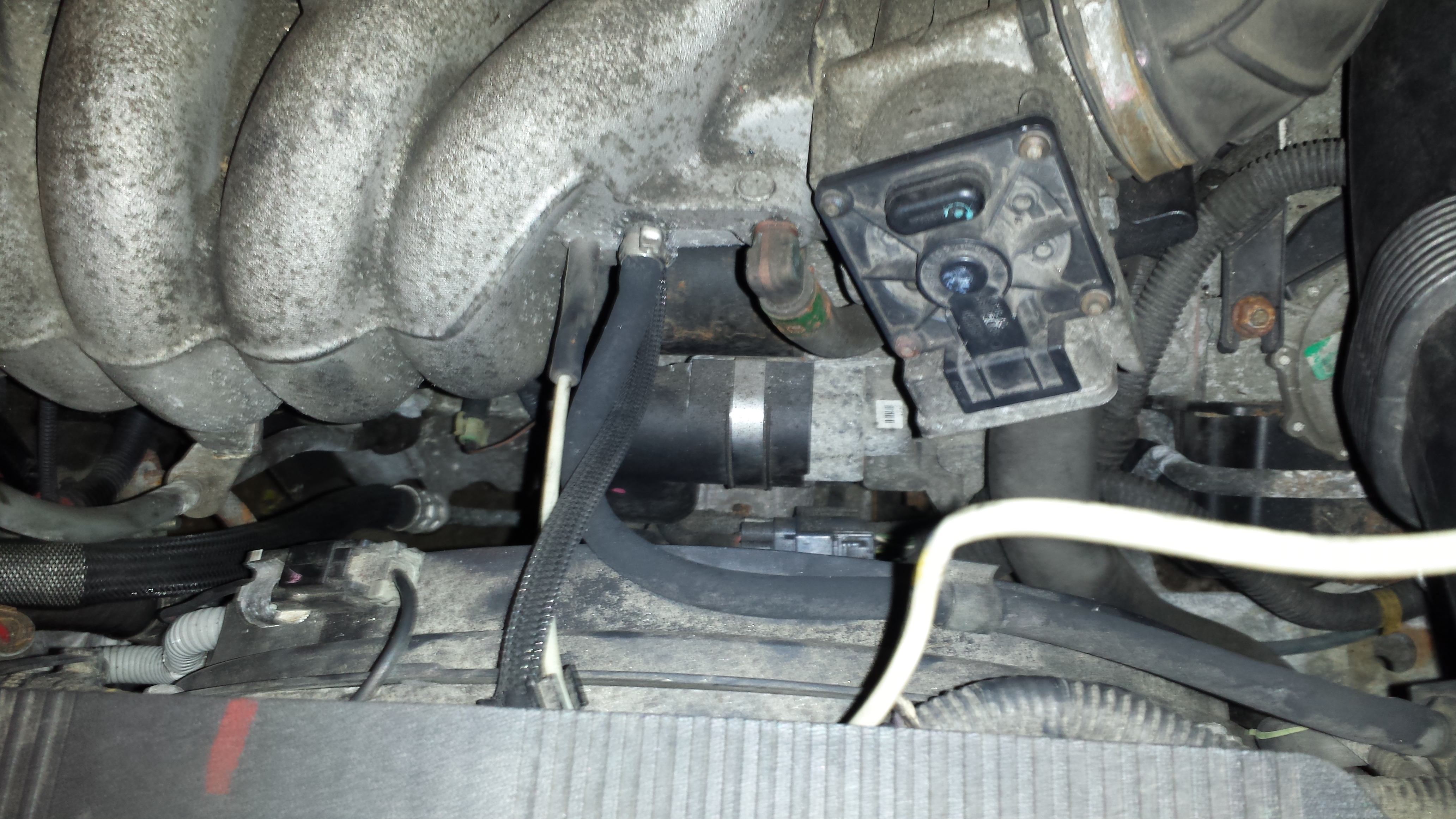

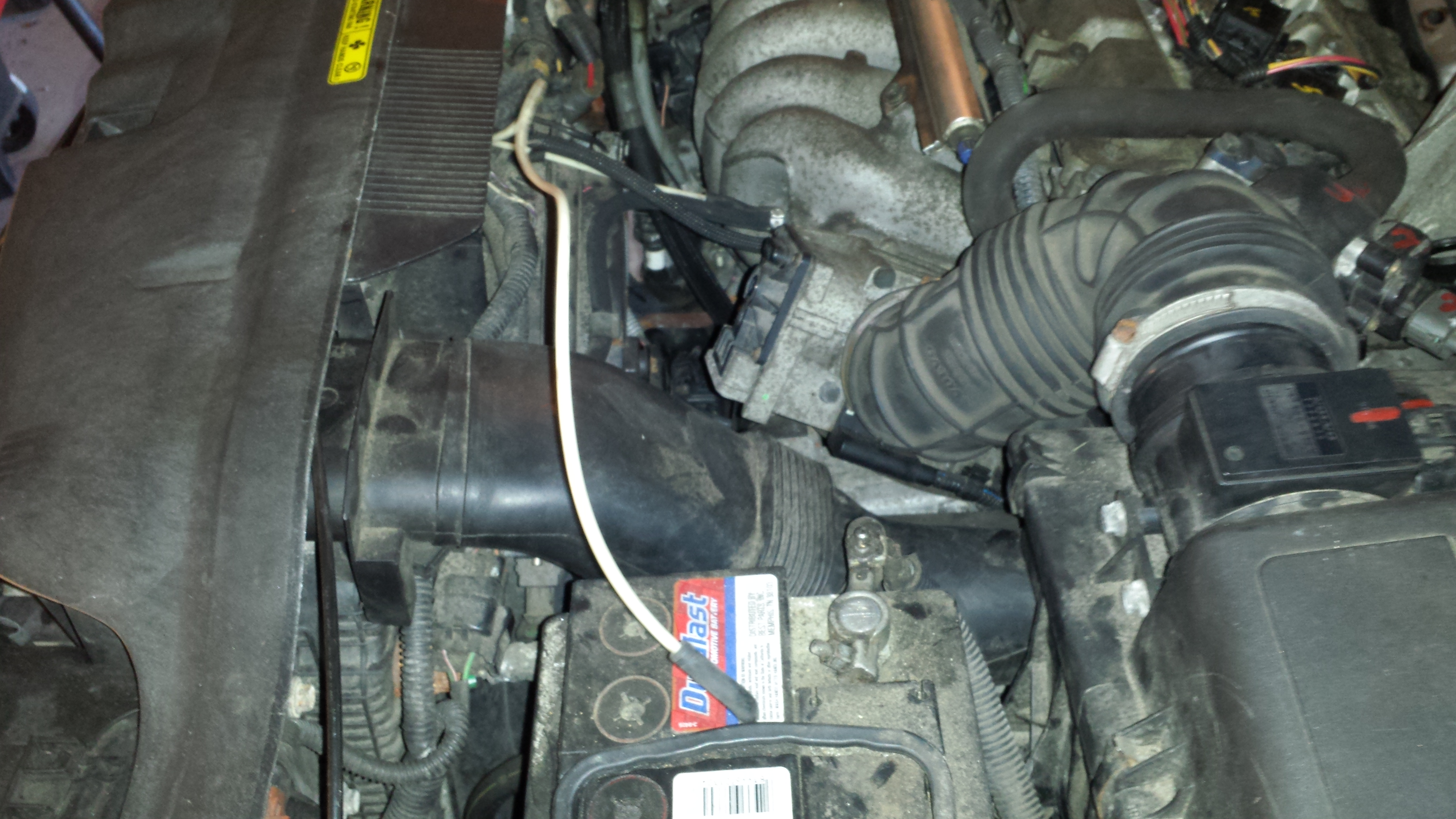

thanks for the responses.....I did check the head with a straight edge which looked good so I decided to just put the head back in without doing all the work on valves and such....head gasket was actually good...what I found was 2 loose head bolts by cylinders 3 and 4 which were filled with water...car is back together and runs and sounds good but does not accelerate when I push down on gas peddle...it just bogs down. Now I did end up with a vacuum line that comes from the intake manifold..i swear I marked this when I took it apart but I cant figure out where it goes.....I have been looking in vicinity of throttle body but have yet to find it....when I do push down on accelerator I do hear some what of a sucking noise just haven't located and im pretty sue the vacuum line is the problem....its a white 3mm vacuum line...does anyone have an idea where it goes to from the intake...Thanks

There's a handful of vac lines, a pic will make it crystal clear if you can post one. The site can host pics directly. I don't actually know the vac line routing very well for 2000 but someone will know.
Is this car a turbo or NA?

Greetings. I popped my hood to compare to mine . No match. You must have a non turbo.
