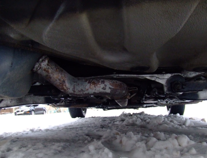

Here,s how my chain is attached. It seems solid, it passes above by two frame rail holes - normally covered with a rubber cap. The muffler must be lowered to see these holes. Note that I don't have the muffler heat shield any more, which might be in the way.
Also the center hanger just before the elbow. Sells of Ebay but found mine on a scrap yard - quite easy to find one.
Notice how the tail pipe is completely broken where it enters the muffler. I'm about to weld it back in place but won't use it again to hang the muffler.
- c.jpg (99.71 KiB) Viewed 676 times
- b.jpg (120.34 KiB) Viewed 676 times
