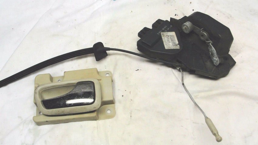

hey Sonic, thanks for the reply. The door still lock and unlocks fine. I'll keep an eye on it! I just found pictures of the wire you're talking about...
You're right, not too expensive off eBay!

As far as these little toggles are concerned, I really think the grommet is more important than it appears to be. Both my front doors have issues with the toggles being or becoming bent / misaligned etc., and both of the toggles are missing the grommet. My back doors I believe still have the grommets and no problems there. Now, I don't use the back doors as often, but I think not having the grommets up front gives the toggles just enough play that snagging them on clothing or with your hands or elbows (reaching out the window to grab your tacos at the drive thru?.?.?.?.) starts to misalign and slowly starts to bend the pretty flimsy metal guide rods and eventually after many minor hits they can pop off internally. For some reason even though my passenger door locks and unlocks fine, the toggle is barely above the door panel when unlocked and almost flush with it when locked. I've tried bending the rod and getting it to stand straight but with that grommet, it's kind of too much to expect, esp. given the relatively light construction of this aspect of the unit.
I prefer a door lock mechanism that doesn't use these vertical toggles but instead uses the pivoting tab near the inner door handle release lever. Toyotas and Hondas seem to use the latter style more often than not, not only in the 80's and 90's but these days as well. But I think the vertical toggle is just past its prime and should be done away with. But in the meantime we have to work with what we have.
I'm going to go online and look into getting a pair of new OEM grommets for my front doors and see if that improves things. The used grommets are pretty much free at the junkyards as long as you pay for one real item, but they aren't worth it because they are too brittle most of the time to even get off without breaking them. The toggles on the other hand might be $1 a piece at the yard and a solid non-contorted one would probably be well worth it. Once you have the door panel off and see how they attach to the lock actuator you will be surprised that they haven't popped off before! Just a friction fit to a little circle tab, that's it.
