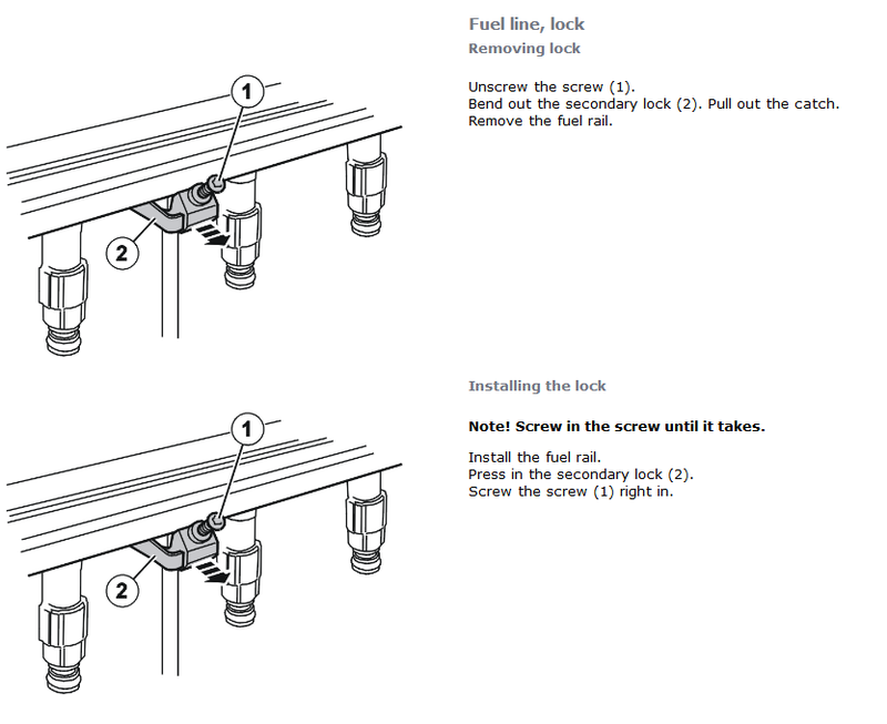

I did my PCV job two years ago and I disconnected it without any tools. I don't remember how exactly I did it but you have to take the top piece with screw out and then the fuel rail will disconnect. Just make sure you release the fuel pressure first.
Here is what VIDA says:
fuel line.png (90.49 KiB) Viewed 5091 times

The new style, I removed one at a scrap yard like in the picture above: remove the screw, then lift the clip of the plastic part that keeps the screw (the clip is seen at the right) and slide this part off, then the line is disconnected. Just used my hands, easy to do.
