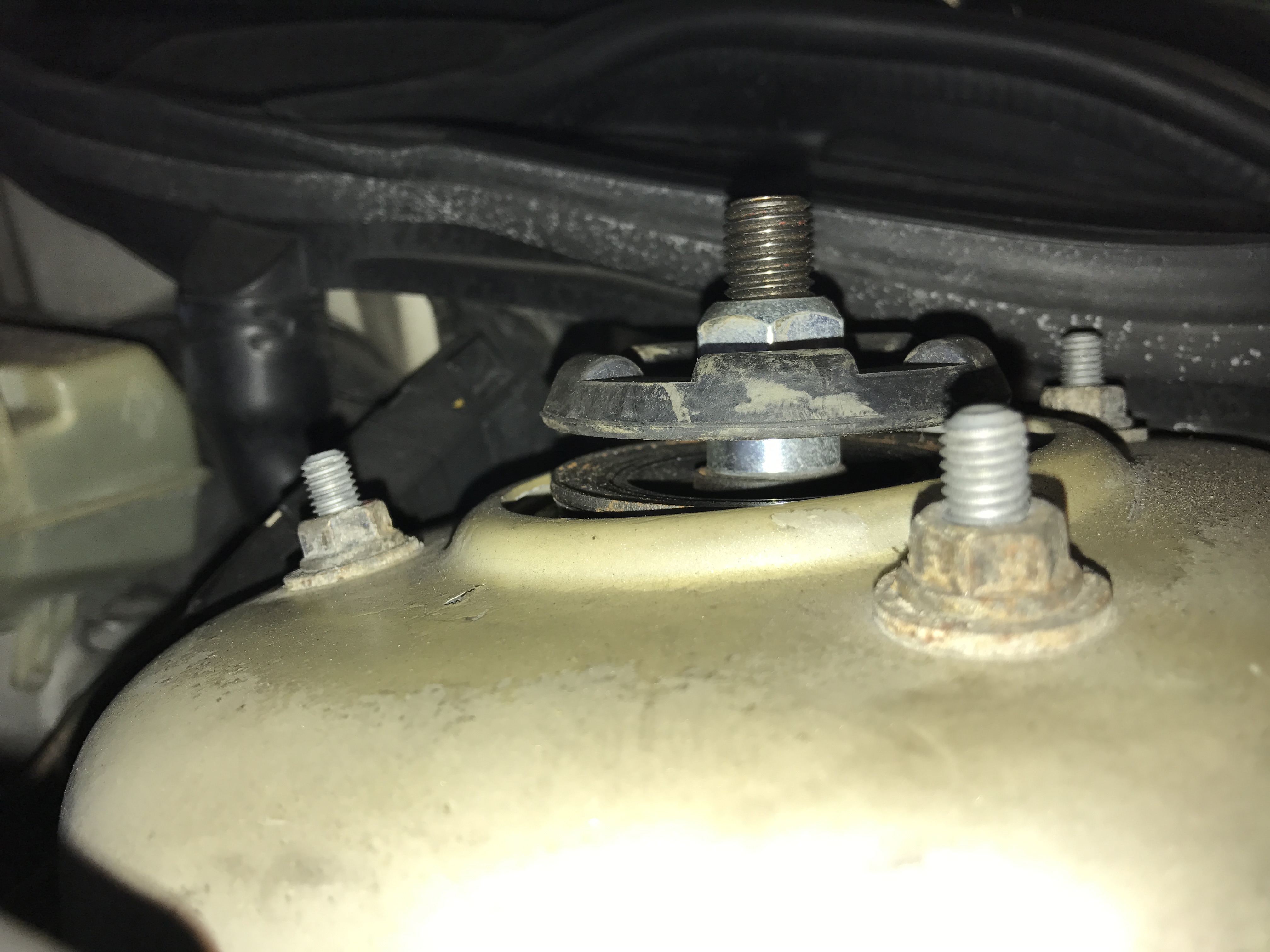

Hi guys,
I got my struts replaced last November along with new mounts, etc. on my 96 850 wagon. Now that it's springtime, I'm just noticing now that the struts seem to be sitting kinda high...it also looks like the top washer is upside-down; if so, is that repairable without removing the entire assembly? There is also a gap that doesn't look right, but that may be because of the top washer being inverted. Ideas?

Does this look right to you?

Just undo that upper bolt and install the washer properly.

There is supposed to be a gap even when the washer is on the right way. Yes the washer is upside down and what misha said - go ahead and turn it over.
I can't be certain from the pic but hopefully you will find a cross0shaped nut underneath, like this:

Flip the washer around. As long as the cross nut is in place, you should be able to safely remove the top bolt and flip the washer. For some reason mechanics never put those on the right way on these cars.

The top rubber stop plate is upside down in the first picture.

Hey guys, I finally got around to attempting to flip these caps over, and I see that the mechanic also over torqued one of the nuts to the point that it is slightly cracked. I have not been able to locate replacement nuts at any local parts places; anybody have a good place where to order them? They are Bilstein Touring struts with a 22mm shaft. Thanks!
