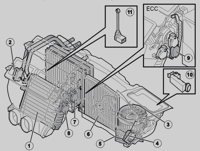

2. Also regarding the AC. Just had a recharge, and it seems that real cold air is only coming out from the passenger side. Even that isnt that cold, and the guy who charged it said there wasnt any leaks... How could this be on one side only? I have ordered a 2nd hand CCU incase it electrical there somewhere. interested to hear your thoughts?

Air only on one side might have to do with the actuator or swirl arm on the ccm. I believe it's part 9. Maybe give it a check, careful not to disconnect anything electrical or a SRS message will go off. You can just turn on the ignition, unscrew the motor - it has a small pressed in hinge on the right side, then move the hinge with a screw driver.
