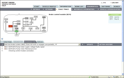

Hi folks,
I get the two error messages below from VIDA:
Before I send the module to Xemodex, I want to go through the BCM diagnostic flowchart they have on their site but I am stuck with the measurements.

Hi all,
I got the BCM fixed by XeModex as per my first post, errors disappeared.
After a few weeks, the BCM-0070 appeared again, as per note of XeModex, if one of the two codes appear again, the pump motor is faulty and needs to be fixed.
So, I am about to pull out the hydraulic unit and send it to XeModex.
I intend to follow the instructions provided in VIDA.
