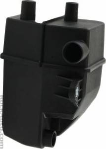

MDK here, so what happens is that over time the " oil trap ' that is below or under the intake gets clogged up and crankcase is trying to relieve the pressure. This unit is bolted to the engine.. a real ¶%©@ to change. Anyway, it causes pressure build up hence the cam seals both front and rear leak if you were to put an air pressure gauge on the dipstick tube you should see approximately -5lbs. I've seen these replaced and the oil leak goes away, but not always. It may be listed as an oil separator.. same thing.
- ABH0267FRO__ra_m~2.jpg (5.91 KiB) Viewed 415 times
