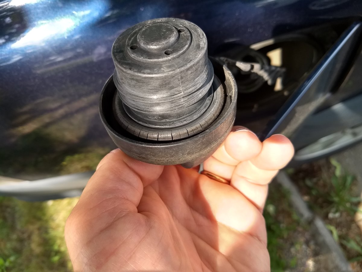

After fueling up one snowy night in March, the CEL lit up and has been since. I got codes 2407 and 0455 which indicate the leak detection pump circuit intermittent/erratic and major leak respectively. My gas cap seal is all cracked up. Any ideas?

I think I’ve got a spare Gates one if you want Tom give that a try first, FELD.
Since those two things are linked in function, I would replace gap, then clear codes, then drive it to see what comes back
I don’t think the 2000 uses a leak pump, is this on a newer P2 car?

Clear the codes and see what comes back. Fix the fault in the Leak diagnostic unit, ECM-431D (P2407, before you go chasing the ECM-404C (P0455), which maybe a incorrect detection due to a faulty leak detector.
