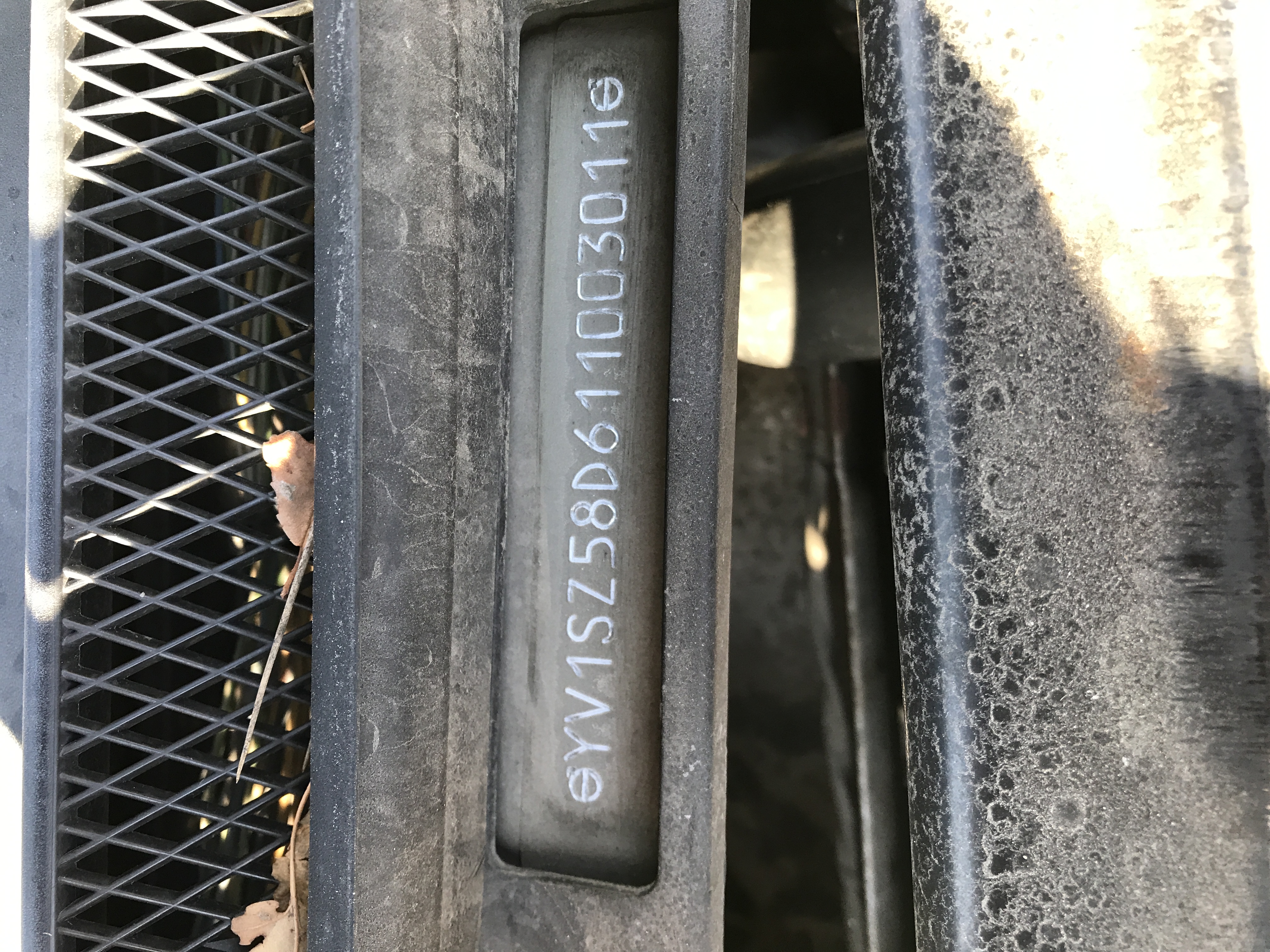

I appreciate any help on this, I have also included my VIN number if that offers any insight to my novice question. Thank you for any help on this!
VIN: YV1SZ58D611003011
