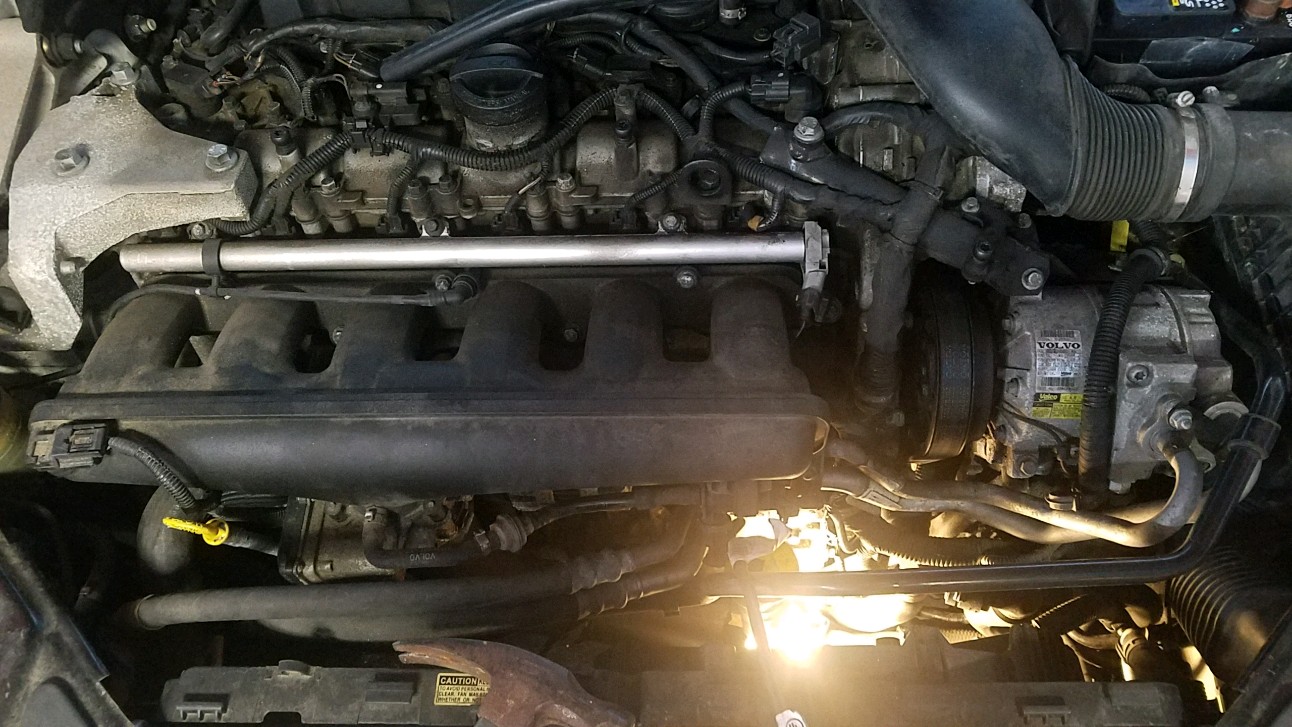

Hello,
Can someone please help me determine where the starter is located on a 2009 S80 T6 engine. I'm attaching a pic of the engine.
Thanks a bunch!

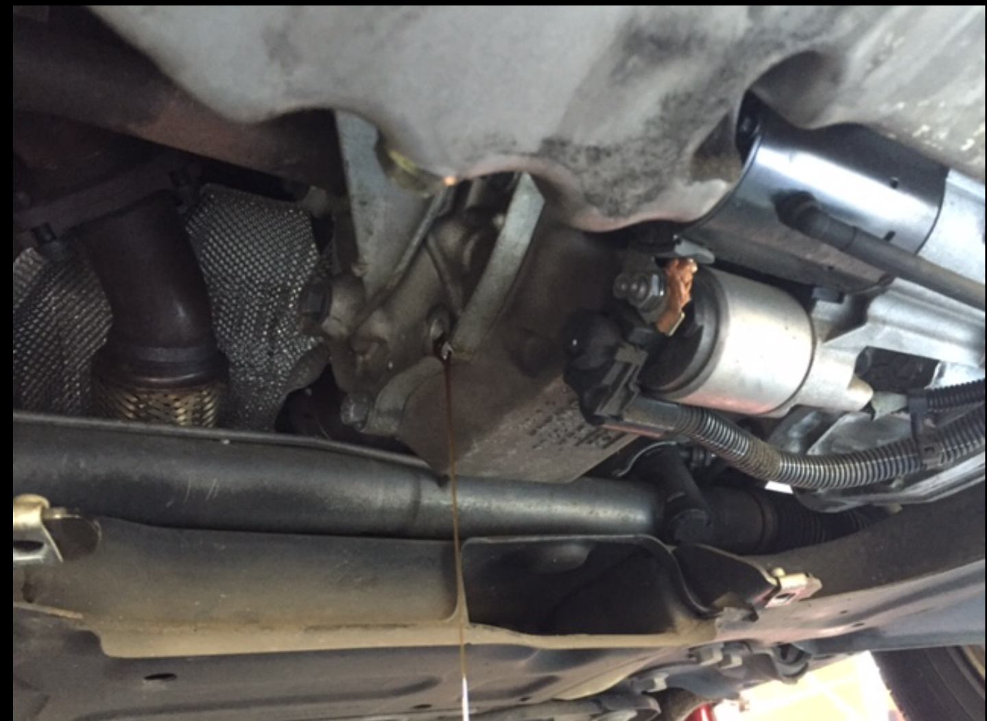

The starter is at the back of the engine on the bottom.
A picture from my LR2 with the Volvo 3.2
Take care
Paul

Thanks! I found it and appreciate the help!!!
