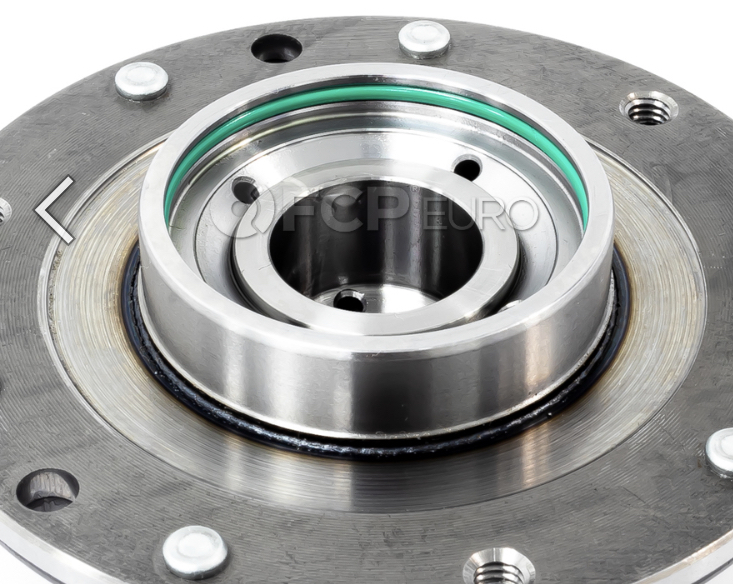

Look at the inside face of the sprocket for oil/residue (opposite side of the yellow hub). As in, the opposite side of where the cogs are, inside the wheel. You may need a small mirror or inspection camera. If there is no evidence of oil leaking I would leave it alone. Jimmy57’s CVVT cutaway thread talks about the max allowable amount of axial play.
I replaced both VVT hubs on one of our P2’s at about 280k miles. Axial play, if I recall correctly, was around .67mm and both had begun to leak. Mine looked much like the play you show in your video.
There is an o-ring inside the VVT (opposite the T-55 plug) that is replaceable, used to be tricky to source. I sourced some well before FCP carried them, but they were incorrectly sized so I ultimately ended up replacing both VVT’s.

Thank you. Ill try to find that O-ring here in Europe first and see if it last for a little longer. Also with the non-spring loaded hubs like mine, if I just put it back lining up the marks from the pully with the cam cover wil it be good to go?
