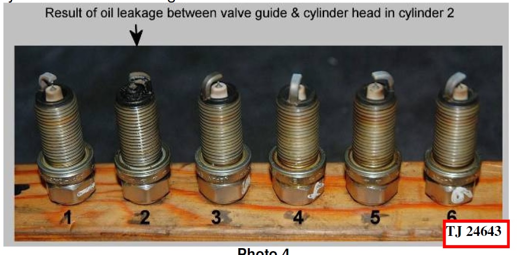

Post by pgill »
We need to see the sparkplugs
Upload a Picture of all the sparkplugs with the cylinder #
Good luck
Paul
Something like this
