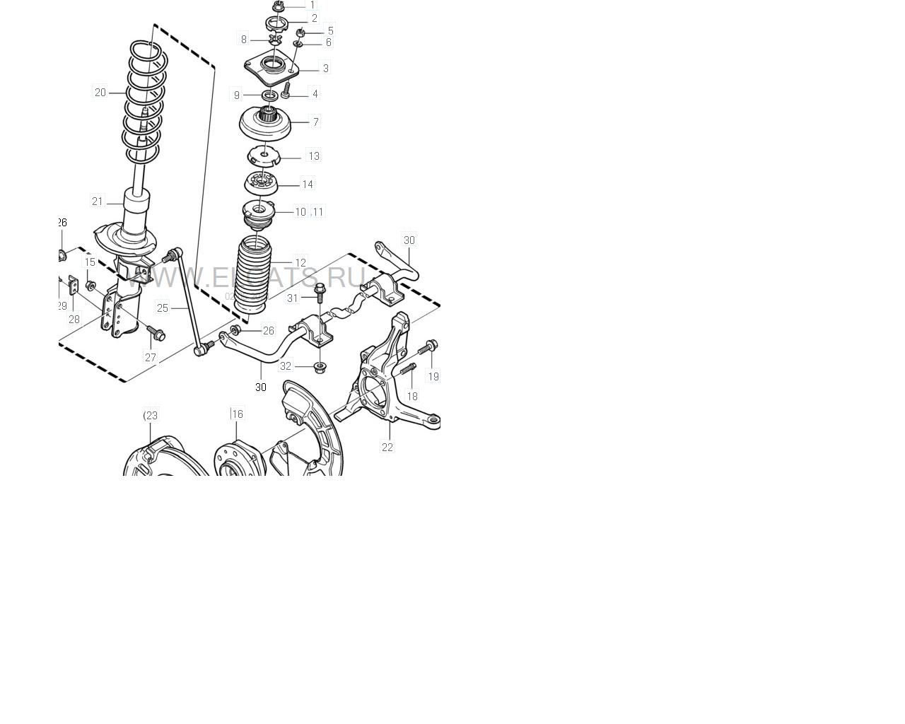

? N° 2 : Where does this part goes on, engine bay side, to the top of the "Suspension strut Support Bearing Front axle upper" ?

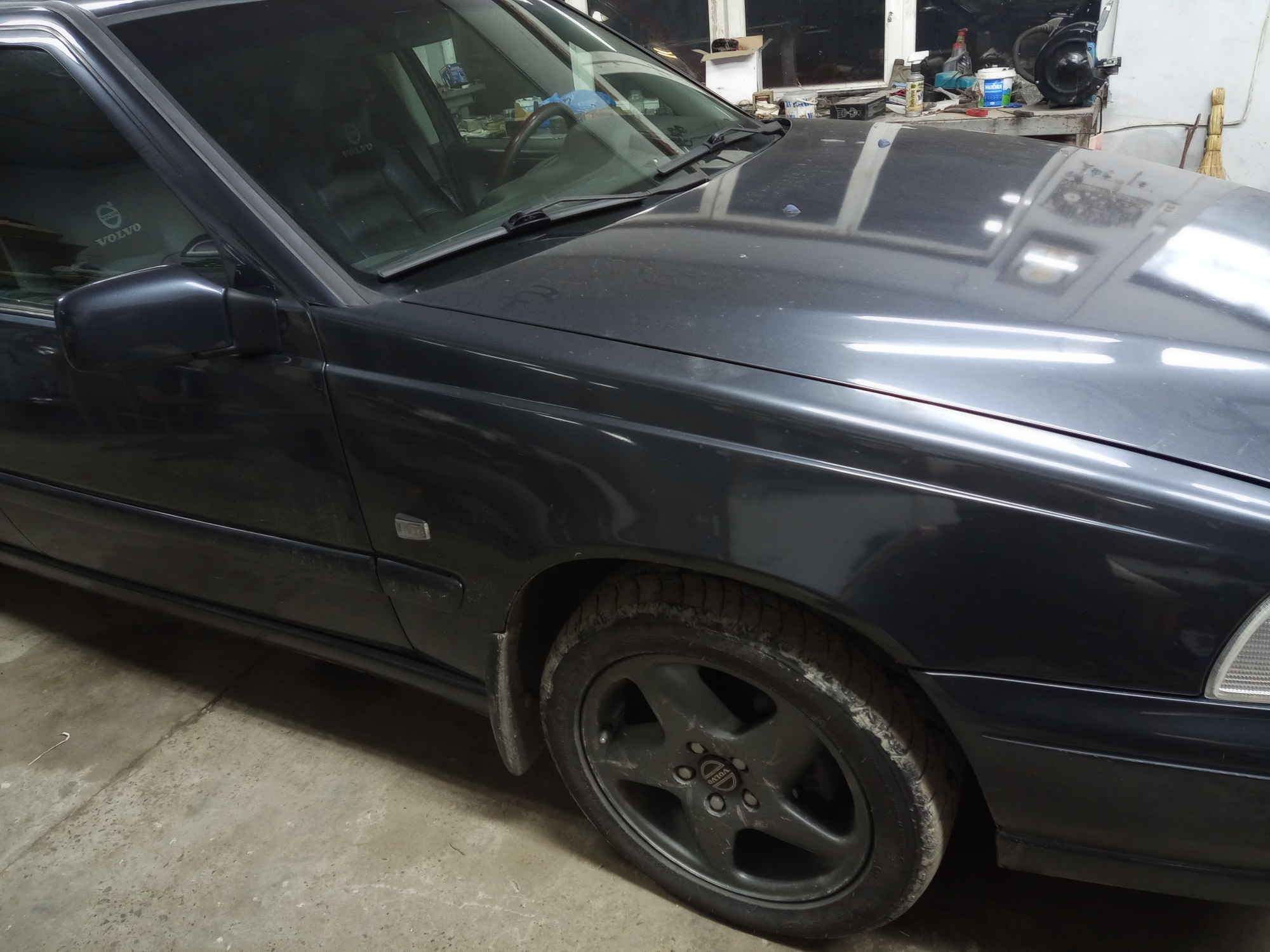

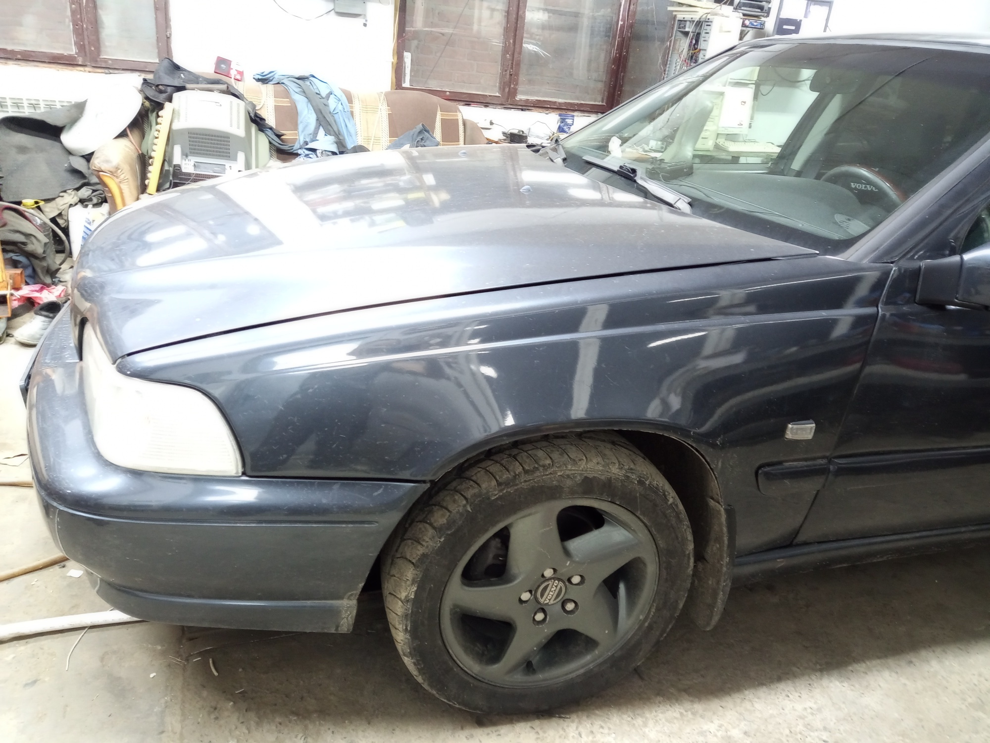

I needed to raise front of my car and I installed springs from diesel (used). Here's result:
Picture for question 2, see pos.13

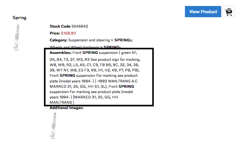

I have a question guys, i don't understand what these boarded references are for. Which springs shall i order ?
Here is the whole list, board © VOLVO - VPWS
https://www.volvopartswebstore.com/prod ... evel=24662
Manov
850 VPWS ref.png (85.16 KiB) Viewed 1206 times

manovlov wrote: The issue with these diesel springs models is that they are too strong, to me, impression the wheels dance on the top of the suspension.
I was afraid these diesel springs will be too hard, but they are not! Much softer than stock lowered T5 springs.

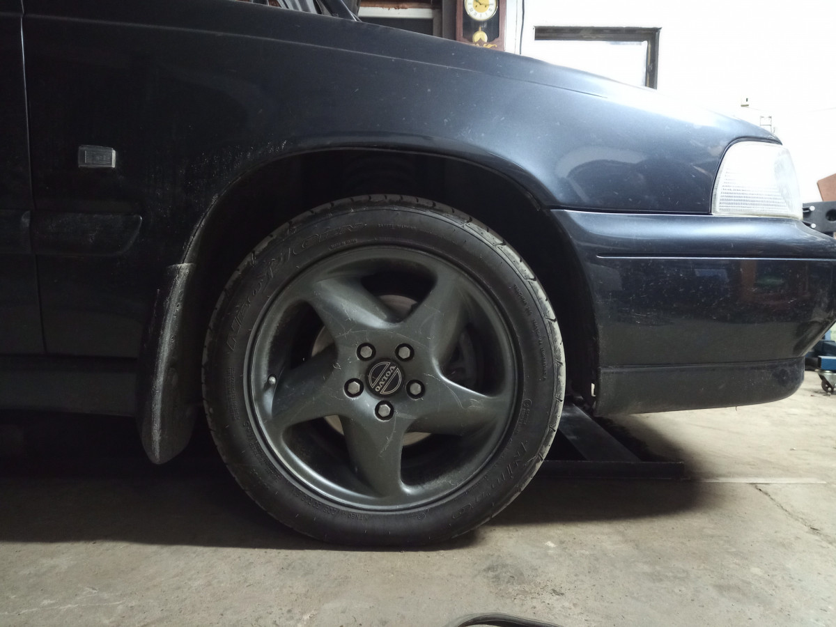

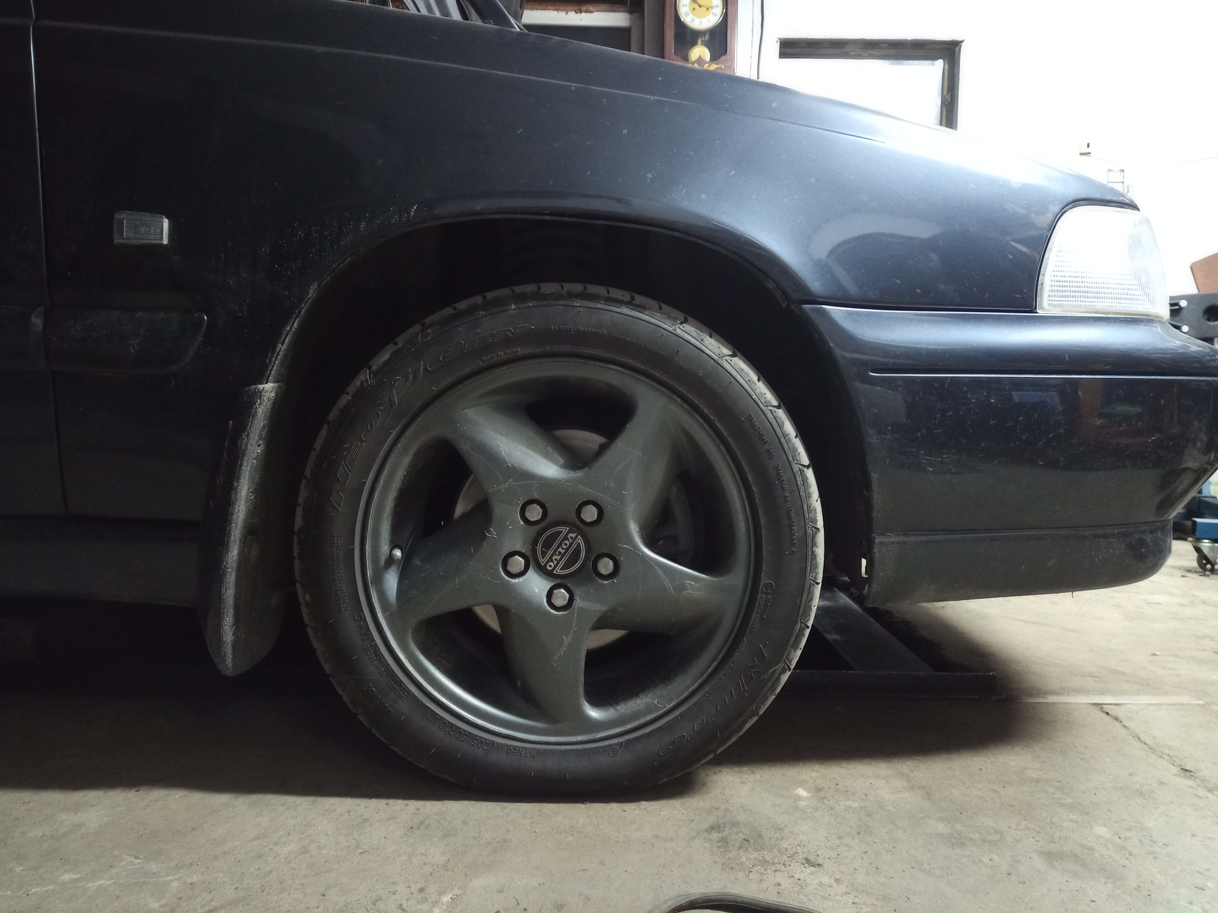

Post by Azik09 »
abscate wrote: Those are the nice chiral Columba wheels! ( there are left and right hand versions)
Thank you. And yes, I have 2 pairs:
Sorry for mess in my garage and mud on my car :oops:
