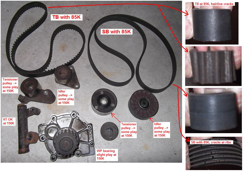

My 1998 S70 with 150K had the TB and SB replaced at 65K (in 2004).
At 150K, these are my observations:
- The TB (Timing Belt) with 85K on it is still OK, has hairline cracks, but time to replace.
- The TB factory Idler and Tensioner Pulleys have slight play and were “free-wheeling”, so time to replace
- The WP has no leak, but the bearing has a very very slight play. Technically speaking, you can keep the WP for another 30K. From reading Ozark Lee’s and few others experience with leaking WP at 150K or so, and since I have no time to redo this in 30K, I put in a new Aisin WP.
- Front Cam Seals have slight leak, no big leak, but since I am there, I may as well replace the Cam seals. It was quite an experience but no worry, I will show you the easy way. Read on…

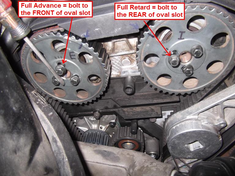

- Since you will be removing the Cam Sprocket, make sure you read forum on the issue of Cam Sprocket Timing Advance vs Retard adjustment. Do not assume that your sprockets were correct (never know the P.O. adjusted the setting). However, if your cam sprockets are stock and have never been adjusted before, you can mark them for ease of re-installation. I adjusted my Exhaust to +3 degrees (Advanced) and Intake to -1 degrees (Retarded).
- The SB (Serpentine Belt) with 85K on it is still OK, has hairline cracks, but time to replace. I keep the old SB in the trunk as spare just in case.
- The SB factory Idler and Tensioner Pulleys have slight play and were “free-wheeling”, the grease dried out, and were somewhat noisy during operation, so time to replace them.
- The Alternator Front Pulley spins with little resistance, so the Front Bearing is probably somewhat worn, but I will do an Alternator overhaul later, maybe at 180K or so. For now, the Alternator is OK.

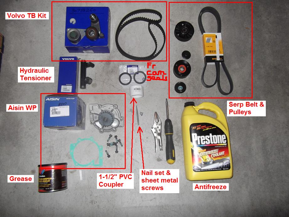

PARTS For 1998 S70 GLT
- TB Kit from Volvo (TB, Idler Pulley, Tensioner, Plastic Collar)….PN 30758260…$110.
This is cheaper than buying individual parts!
- WP (Aisin) from eeuroparts.com….…$80.
Optional: new WP bolts; also new thermostat is a good idea at this mileage.
- Front Cam Seals x2…Volvo PN 6842272…$16…you need 2.
(Alternate is SKF 17806…Napa auto parts $15.)
- Serpentine Belt: Conti 6PK1743 (Autohausaz.com)…$21
- Serpentine Belt Idler Pulley (PN 9146139…$39) and Tensioner Pulley (PN 272136…$29).
Volvo OEM.

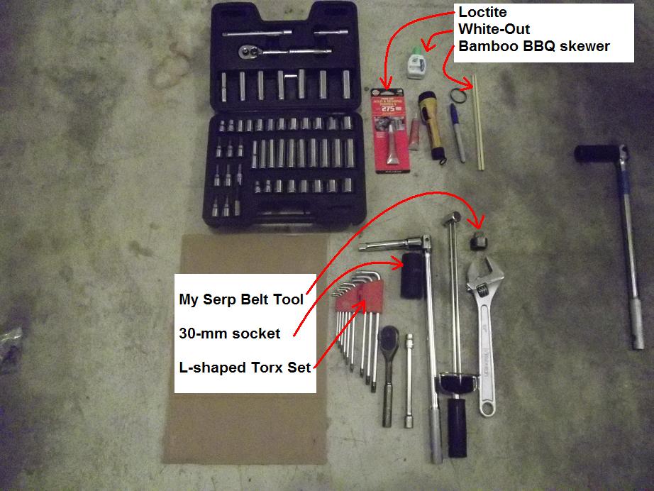

TOOLS

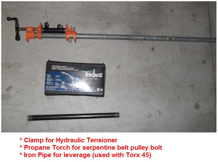

- Metric Wrenches/Sockets as usual. Make sure you have the 30-mm socket & 1/2" breaker bar for the Crank Bolt.
- L-shaped Torx Wrench Set ($12 at Advance Auto Parts, Autozone). This is a must if you replace the Tensioner Pulley!
- For SB tensioner, I use the home plumbing plug (the 1” type) with square end being 3/4", then file opposing ends flat for the adjustable wrench.
- Two-foot section of Iron Pipe ($8 at Home Depot hardware store), read on.
- Propane Torch to help remove the SB Tensioner Pulley from the Mounting Bracket.

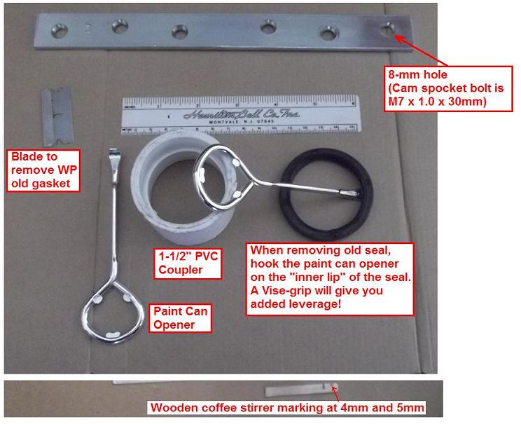

* Some sheet metal screws for removal of old seal

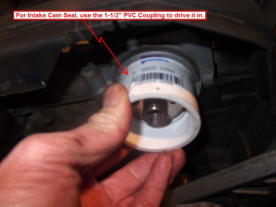

* Paint Can Openers x2 (free at Home Depot hardware store) are a perfect fit. You can use pick tool too, but the paint can opener is the winner!
* 1.5-inch PVC Coupler (90 cents at Home Depot). For those who do plumbing, this coupler is used to join 2 PVC pipes with I.D. = 1.5” together for home drainage plumbing. I brought the new Cam Seal to Home Depot and this PVC Coupler O.D. matches the O.D. of the Cam Seal, so it is a perfect tool to press in the new Cam Seal!
* Steel “Mend Plate” with holes about 8-mm to press in new cam seal, about $2-$3 at local hardware store.

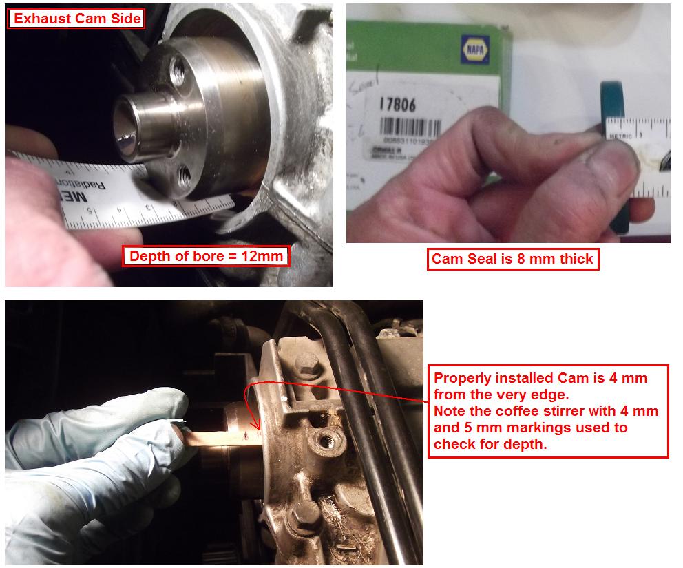

* Coffee stirrer or some short ruler to measure depth of cam seal install.
- C-Clamp large enough (6”) to compress the Hydraulic Tensioner. I use a wood-working clamp that I have laying around in my garage.
- Wheel bearing grease
- Loctite: virtually very nuts/bolts in this job require Loctite.
- Utility knife blade/fine sand paper to remove old WP gasket.
- White-out paint (Liquid Paper), Sharpie, bamboo skewer (to mark crank).
- A make-up mirror ($5 at Walmart) is a must!

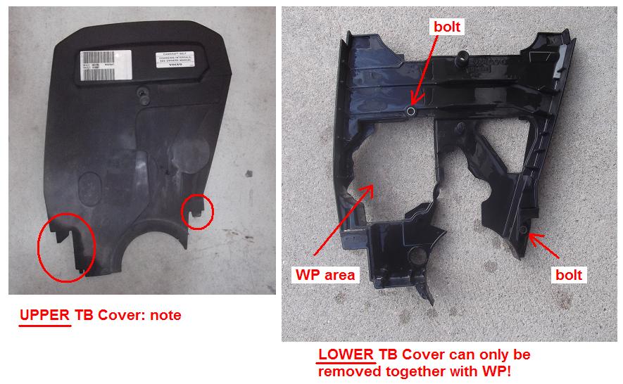

6. Undo the 12-mm bolt holding the UPPER TB Cover. Note the slots at the bottom of the cover for re-installation.
NOTE: The LOWER TB Cover (held by 2 bolts) can only be removed together with the WP.

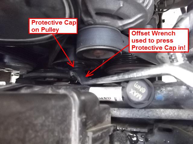

7. With my “Special SB Tensioner Tool” + adjustable wrench, pull toward the Front to release tension.
Then remove SB. NOTE: make a diagram of the SB routing for ease of install.

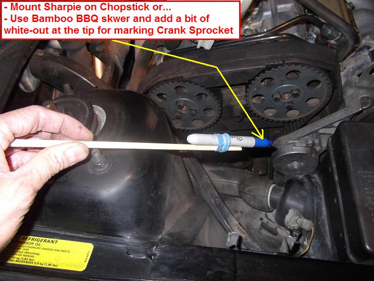

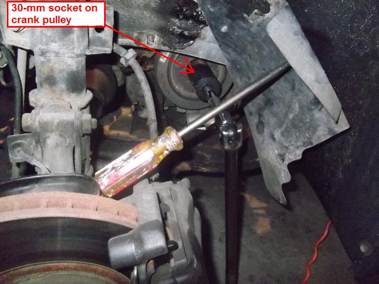

8. Turn the 30-mm crank (easier with spark plugs out but you don’t have to remove spark plugs. It is stiffer with spark plugs in place, good work out if you have not done any exercise this week LOL) to line up the CRANK mark with mark on Oil Pump Housing.

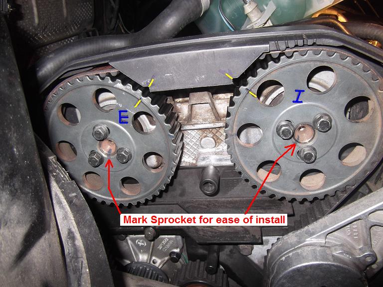

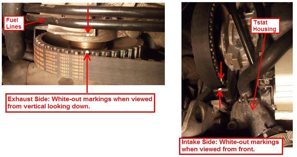

9. Make sure the CAM Sprockets line up with the notches on the UPPER TB Cover. Bend down and look straight at them (as if you look from the coolant reservoir viewpoint) to get a good view. Now mark with Sharpie/white-out for ease of identification. Also mark “E” and “I”.
10. Tip: you will find that if you periodically check the Cam to be sure it has moved, getting the UPPER TB Cover in and out is a pain (lifting up fuel lines etc.). Here is a tip: for Exhaust Cam, mark with white-out at 12 o’clock position (looking straight down on the back side of the Cam Sprocket) and the engine as shown. For the Intake Cam, mark at the very front as shown. This way at a glance, you know where the Cam Sprockets are. Of course at completion of the job, you need to verify the Cam Sprockets using the UPPER TB Cover as a guide. But this little trick (markings at the back of the Cam Sprockets) will save you a lot of time.

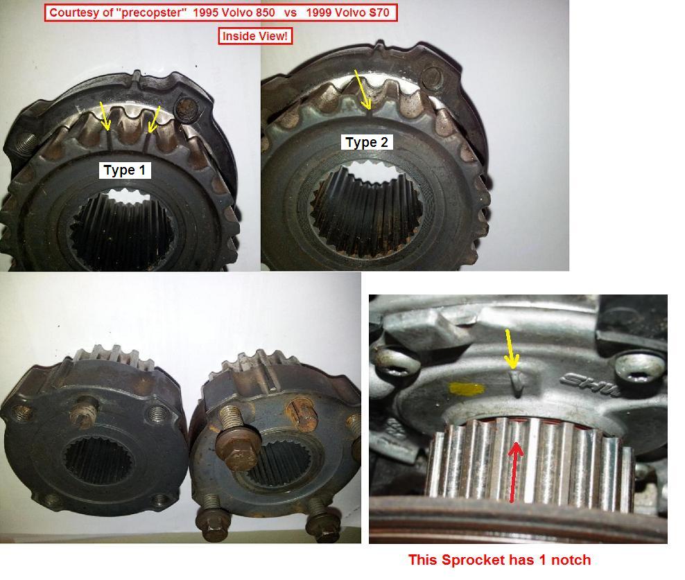

11. Note that there are 2 types of Crank markings: either single notch at the valley vs 2 notches on the teeth (this is what I have). See photo (courtesy of “precopster”).
12. Now get a good flash light and shine at the CRANK sprocket. Initially I used Sharpie but later I found white-out paint to be better. Just apply a dab of white-out at the tip of the bamboo BBQ skewer and mark the valley. Again, verify that you apply the white paint on the correct valley. The 2 notches are very fine and difficult to see w/o flash light. Good lighting is critical here!
13. Note:
- Yellow is Oil Pump marking,
- Red is the 2 notches,
- White-out paint is on the valley:

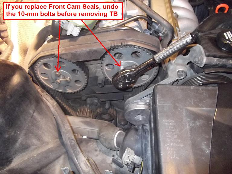

15. Since I am replacing the Front Cam Seals:
- Mark Cam Sprocket w.r.t. Cam Shaft relationship. Again, read my tips above, do not assume this is factory setting as the P.O. might have adjusted it before. Undo the Cam Sprocket bolts with the TB in place.
- However, if the TB is already out, no worry, hold the sprocket with left hand while Right hand undoing the bolts.
16. Again, read the links in REFERENCE section below on Cam Advance vs Retard. The bottom line is:
- Advance: bolt all the way to the front of the oval slot.
- Retard: bolt all the way to the rear of the oval slot.

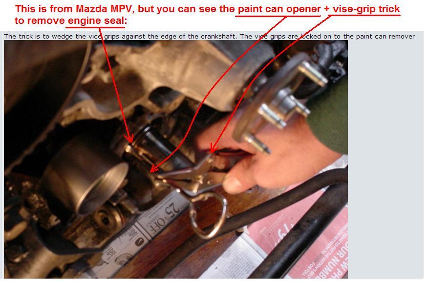

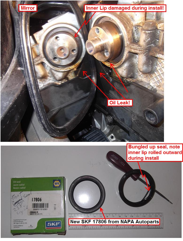

17. There are many ways to remove the cam seal.
WARNING: Whatever you do, do not mar the sealing surfaces of the cam and the bore!!! You will regret big time.
a. The sheet metal screw method: punch a small hole at dead center of the seal, screw in the sheet metal screw making sure it goes in straight, then pull the seal out. NOTE: You will need to use some force to pull the seal. Now don’t laugh but I pulled so hard I fell backward on the garage floor LOL.
b. The smarter way is to use paint can opener + vise-grips. Sorry no Volvo picture, this is from a Mazda MPV but you get the idea: hook the paint can opener under the seal’s inner lip, then use the vise-grips as shown to pry it out.
18. Clean the sealing surface with a Q-tips. Apply oil or grease on the new seal. Just look at the seal to see how it goes in. You need oil/grease on the OUTER edge and INNER Lip of the seal. Now use the 1.5” PVC Coupler (note that is has ridged on one end, so use the smooth end of the coupler) and gently/evenly hammer it is. However, there is an easier way, read on.
19. The Intake Seal was no event. I learned the Exhaust Cam Seal the hard way! If anyone tells you the Exhaust Cam Seal is easy, it is not! But if you follow the tricks below, it will be a breeze.
I installed the Exhaust Cam Seal wrong (the back end was bungled up for not using the mirror and for not spinning the seal during install) and there was oil leak on the driveway for a week! It took a long time to diagnose the oil leak by looking via the Cam Sprocket holes with “dentist mirror”!
It was Saturday, Volvo dealer wanted $35 for the seal: no way! I went to local NAPA and picked up Cam Seal made by SKF 17806 for $15: Perfect fit! FIY, you can look up any SKF parts here:
http://www.showmetheparts.com/skf/

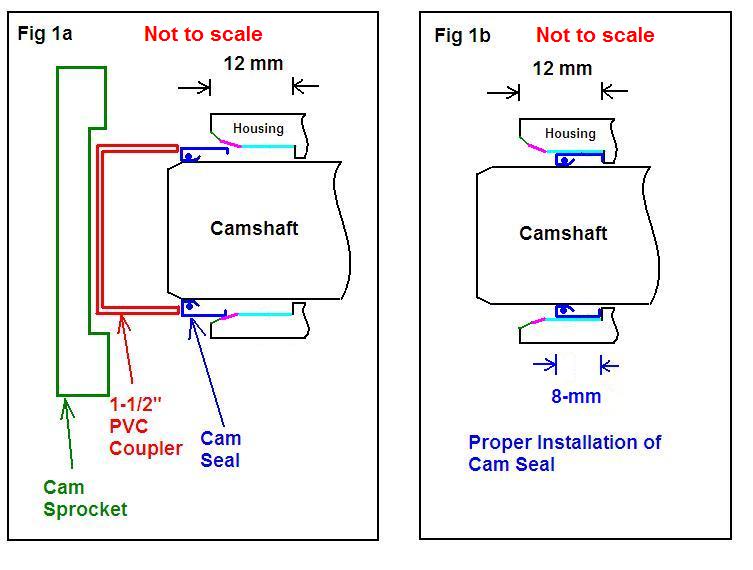

20. Now the next photo is crucial, note the seal has to travel some 12 mm to be fully seated. The Cam Seal itself is about 8 mm thick. So once done, the seal should be about 4 mm from the very edge. Again, the space is very tight here for Exhaust Cam Seal, so make a short ruler (I use a wooden coffee stirrer with 4-mm and 5-mm markings) to ensure proper install. A mirror is a must here!
21. After much frustration installing the Exhaust cam Seal, I found the trick! “a” is OK, but “b” is better:
a. Again, make sure the seal is well oiled, spin it as you insert it until it stops at the edge to prevent bungling up the inner lip. You can tap it in with a small hammer, but you will find out that there is simply no room (b/c of the suspension tower).
- Now use Left hand to squeeze the bottom, while the Channel-Lock Pliers squeezing the top of the seal. NOTE: that I used the old seal as cushion between the new seal and Channel-Lock Pliers.
- At this stage, it does not matter what I squeeze, it will not go in further. If you have the Volvo Special Tool for Cam Seal, then you are in good shape, but no worry, read on to the ghetto technique.
b. I just happen to have a steel mend plate with holes being 8-mm, perfect because the sprocket bolt is 7-mm. Use the steel mend plate + PVC coupler as shown and the seal goes in smoothly! Make sure you change the bolt holes to even it out (3 holes). It will be stiff going in, but do NOT force too much as you may damage the seal’s metal cup. Periodically check the seal depth, if it is 4 mm from the edge, you are good.
ALTERNATE TECHNIQUE: Use the Cam Sprocket + Coupler to press the new seal in. If you do this:
- You need longer M7 bolts (the factory bolt is not longer enough once you fit the PVC coupler behind the Cam Sprocket), you can get longer M7 bolts at hardware store.
- Or…Reduce the PVC Coupler thickness by cutting the PVC coupler with a hand saw so it is roughly half of the original thickness. You will have to measure how much to cut. Whatever you do, the new seal needs to travel 12-mm or so.
22. Once done, verify with mirror and short ruler (my coffee stirrer) to be sure the Cam Seal is seated evenly and properly. You have one shot at this whole seal business!
- You can re-install the Cam Sprockets now or later. Again, read the Advance vs Retard issue.

24. WP is easy: look at new WP for bolt locations. There are seven (7) 10-mm bolts.
- Note that the LOWER TB Cover (held by 2 bolts) can only be removed together with the WP.

33. A quick note on the SB Tensioner Pulley: I almost stripped the Torx bolt, so:
- Use the correct Torx #40 key.
- Use the propane torch to heat the back side of the bracket (where the Torx bolt goes in), 30 sec. of heat is enough to loosen the factory Loctite.

did my seals the other night and I might add this
After careful measuring I cut the pvc to 1 1/4 inch, the cut side I made the sprocket side and used my dremel to grind away some of the inside so it slipped over the cam sprocket hub better, looser
for the side that was going to go against the new seal i put several marks with a sharpie at 4mm
but I also used the "coffee stick" to double check
for the first "push" the stock cam bolts were not long enough so I got some that were about 1/4 inch longer. after driving about half way in I switched back to the stock ones
one of the seals was a bear to get out, so I borrowed a seal puller from a friend, it was so slick, I ordered one for other future seals on other cars. Lisle Cam and Crank Shaft Seal Puller Model LS58430
all of the extra marks on the camsprockets were well worth it, as for me, both cams moved, but wiht all the reference marks, including the inside marks, all was good
thanks again for the excellent writeup and links

Somehow I forgot to add the step on "Protective Cap" for serpentine belt pulley.
It is very difficult to press the Protective Cap back on by hand.
The trick is an Offset Wrench and you are done in 1 minute:
