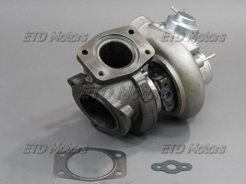

Is this the plug . I found this on a rebuilders site

Just for clarity - your tubo has 4 holes or 5 holes for oil and coolant?

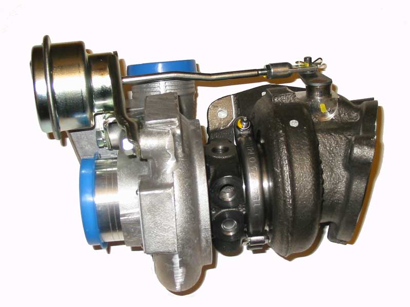

I found it - its a freeze plug
Is that it? I bet you were right about the cold weather

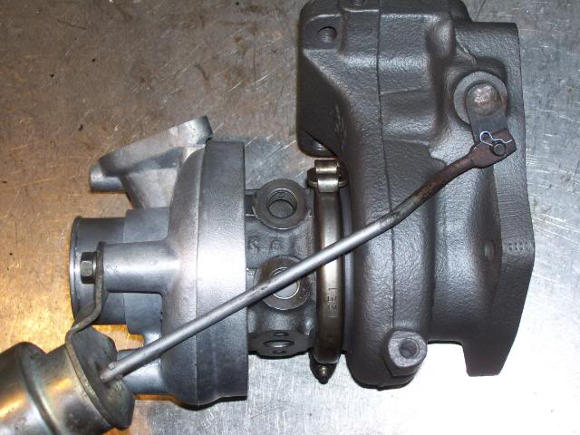

and another

This is exactly how my turbo looks like, and thats where the water is coming from...On the 2 others pictures, it doesn't look like the turbocharger fitted on my car.
I marked on the following diagram where this supposed freeze plug hole is related to the coolant system.
Any idea about closing that hole? Is there a thread in it? From what I could see and feel I think yes, but what kind of thread is that?

Here is another picture of the turbo but this one is set up for a Volvo

The picture is good, its just a mirror view.

It's ok that they look different as the turbo has been used on many many cars. The center section is the same but the wheels and housings differ.
