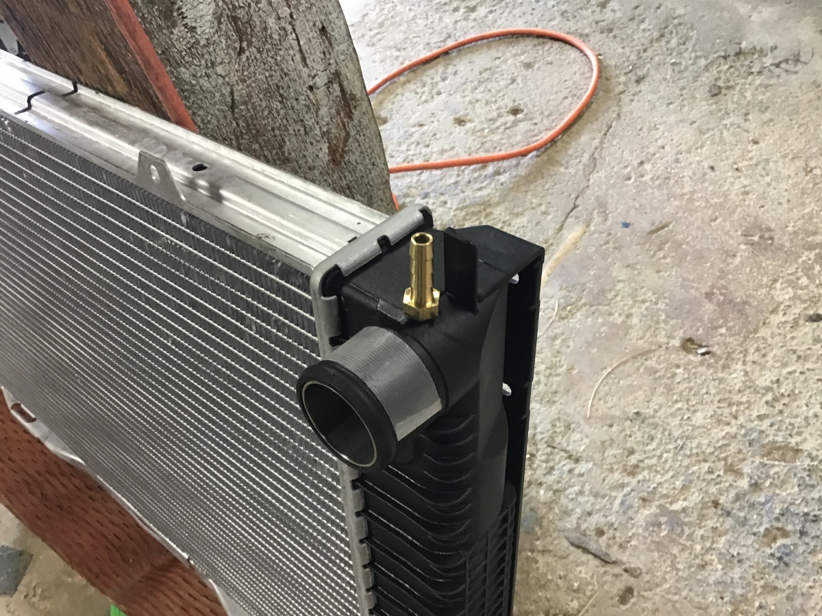

have new V. radiator, coolant reservoir.
One new volvo radiator arrived with the flimsy small nipple snapped off so they shipped a new one.

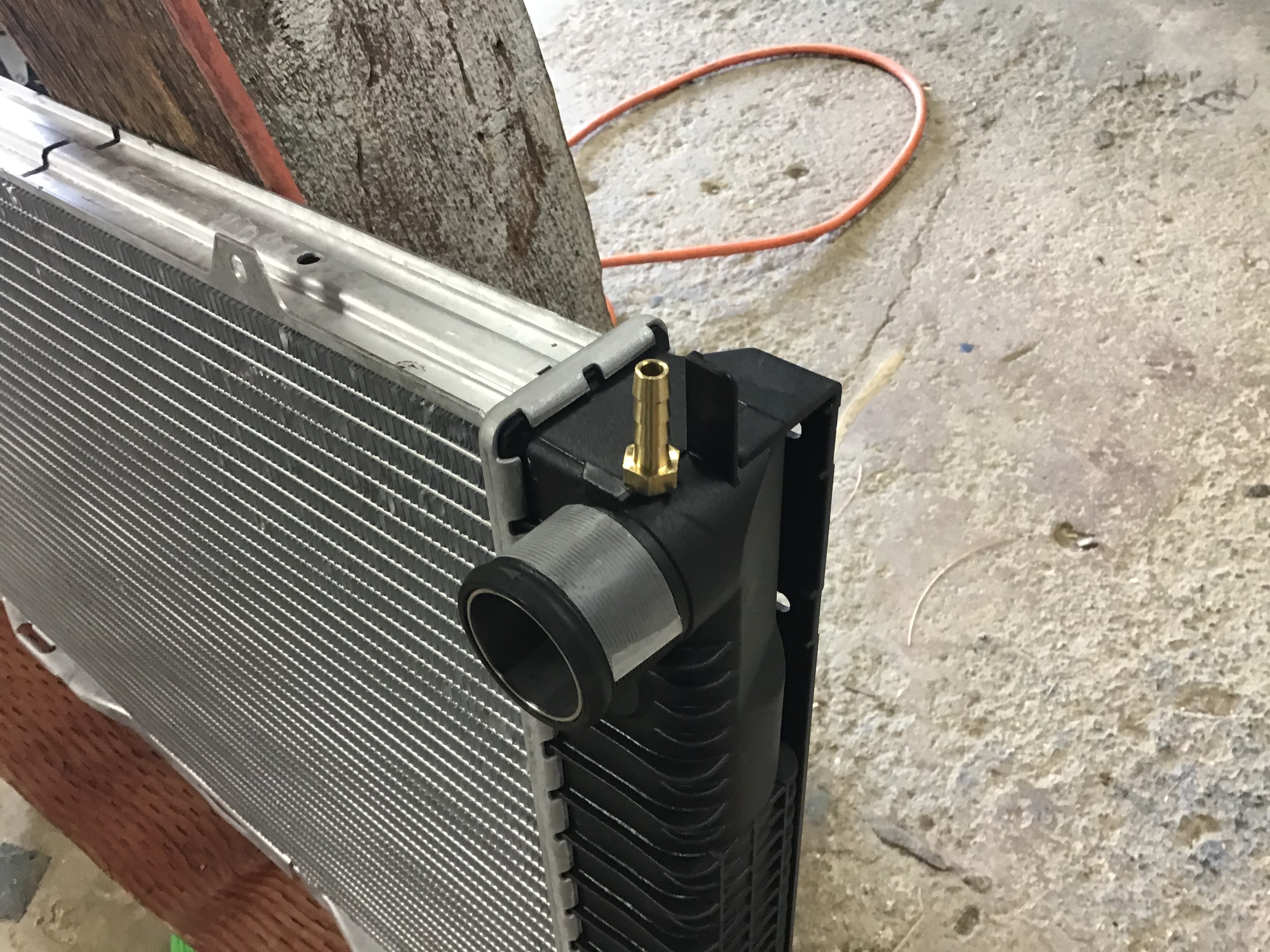

why did it load the pic four times?
that is the repair for future use as spare NEW radiator. I plan to embed the brass nipple in JB weld regular which adheres to plastic real good.
