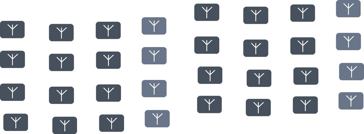

For those who want a diy antenna label to complement the look, here's a template. I just dab a full drop of superglue to fill the entire square and press it against a clear plastic sheet (from discarded product moulds or photocopying sheet). Once it dries, I then cut and paste another on the opposite side. Replace it with the fog light label. It's not great with the light on in the dark but it does show up.
