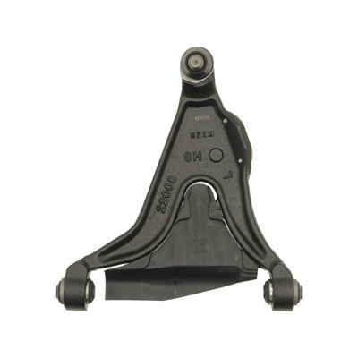

Look at front of lower control arms, your contact pads may have broken and fallen off. You will notice it by seeing a pair of rivets with the spot between marred by the spindle contact bar wearing the control where pad should be. Harmless but noisy.

That part of the control arm where there should be a plastic rub point is the little bulge just below the ball joint on the right in the picture. A little grease will usually take care of a noise you'd get when turned all the way left or right.
- Control arm, lower.jpg (12.51 KiB) Viewed 2243 times

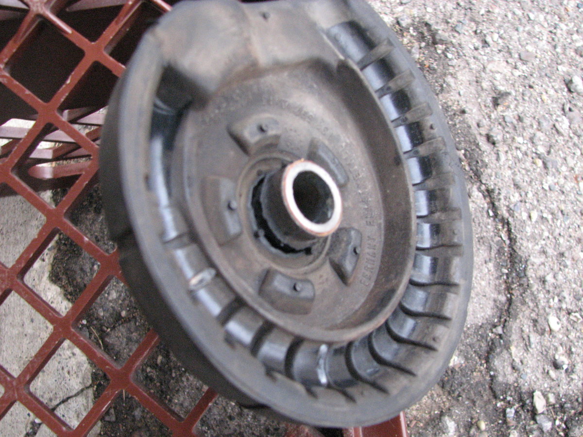

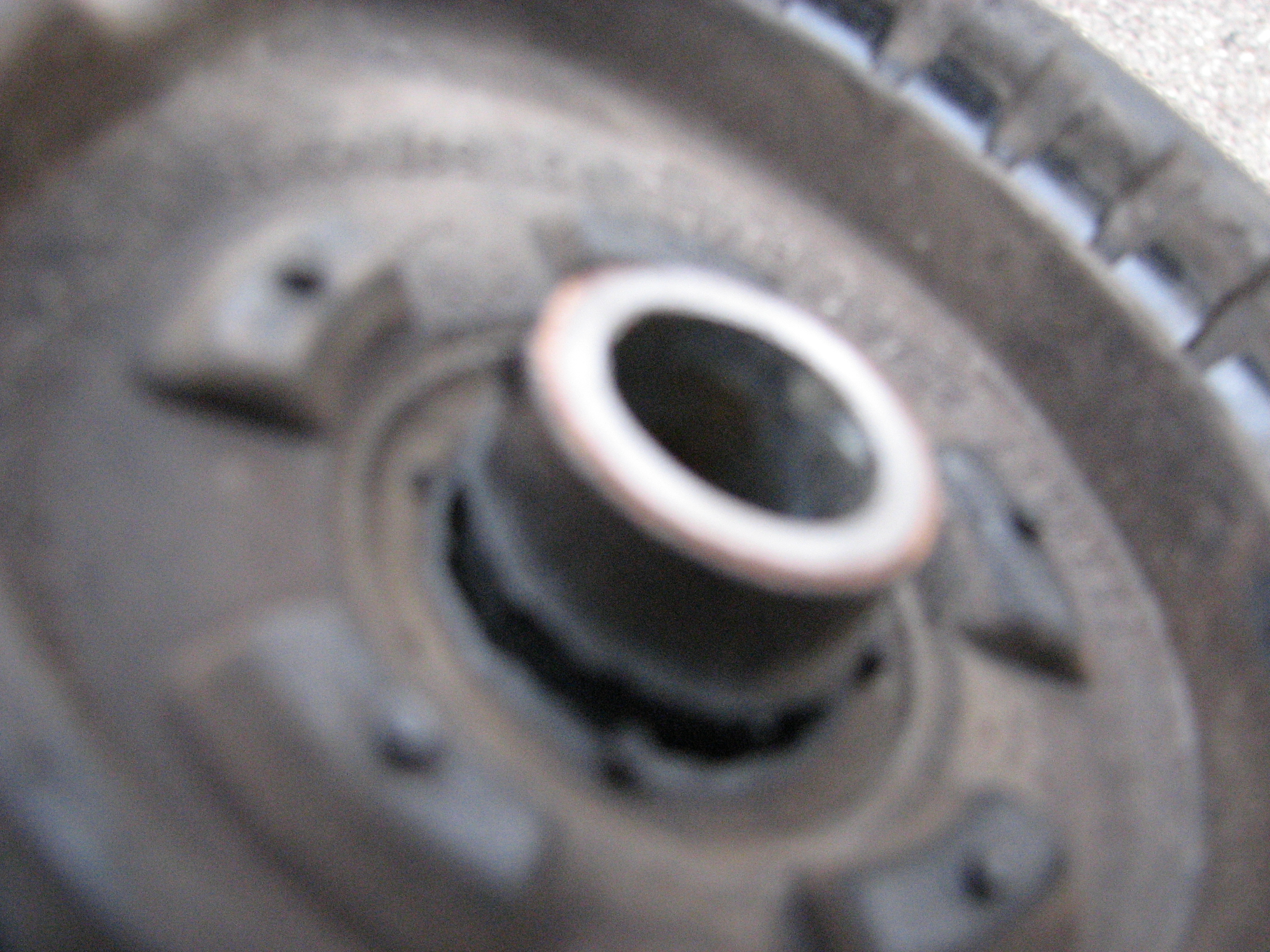

Just another noise making option to consider, the spring seats made a creaking sort of noise on mine when they were bad.
The steel sleve was staying in place while the seat was turning around it. Not so much a "groaning", but a creaking.

Creaking is probable a better word to describe the noise. The noise will happen even when sitting still and i just crank the wheel all the way to the left.

Yeah, that sounds like a spring seat, or both.
