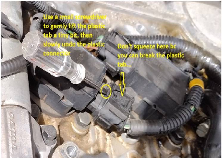

I want to add a small tip (already mentioned above).
Some may want to squeeze the tab bc it is quicker, don't, bc you can break the tab.
Just find a small screwdriver and very very very gently lift the tab up as show.
Remember these cars are some ~ 20 years old, plastic breaks all the time lol...
PS: Worst-case scenario you break the tab, it will likely hold by friction (the orange seal).
Or you can design some zip tie etc.
