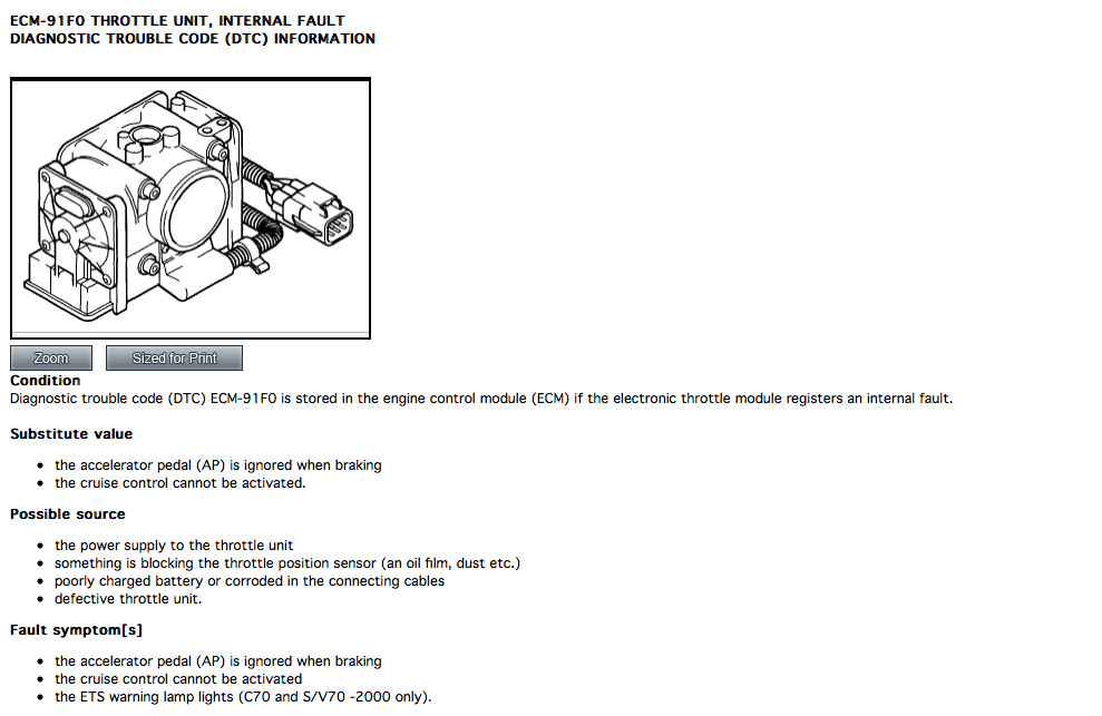

That P1053 corresponds to Volvo ECM 91F0 which is....
P1053 ECM 91F0
P1053 ECM 91F0
Screen Shot 2016-07-12 at 5.18.36 PM.png (123.94 KiB) Viewed 4372 times

Oh. My cruise control doesn't work, but it doesn't really bother be. Is a new ETM the only way to get rid of this code? I'd rather just leave it alone if possible as I paid very little for the car. My only concern now is passing inspection, due to the fact that this code doesn't go away. In my state, emissions is only tested by the inspection station checking the OBD for readiness. Would this code affect my passing inspection due to the fact that it's in the system but it's not emmisions related and it doesn't make the check engine light go off?

You have to check your state regs. In NY CEL on is instant failure
By " check engine light go off" do you mean turn it on?
