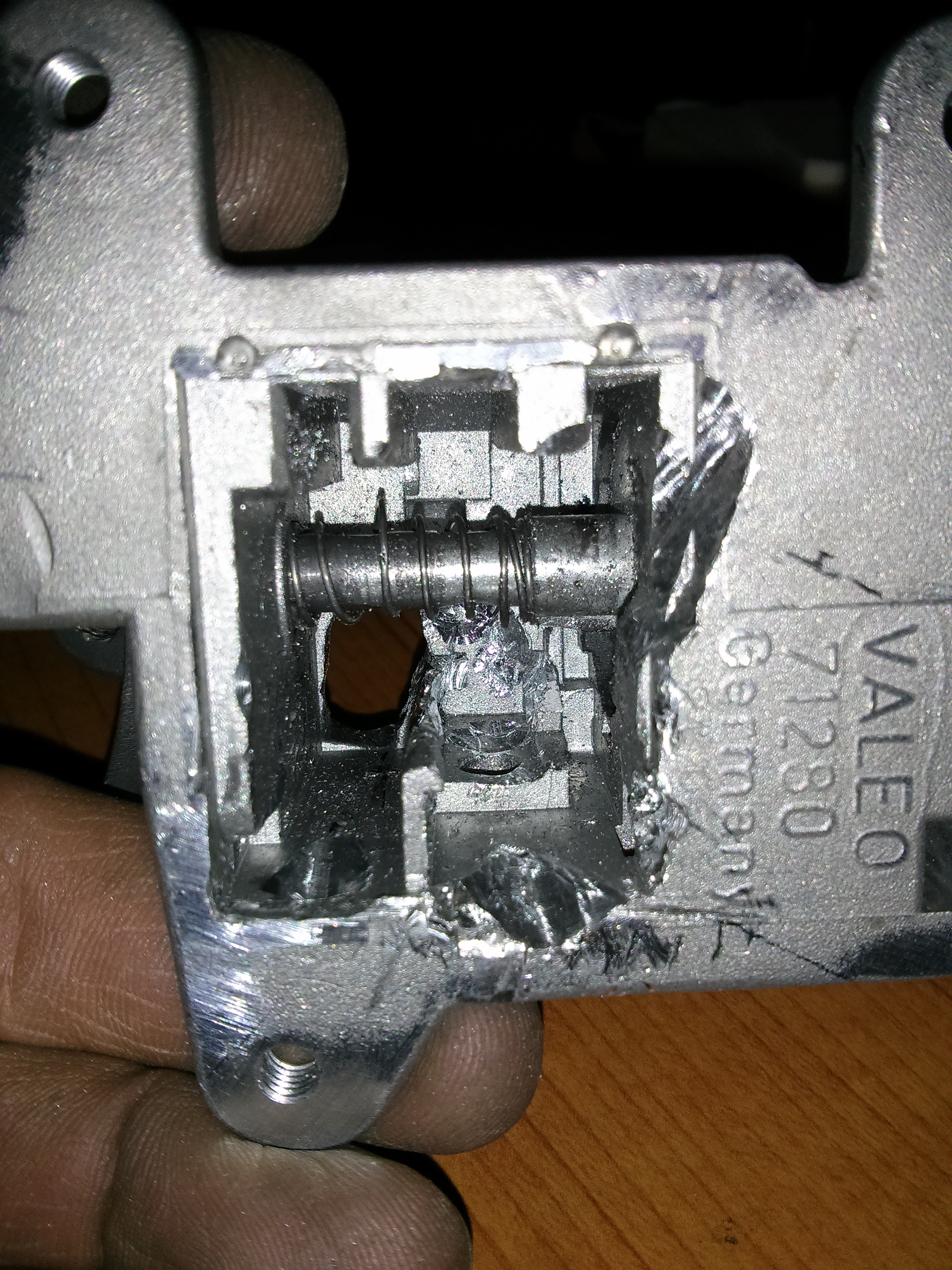

I took it a step further and crudely, (what I had on hand) drilled out the SW locking mechanism altogether.OldSkoolMadSkilz wrote:I just removed my switch. If I'm not mistaken, if you remove that bottom plate, get rid of the conical spring, and fiddle with the wheel lock so that it drops down, it will not break again. The wheel lock won't engage anymore, but I don't see that as a major issue.
For anyone who has not yet started, it may be possible to fix this by drilling a hole in the bottom plate and yanking out the spring without even removing the switch from the column.
We decided it wasn't worth 350+ to have the SW lock on our 2000 v70, given (a) it could break again at any time, and (b) our keys are chipped.
Good luck, and thanks to mom for the great tutorial and sacrificial dissection!

I like this last idea above of drilling out the guts of the locking collar and just not have a steering lock since my car is a 91 and not worth stealing. but if drilling out the guts, will that damage the rod that goes thru to the ignition switch? if not, this is the way I'm going.

Hi well tryed to fix my 02 xc 70 no key turn. First did plate
Removal part fell out. Key still wouldn't turn. So drilled out pin and spring next to cable. Got it out. Key still won't turn.
Drilled all guts out just left with shaft with spring over it.
Still won't turn. Any suggestions on a way I can fix. Thanks

You have 2 options:Nascarfan28 wrote:And Im still able to get it to turn completely once and a while.
Not sure what's getting caught up in there
1. NEW Tumbler, only buy from Volvo.
The problem with newer cars (such as 2000+ models), you will likely need the dealer to program the new key, which is a ripoff...? $200 or $300 or something like that.
2. COMPLETELY gut the device off the individual "tumblers" ---> the key will now free-wheel.
On this video below, you can see the individual tumblers at time 8:23:

Hi guys thanks for the help. So I took out tumbler. Saw stuck
Wafers as soon as I pulled it. So removed. File and cleaned tumbler. Most of the wafers were worn. I took best one. And
Put it back in something to hold key from falling out. Put it back in car that worked awesome. Still need key to turn. Then
Ran into prob would go outa park. So cleaned cable by shifter.
Found that if you spin plastic clip for shifter lock cable ,it
Will move clip farther to end of cable. Making it not engage
When you turn key. So don't spin cylinder when clip is inserted
Or make sure cable isn't pulled away from clip or it won't
Engage far enough. Thanks for the help guys. Learned a lot
