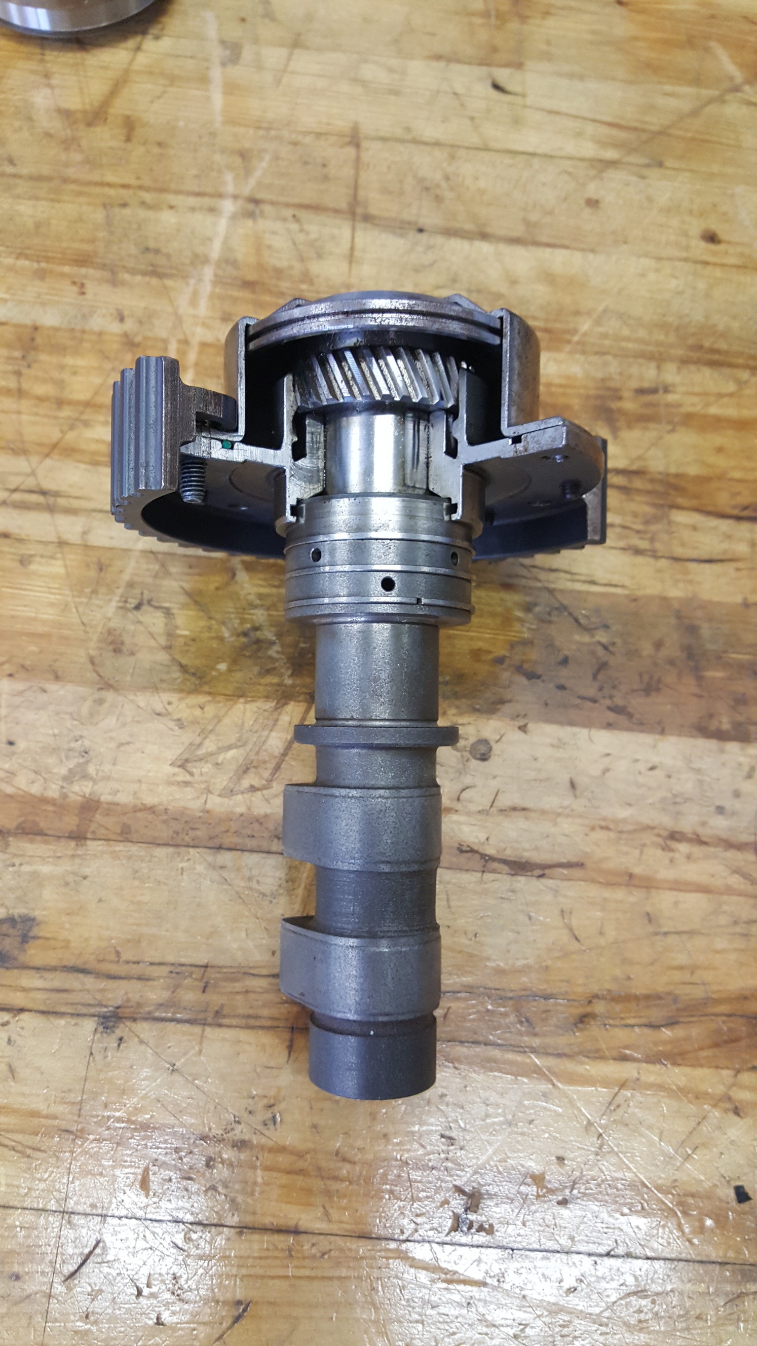

A couple of CVVT pics with the axial piston forward and backward. It is always nice to see car part guts.
The piston has its seal missing as there should be an O ring in the groove.
The groove inside where the CVVT is fitted over the camshaft should also have an O ring.
CVVT cutaways

Interesting, thanks for the pictures. What I'm still trying to understand is why the angled gear has two opposing gear teeth angles. It makes more sense if there was one consistent angle to the teeth.

It looks like the lower, driven gear (referencing the pictures) stays on one location on those teeth (you do wonder why it is even toothed, as Tony says) while the drive gear upper, slides and twists on the angled gear to give the required change in position of the cam as commanded by the ECU.

Wow, I'm struggling to get my head wrapped around this one.....
It appears that the inboard (lower in the pic) gear is fixed to the piston, and the outboard (upper in the pic) gear is fixed to the cam shaft. So increased oil pressure pushes the piston and inboard gear outward, which causes them to advance approx one tooth in relation to the timing gear. At the same time, the piston and inboard gear are running over the outboard gear causing the outboard gear and cam shaft to advance approx one tooth in relation to the piston. So the net effect is that the outboard gear and cam shaft advance approx two teeth in relation to the timing gear. That's quite a bit.
In order to achieve the same amount of cam advance with a single gear, the tooth angle would have to be twice as steep.
Is my thinking advanced or retarded?

Anchor the belt sprocket and twist the cam to demonstrate the mechanism in action. Back and fourth a couple times in 20 second video would be just awesome.

I can definitely see how seal swelling chemicals might interfere with the operation of these VVTs (motor oils that are known to be loaded with seal conditioning/swelling agents). That's a lot of sealing surface that needs to move: and not in a circular motion like a typical rotating shaft seal but slide laterally as a piston. Consider the oil pressure/VVT solenoids are PWM and the piston might start having trouble responding to minor incremental timing adjustments called by the ECU if those seals are swollen and tight.
Thank you a million times over for making that cutaway. Very useful from a general diagnostic standpoint to see what is inside of those hubs and how they work.

- Nice, thanks for the photos, beautiful!!!
- For cross-reference purposes, I posted some photos on the thread listed below on anatomy and operation of VVT (in a way this is similar to BMW Vanos system).

I had some CVVTs in a 2005 XC70 last week that had chronic leaking so I replaced them with used ones. The initial leaks were so bad I couldn't tell which CVVT was the culprit as you simply can't see back there and with the belt whizzing around sloshing more oil the whole area was covered, even after 3-4 minutes of running time after it had all been cleaned.
Upon replacement the new (used) ones leaked though not as badly and the issue was that I had set the cam seals to the same point as the factory had which is quite deep within the head. The used CVVTs had 2.5mm of play (old ones had 3mm+)
I reset the cam seals flush with the head and the area became bone dry so a steep learning curve is if you absolutely must fit used ones with some play you need to set the cam seal flush with the head.
From the pic I've attached you can see that leaking can be caused by one or more of 3 seals. Also if they're in tolerance of having less than 2mm of play you can rebuild them with new O rings if you can find the right quality and size of seal and use new cam seals set flush with the head.

According to jimmy57 the official axial play is 0.5mm but in practical terms they can have up to about 3mm of play before the cam seal can't reach the outer lip.
Radial play is hard to measure as they have the natural rotational tolerance to adjust cam timing.
