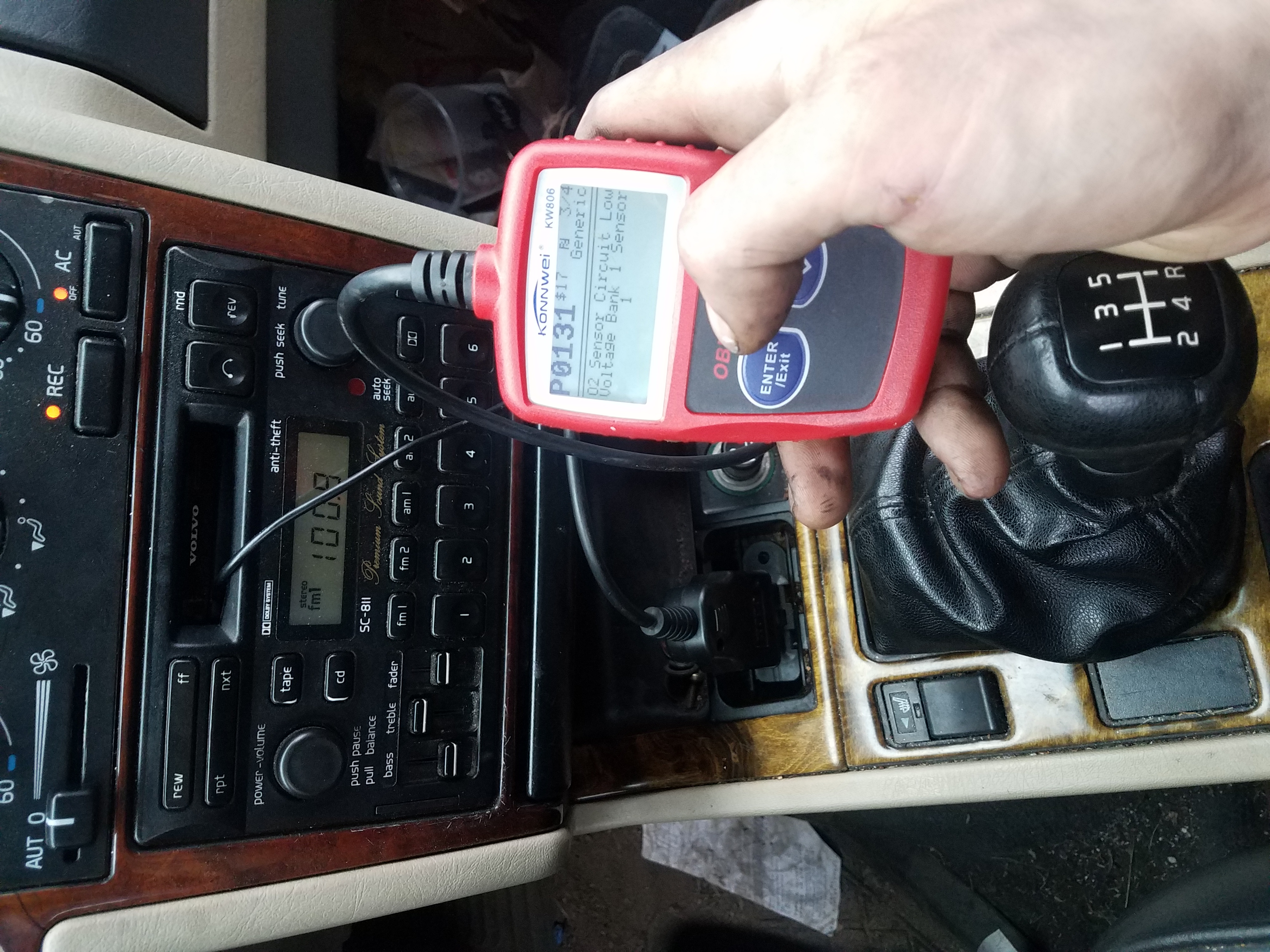

volvo 855T p0172 p0131, O2 sensor?

My car has been running very rich and acceleration is less than usual. If I do a computer reset the car runs great for a day then back to running rich and sluggish. The MAF is good or I have 3 bad MAFs lol, I've checked all vacuum hoses, and replaced the temp sensor. I'm going to buy a new Bosch O2 sensor tomorrow unless theres something else I should look for.

How are you coming up with P0172 and P0131 on a '94 855T?
'94 had the black box blink codes and the codes are in the format X-Y-Z.

Guess my 94' is weird, I have the blink box and the OBD II port. It is the late model 94'.RickHaleParker wrote: 03 Jul 2018, 00:37 How are you coming up with P0172 and P0131 on a '94 855T?

You might want to get a better scan tool. I suggest a Bluetooth ELM357 version 1.4 or higher and 850 OBD-II if you have an Android phone or tablet.
Did you smoke test the EVAP system? It easy to miss a leak just looking around.
Did you clear the codes and see what comes back?

The heater failure may well be tripping the OXS code, sortsupply, fuse, wiring, and connector before changing OXS

I have an ELM but no idea where it went....or who 'borrowed' itRickHaleParker wrote: 03 Jul 2018, 05:45 You might want to get a better scan tool. I suggest a Bluetooth ELM357 version 1.4 or higher and 850 OBD-II if you have an Android phone or tablet.

I have a bunch of ECUs laying around and put a different one in and the O2 code came up instantly, the fuel trim code diddn't come back but that one took a day to pop up.
