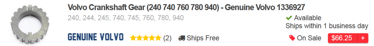

I've been reading these posts re: Crank pulley/crankshaft keyway & apparently there seems to be enormous confusion about this subject. What this guy is talking about is: There is a keyway machined on both the crank pulley as well as the end of the crankshaft. The purpose of these keyways is to prevent the pulley from sliding around the crankshaft end. There is a KEY that fits these 2 keyways. It's a very odd key & for the life of me, I CANNOT FIND A REPLACEMENT. There is NO Volvo dealer that has a pic of it in their parts books. Be advised, this has NOTHING to do with ANY of the pulleys, gears, belts, etc. that comprise the timing system of these models. It has ONLY to do with securing the crank pulley to the crankshaft. If ANYONE knows where I can buy this key, please post the data. Thanks. Ric

The B230 crankshaft keyway fits the crankshaft timing sprocket. The timing sprocket has a front tab that aligns with the rear of the crankshaft pulley.

hiflier wrote: 15 Jul 2018, 11:20...seems to be enormous confusion about this subject...CANNOT FIND A REPLACEMENT.
