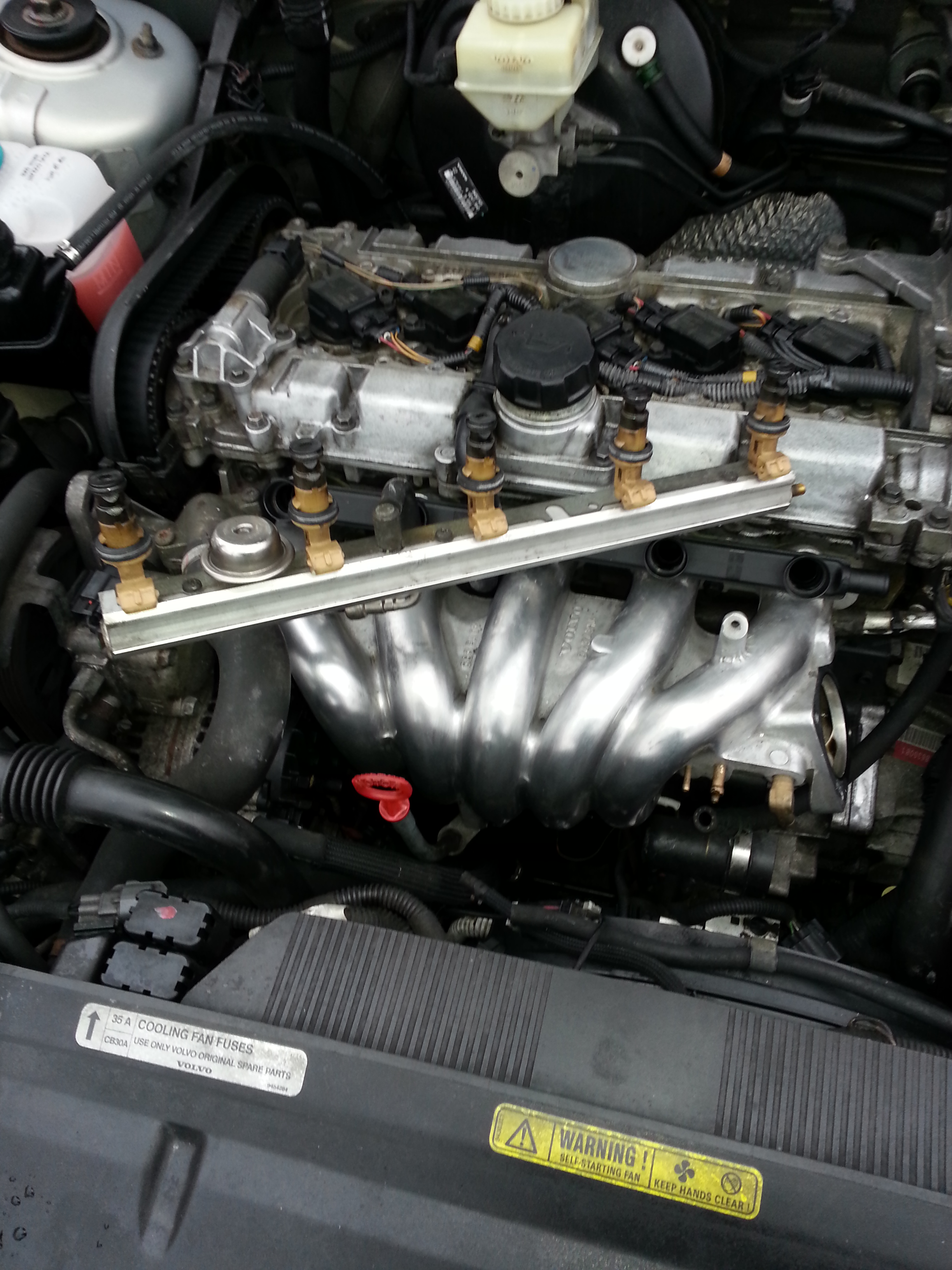

I have seen pictures of fuel pressure dampers that act to reduce small surges in fuel pressure at the fuel rail. However, when I just now checked my 2006 S60 fuel rail, there was no damper there. There is what appears to be a return fuel line from that location, instead.
This thread has a PDF showing the damper, and a noise from pulsation.
viewtopic.php?t=43206
However, Jimmy57 reports in the following thread that the damper was moved internal to the fuel rail for better effectiveness for 05-06 models and later:
viewtopic.php?t=63241
I have not heard of anyone needing to replace their fuel rail for this or other reasons.

Picture of damper (bell shape on fuel rail) - note - not on my 06 S60.
