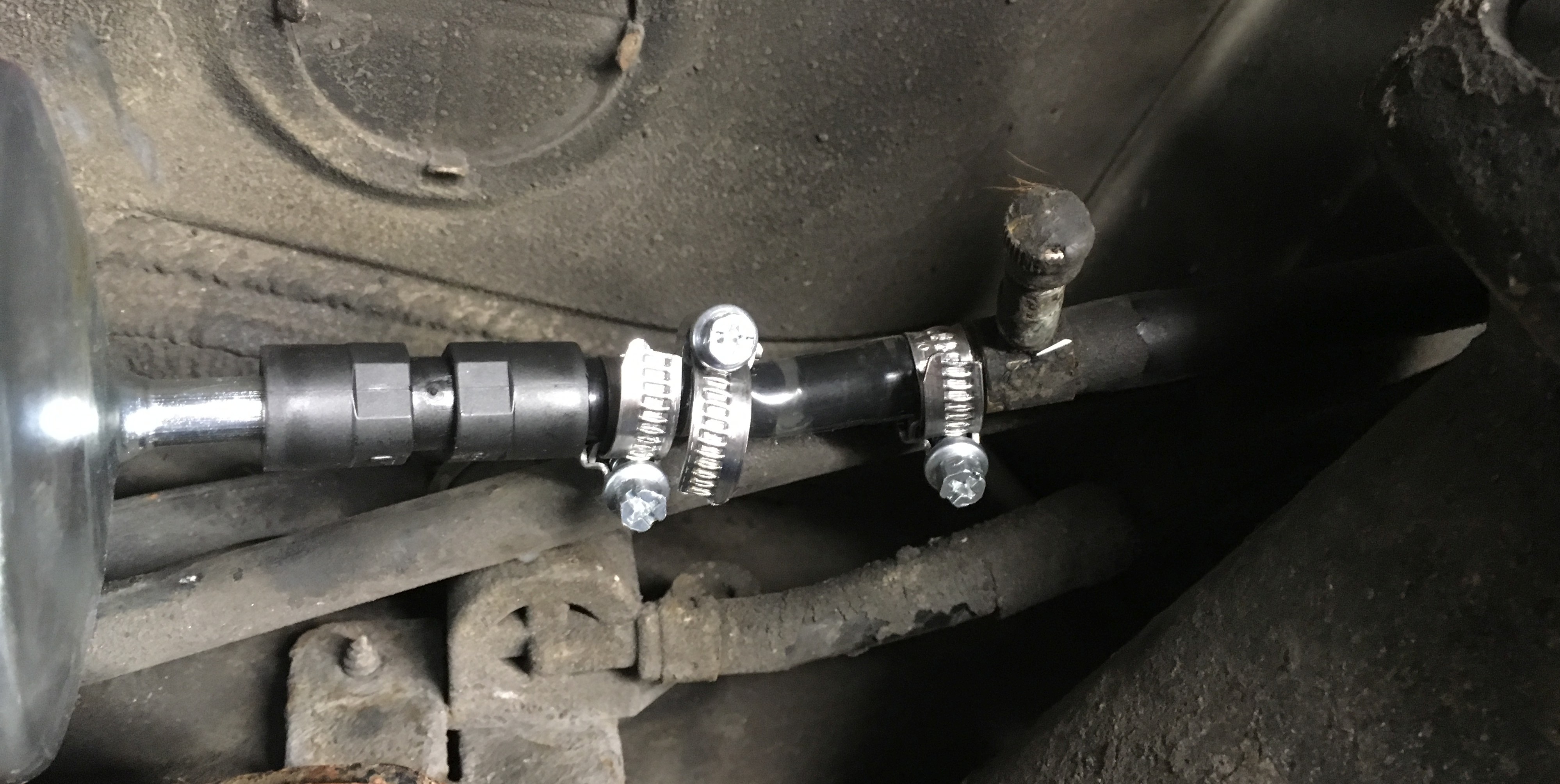

Thanks for the answer, abscate. Unfortunately it did not work, so I cut the old line and got some outside help. I was provided two Renault quick connectors for standard 8mm fuel lines and a piece of salvaged 8mm fuel line. Plan was to just stick a piece of new line into the old line (securing it with two clamps) and connect the new line and the filter via the quick connectors (filter is also 8mm)
Turns out that the original Volvo fuel line is just a standard 8mm line wrapped with a secondary rubber protection layer, so the original plan was foiled.
I improvised:
1. On the line leading to the engine, I cut some of that outside rubber away and connected filter and line directly. 2. The line from the tank was now too short, obviously, so I had to extend it. But I was missing a third quick connector. I managed to find a piece of clear tube with just under 8mm inner diameter that fit over both lines and secured it with clamps. See pictures for clarity. Additional note: I wrapped the new filter in some self-vulcanizing tape. It was slightly smaller in diameter and the old filter had corroded onto the big clamp and was actually leaking fuel! At least after I removed the clamp.
I improvised:
Yeah, guess what? One of those quick connectors actually leaks fuel at the filter nipple when I rotate it. That was a brand new originally packaged piece. Wtf? And it also only "connects" but never "DISconnects"... so I guess I have to cut out the brand new filter and do it all over again. *groan*I think you will need a new fitting on the other side. That’s an ugly job, but fuel leaks are an even bigger job involving fire and a new car
