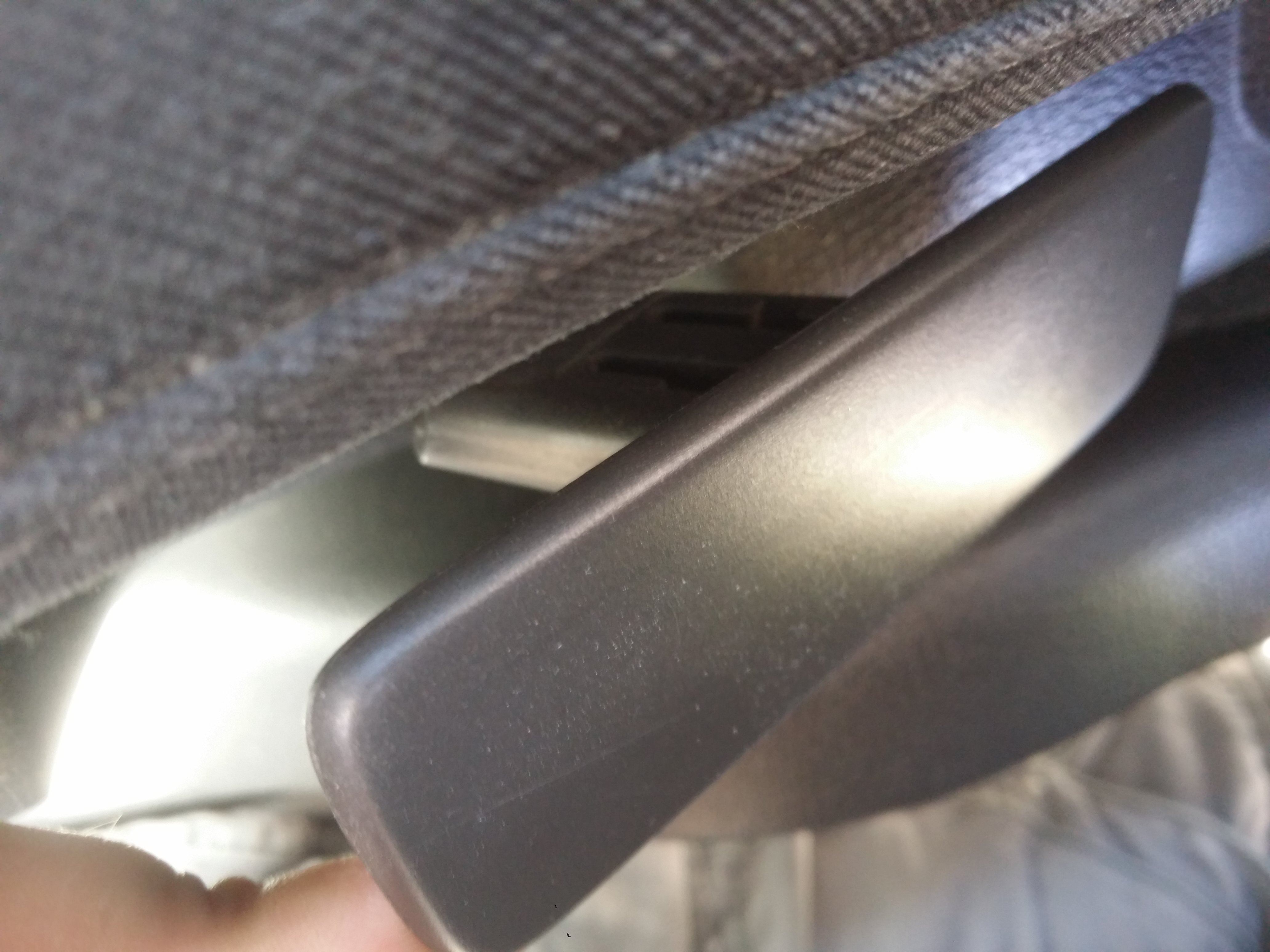

Found a hex screw on bottom of plastic lever, and when removed, lever easily removed.
Seat Side Molding Manual Seat Height Adjustment
Does anyone know how to install a new Seat Side Molding on a seat with a Manual Height Adjustment lever? This is for a 2005 Volvo S 60 without power seats. The lever does not appear to be easily removed and I do not want to crack the new molding by trying to force it over the lever handle.

Now my car is a 2002 and they did change the seats I think for the 04 MY but maybe this helps. You have to remove the lever handle first. Pull it up to reveal a clip on the inner (seat cushion facing) side. Release the clip and remove the handle.
Edit:add photo
