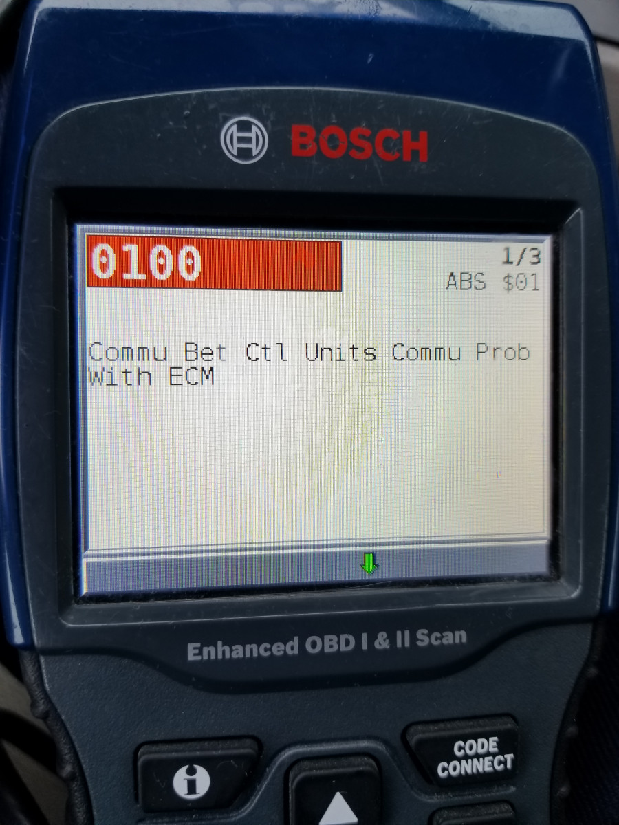

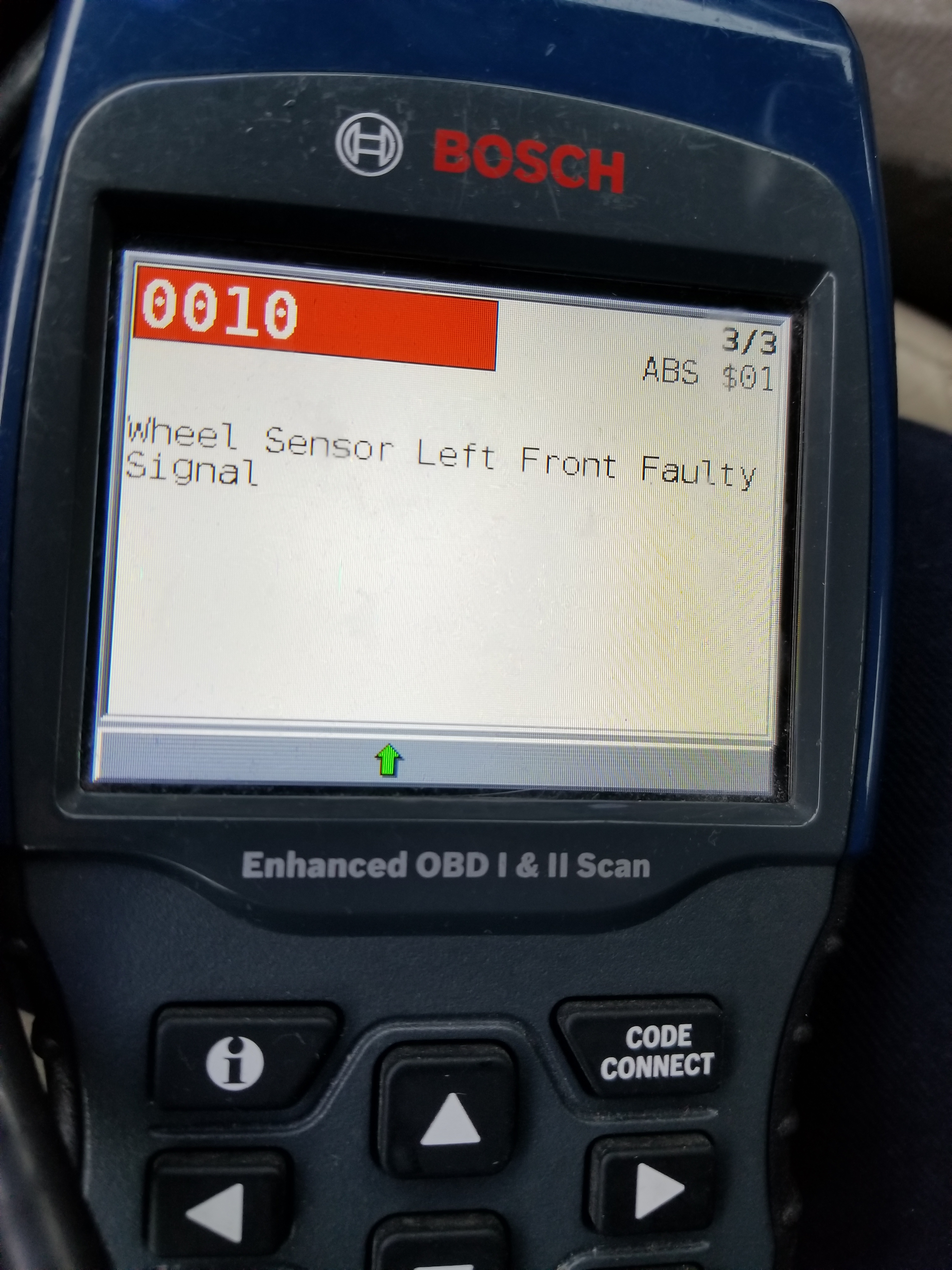

I tried reading the codes with an older OBDII reader but it would not find the ABS error codes. From my reading it seems like some of the OBDII reader will not pick up on Volvo ABS error codes?

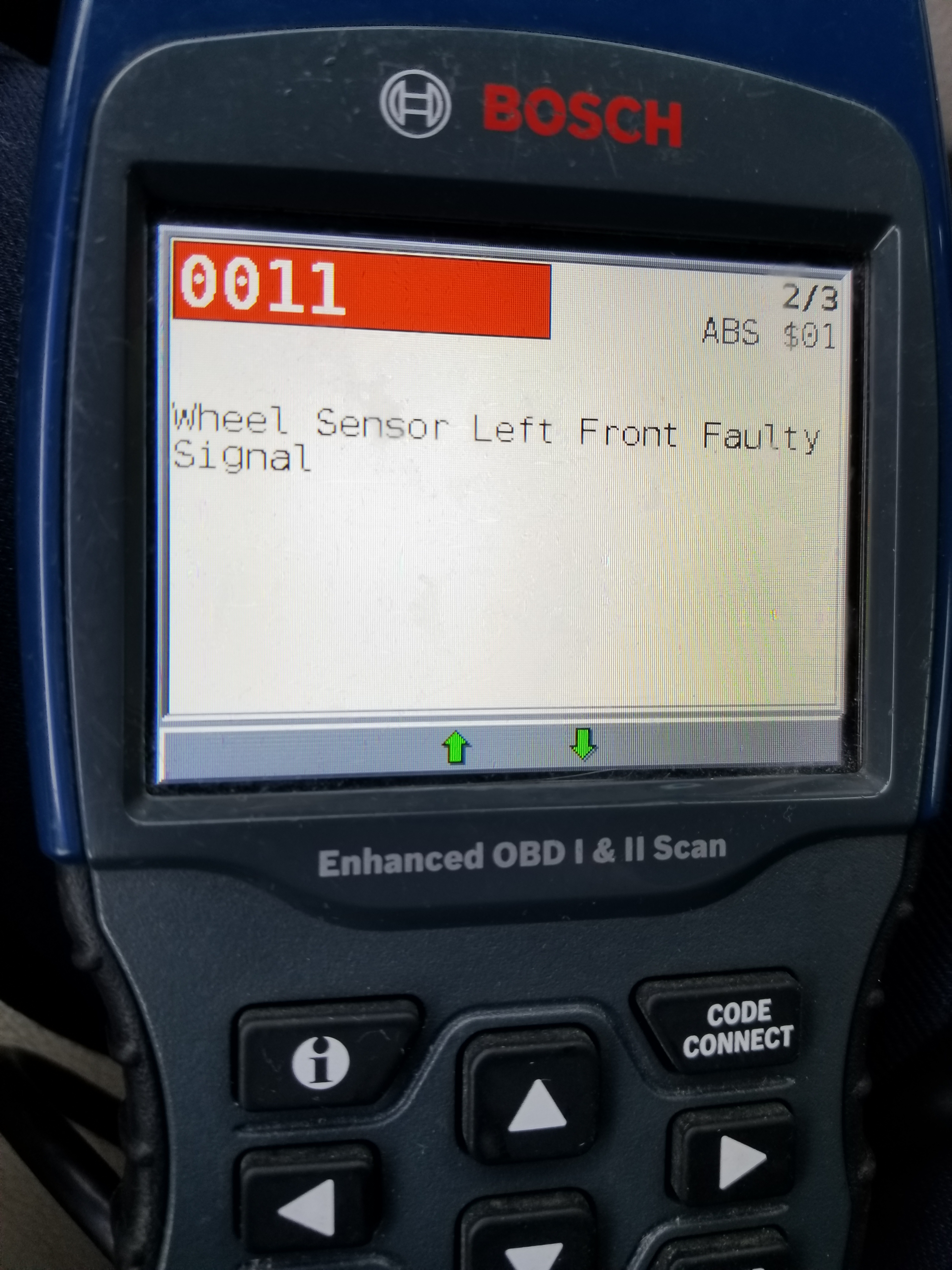

I ended up going to AutoZone and using their Bosch OBDII reader which did pull up 3 codes:
0100
Error Code-I think this is the same as BCM 0100
0010
ABS Error Code 0010
ABS Error Code 0010
0011
ABS Error Code 0011
ABS Error Code 0011
I was getting really concerned because everything I looked up was saying that these error codes were almost certainly about the ABS module failing and that it would need to be re-soldered or replaced ($$$$).

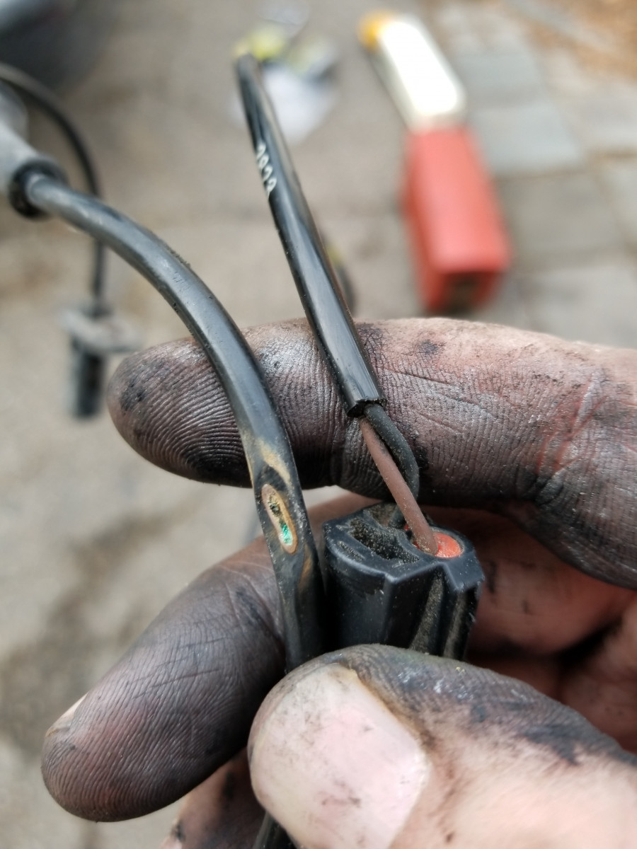

I was able to replace the wheel sensor with a unit I got on amazon for $16 and it worked like a charm. After inspecting the wire you can see that the wire had worn completely through by rubbing on the sway bar link.
Damaged wire
Damaged wire

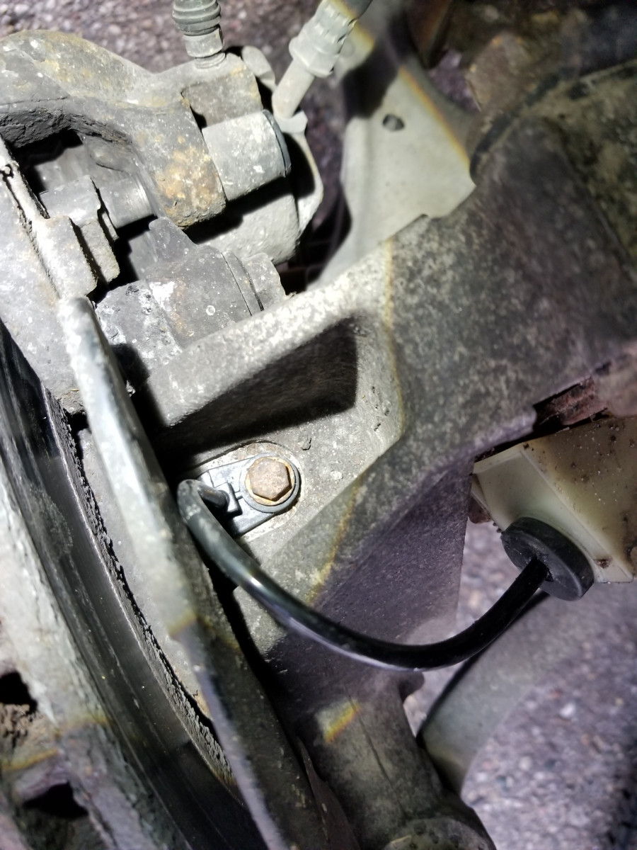

2. Access the wheel sensor on-top of the wheel knuckle. Use a 10 mm to remove the bolt. No need to remove caliper or disc.
Location on knuckle, easy access
3. Use gentle pressure on the sensor cord to remove the sensor. Mine popped out after a little wiggling.

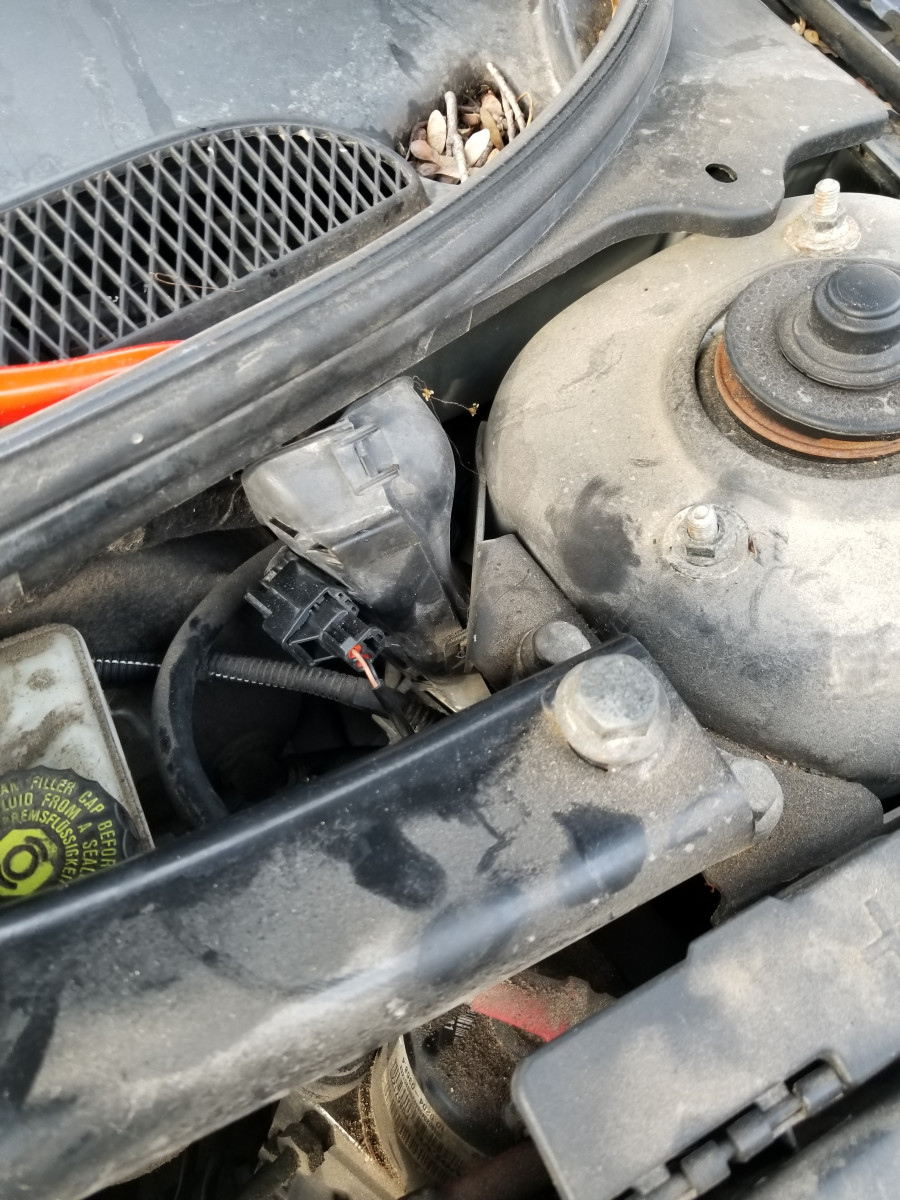

5. Remove the under hood sensor connector (near strut tower).
Under Hood Sensor Connection near strut tower
