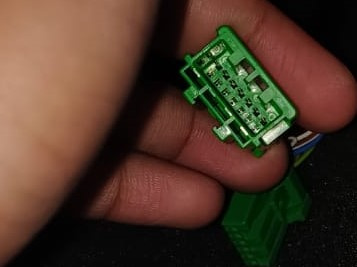

Can someone please tell me what this connector is.
I am looking for this in a Male to female as I need to extend this cable.
Photo attached

Where did the cable come from? What device, module ... are you extending?

Looks like the P2 CAN network connector.

Its a connector from the massage button cable and needs to extended to the cable where it fits into the seat, its like 3 to 4 cm short so if i can find extender cable it would be great

I am not sure that helps as Igoogled that and not a lot help from Sir Google.
Can you advise a little more please

Can you reroute the cable it on a shorter path?

I don't think one will find an extension cable. Most likely you can find the two connector ends and then add the wires.
Best route is what RickHaleParker suggests - second best route is to pick the end of the harness with the fewest wires and easiest access and then splice in the amount of needed wire to reach. One wire at a time so no mix up, cut, strip, solder, shrink wrap and move on. Then either shrink wrap or tape the entire repaired area and add a wire loom if wanted/needed.
