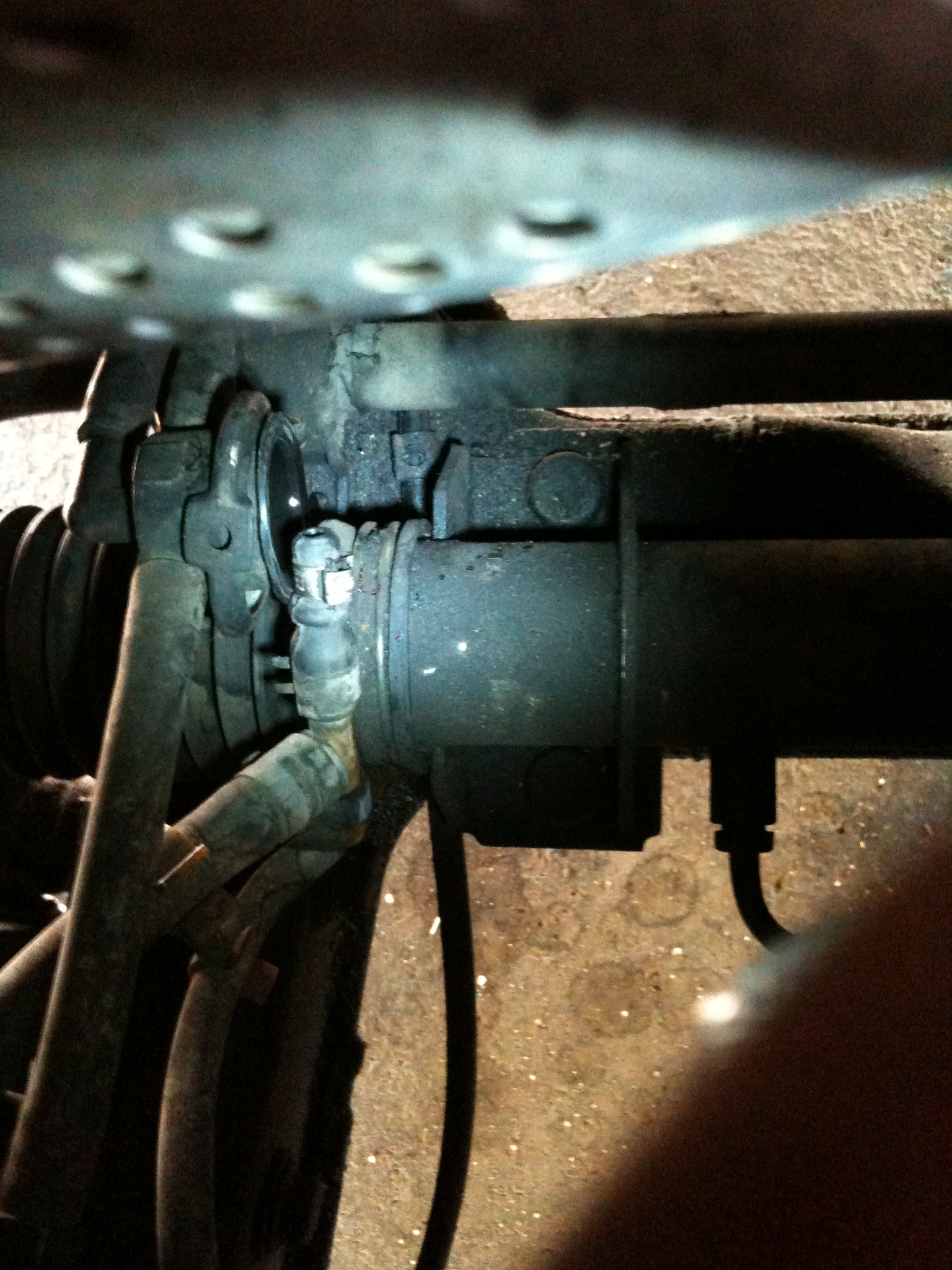

So since i wasn't able to get a clear answer i decided to just follow the vacuum hose back from the engine to find out the Fuel Pressure Regulator on a 1998 V70 XC AWD is NOT on top of the tank it is right above the front axle/ I have attached a couple pics to show and also verified the part number on the FPR to make sure that is what it is. With that being said now that i have it off the car how can i test my FPR to make sure it is bad?
from standing in front of car looking down to the left axle

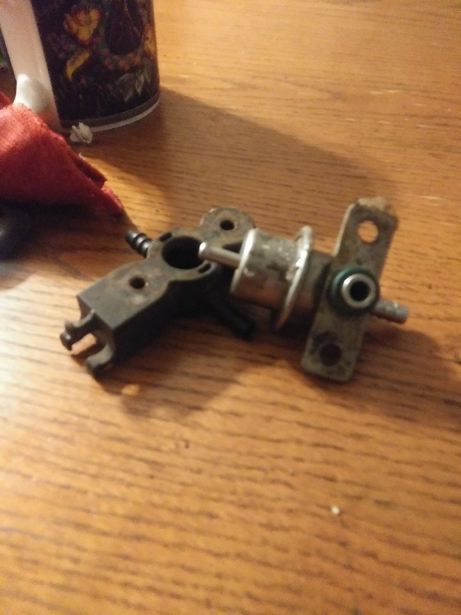

So while replacing the regulator i broke the plastic housing that has two lines that go into it. The fpr screws down into the plastic piece and for the life of me I cant find a part number to replace it. Any idea what its called?

The plastic piece shown in this picture is what I need to replace

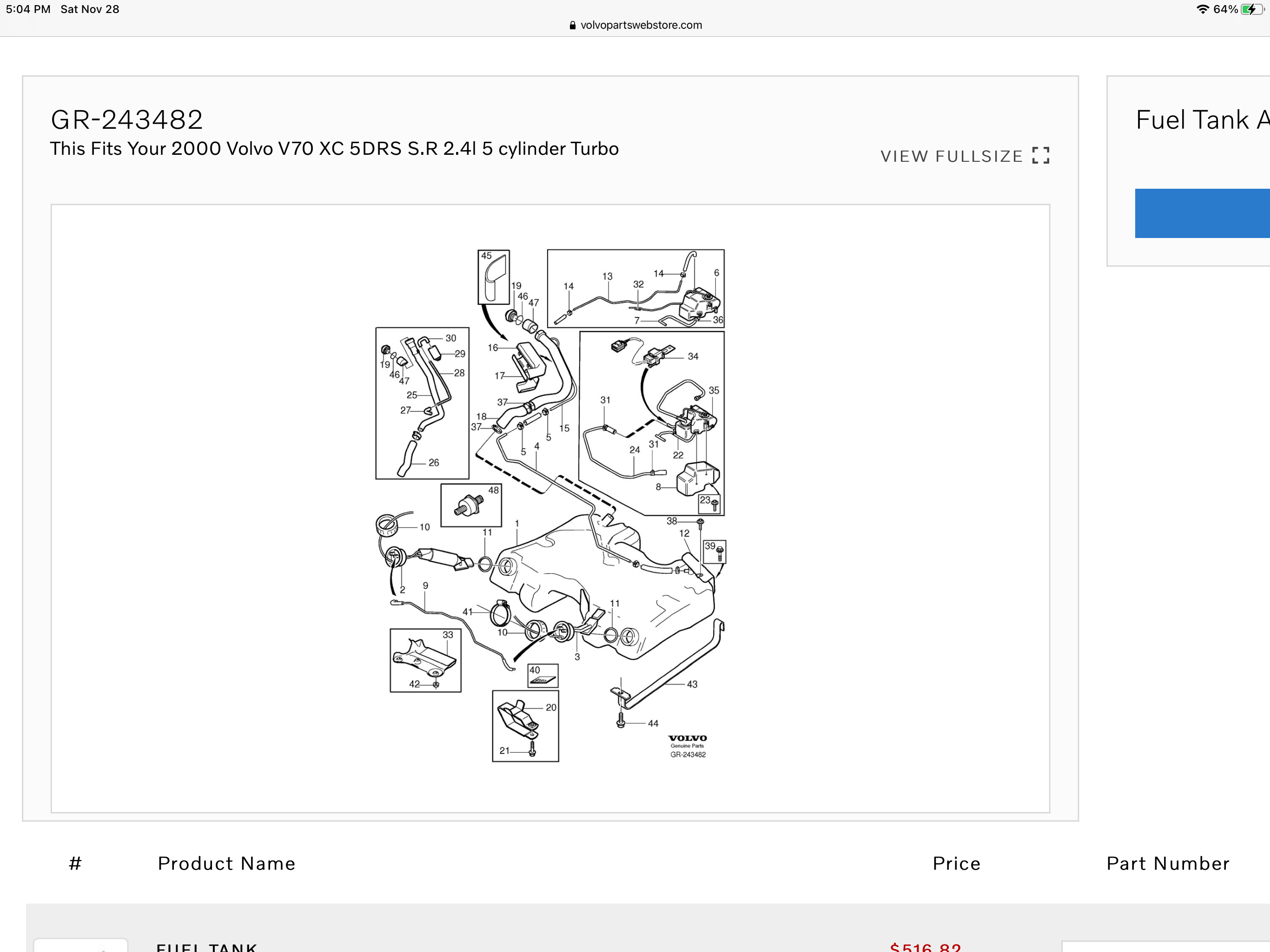

Punch your model into the volvopartswebstore website and pull up the fuel system diagram to ID

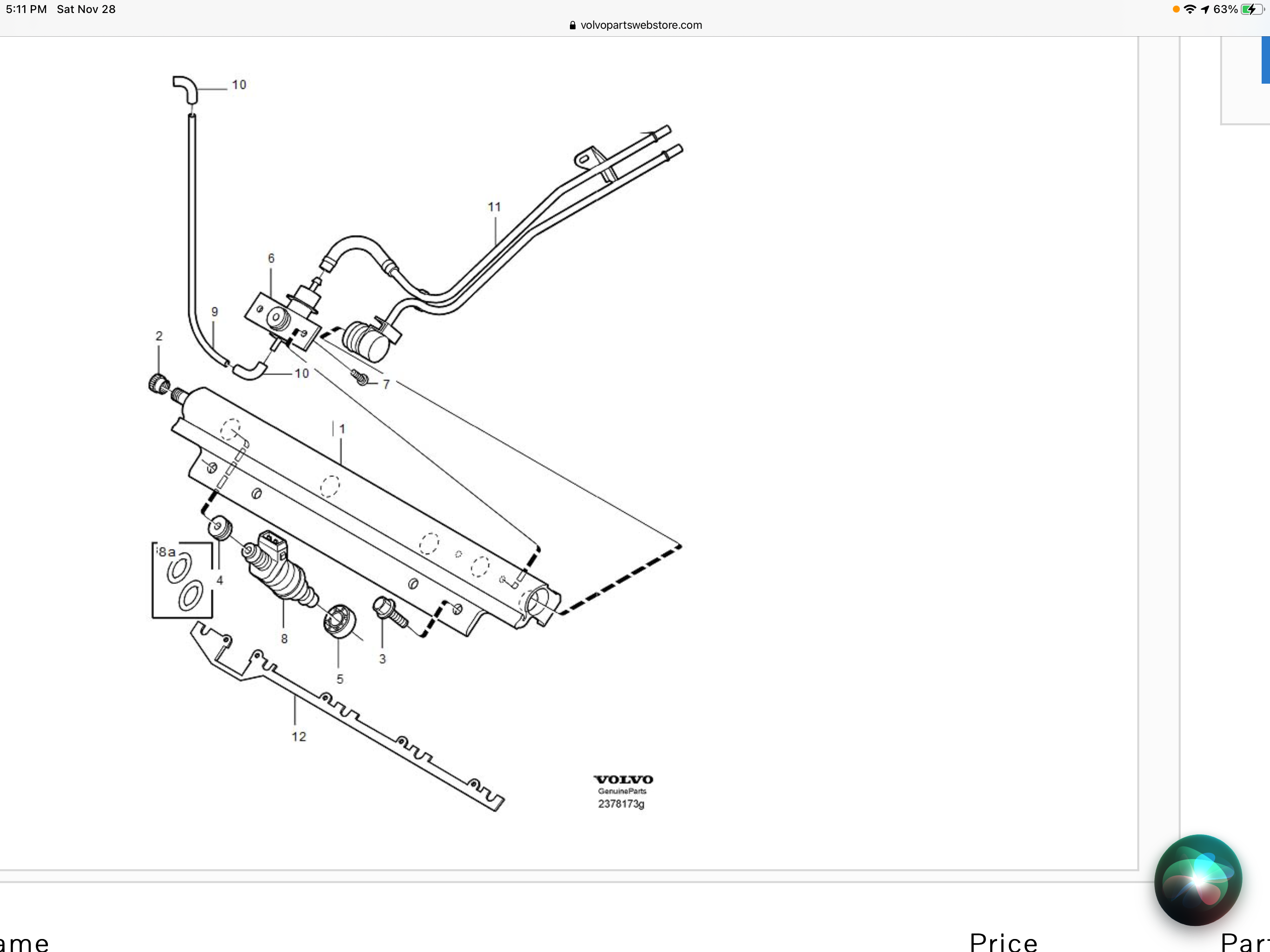

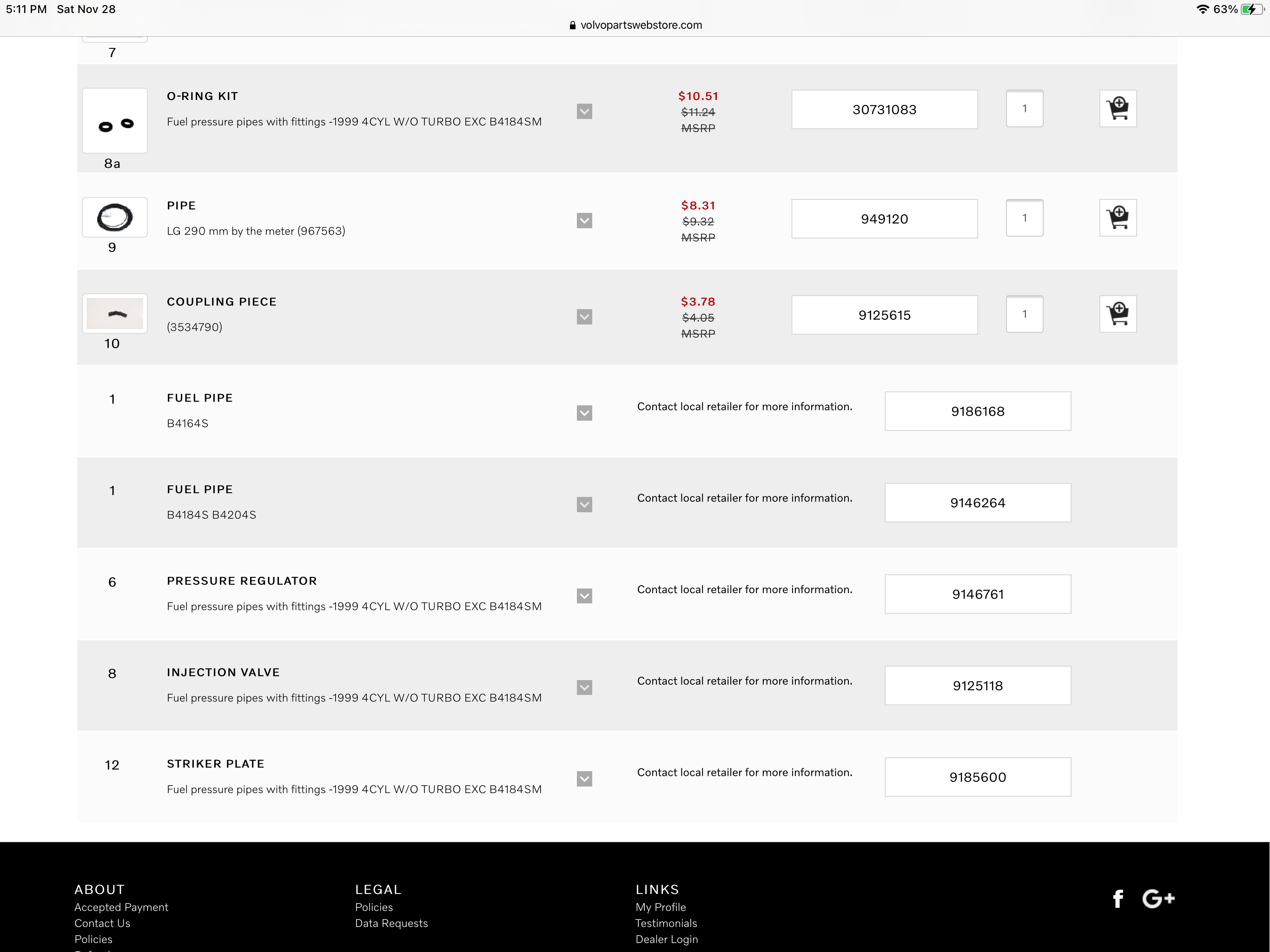

I've been trying to find it listed there and no luck so far but ill keep trying. This is the last piece I need to have it up and running again. Its a 2000 v70 xc and it seems everything I find shows the wrong diagram. The fpr on this car is mounted on the tank. Volvos parts dept weren't of any help either. I've found multiple threads on here that definitively show the piece (one where a user mapped all the fuel lines) just can't find anything on what its called. I've tried fpr actuator, valve, etc and no dice yet.

Looks the same as the tank mounted one
