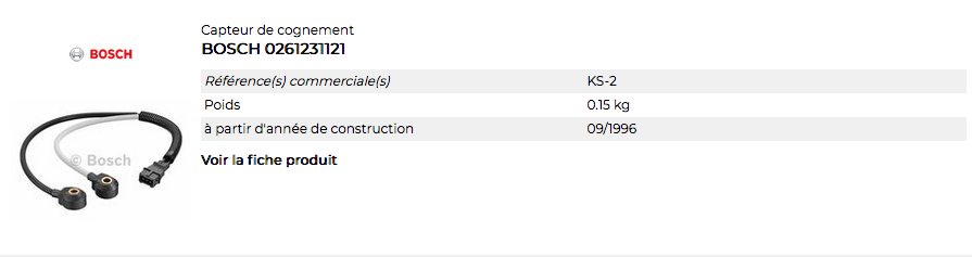

To what does this part serve ? Does it "break" often, and what is the sign this part is out of work, does it have an influence on the way the engine works ?

That in the picture are knock sensors.
They never fail but their wiring could make problems.
They are under intake manifold,just by pcv box.
Iac valve could be cleaned with a brake cleaner and it is
99.9% success.
Maf sensor do fail,but more common is that it's connector that fails.
Iac valve is Bosch,
Maf MUST be Bosch
Knock sensors MUST be Bosch.
Generally....all sensors on these cars MUST be BOSCH(oem),nothing else will work or it will have wrong readings and wrong data(out of spec) sent to ecu.
