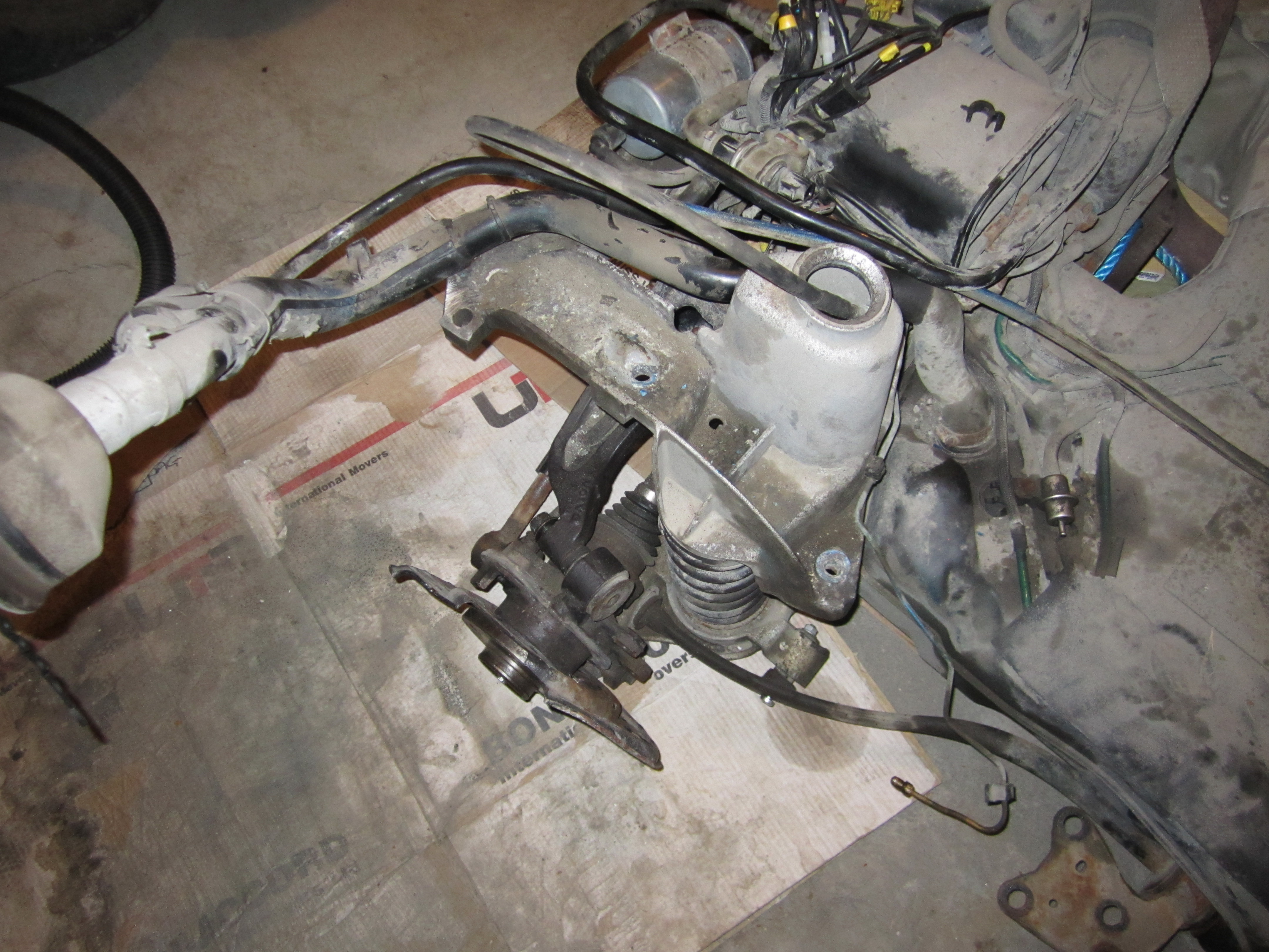

This picture may help show all the bends in the system. This is from my 2000 V70R AWD which is similar:
You can see the filler neck on the LHS of the picture and see how many curves it makes to the tank from there. You would have to use a fairly narrow and flexible pipe like a clear 1/2" tubing to get it to turn all the way down there. You may have to go even narrower.
