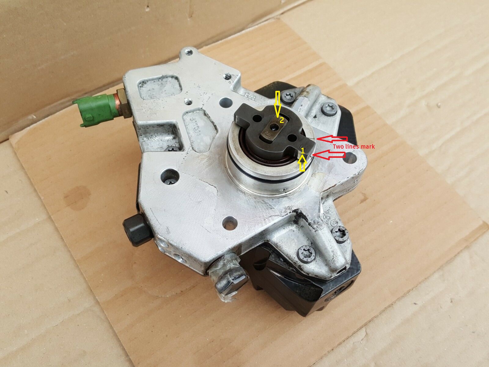

When removing the pump I didn't pay attention to pump timing. So when I took it off this time, non of the slot (1 and 2 in the pic) was in the middle of the two line marking on the pump.
I tried these steps but wouldn't start:
a. No 1 positioned between two line, then turned crank pulley till camshaft grove aligned with No 1
b. No 2 positioned between two line, then camshaft grove aligned with No 2
Whats the correct way to do the timing?
Thanks in advance

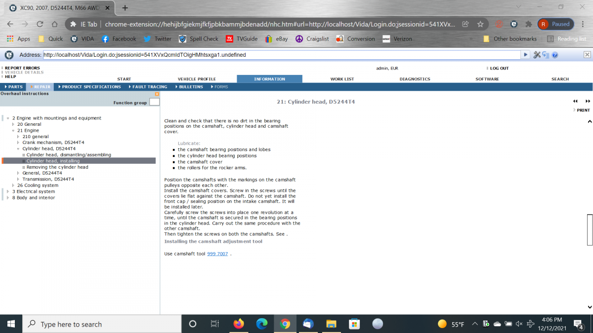

zakmuh wrote: 12 Dec 2021, 13:52
Thanks, yeah I have VIDA but struggling to find the instruction for camshaft alignment. Would you know the section number?
Information / Repair / Overhaul. Then find Cylinder head install in the left menu. May sure you have the crankshaft aligned before doing the camshafts.

Post by zakmuh »
RickHaleParker wrote: 12 Dec 2021, 15:03
Nice one Rick
Please correct me if I'm wrong with these steps:
1. Get timing marks aligned to markings on timing belt sprocket and camshaft sprocket dots
2. Remove timing belt (drive belt still in place)
3. Lock the camshaft through the hole behind vacuum pump using alignment tool
4. Lock the crankshaft behind the starter motor using other alignment tool
5. Rotate crank pulley anti clockwise until it hits the alignment tool and stops
6. Refit timing belt, vacuum pump and starter motor
