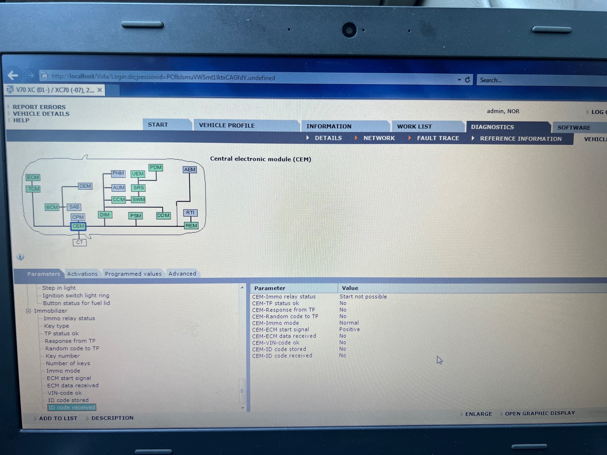

My battery died, after replacing I can’t start the car, and on display is “ car prevented to start” message . When I checked with vida under immobilizer I have this reading. Does car lost memory of key and need to be programmed by volvo dealer? Is there any other option? Thanks for any suggestions.

I would disconnect negative post with the keys out of ignition. Wait 15min. Reconnect negative cable. Open and close car with keyfob several times. Open and close with the key manually as previously suggested above(doubt will help, but will not hurt for sure). If you have 100% previously working spare key-use it to try to start the car after praying to volvo gods(or cursing them). Hope the luck will be in your side. If you have the same issue- read the codes again and see if anything changes. Make a note of the Vida is able to recognize the vincode of your car upon starring the system. Make a note of the codes and try to erase them and start again with the key open/close step. If no luck- read the codes again and try to click and test each component under immobilizer section(left bottom on your photo) and see what car can rea d and what info it is lacking. I would start with looking if car has any keys stored in its memory-if number is 0 then call qualified service(some locksmith nowadays can make not only key, but program key to the car) and ask them to program your keys and let's hope for the best.
