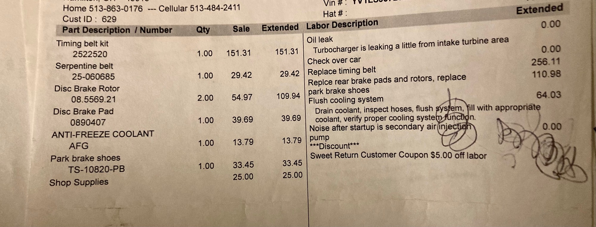

One common place for oil leaks on the pre-'99 turbo cars is the oil cooler lines, again, not a big issue but annoying. I have removed them completely on two cars and installed the delete plate, end of problem.

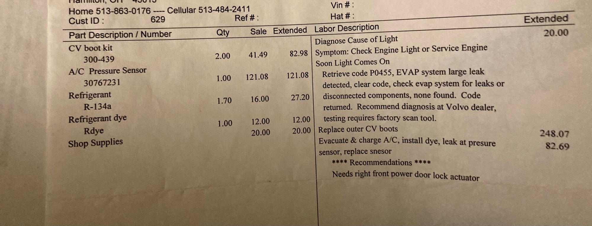

That looks to have a persistent P0455 code. Seeing as they "found no leaks", I'm guessing it would be above the tank. It's not a real issue, but annoying. My wife's '97 GLT had a P0455 code for 3-4 years until I finally traced it to a chewed up hose on top of the tank.

I saw that too. I guess if they didn't have it then maybe they had to call Volvo..............!??

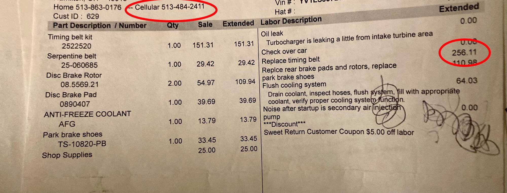

The old days of ~$400 timing belts and home vs.mobile phone numbers!
I think this is going to turn out to be a good car.

"Sweet Return Customer Coupon $5.00 off labor"...
Don't do us any favors, geez.
- Posts: 36148
Probably a 1/2 hour minimum labor rate charge
