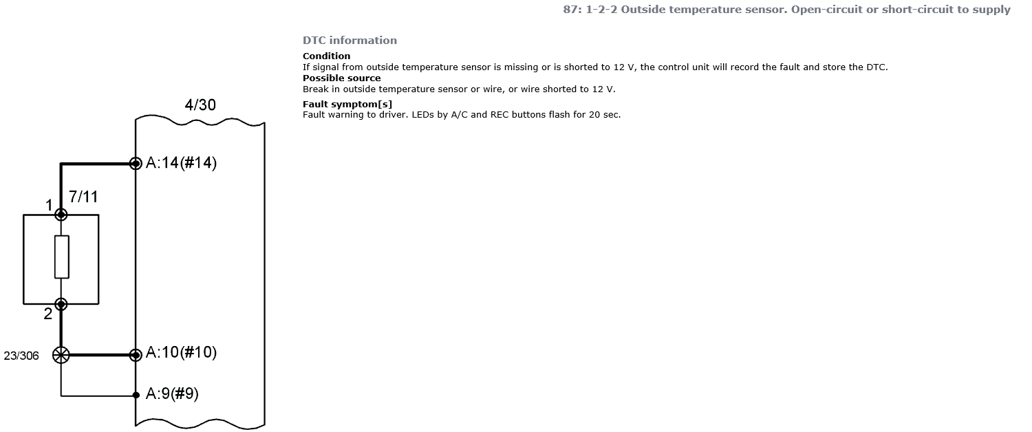

Couldnt find any useful infos in vida yet. Just tells for checking the wiring if the sensor in the bumper is okay. (see picture below, not much infos)

Is there any way you could send me a key for the wiring diagram picture! I'd like to see whatsup with those!

Mainly curious as to what 23/306 is and 4/30 on the diagrams you sent. The rest I'm assuming are pins?
