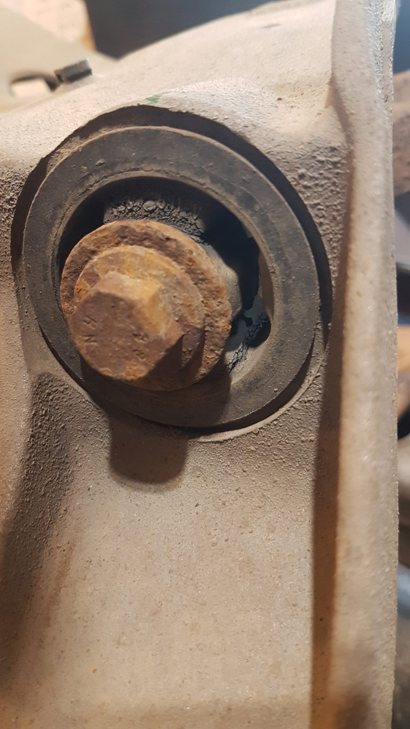

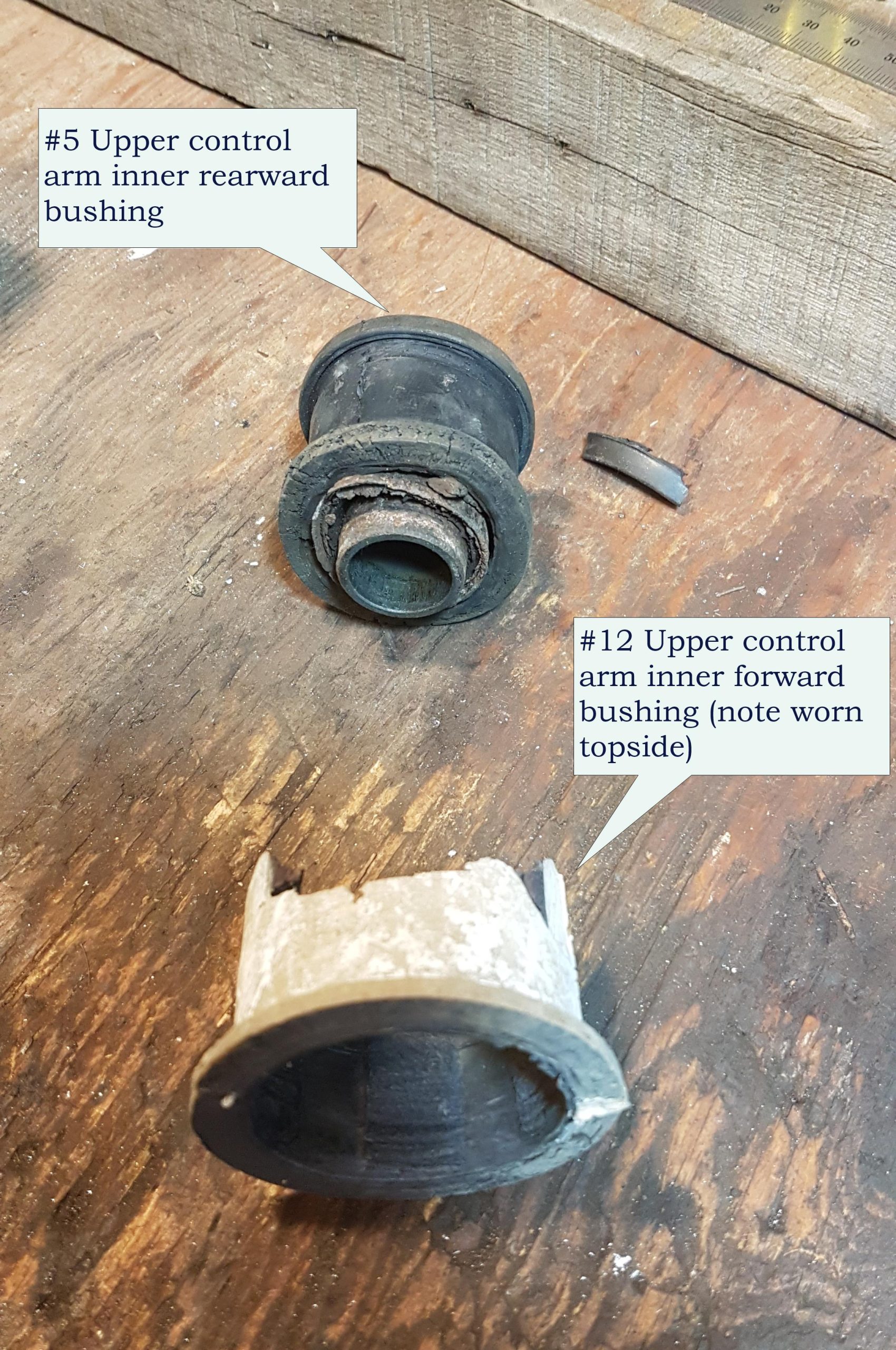

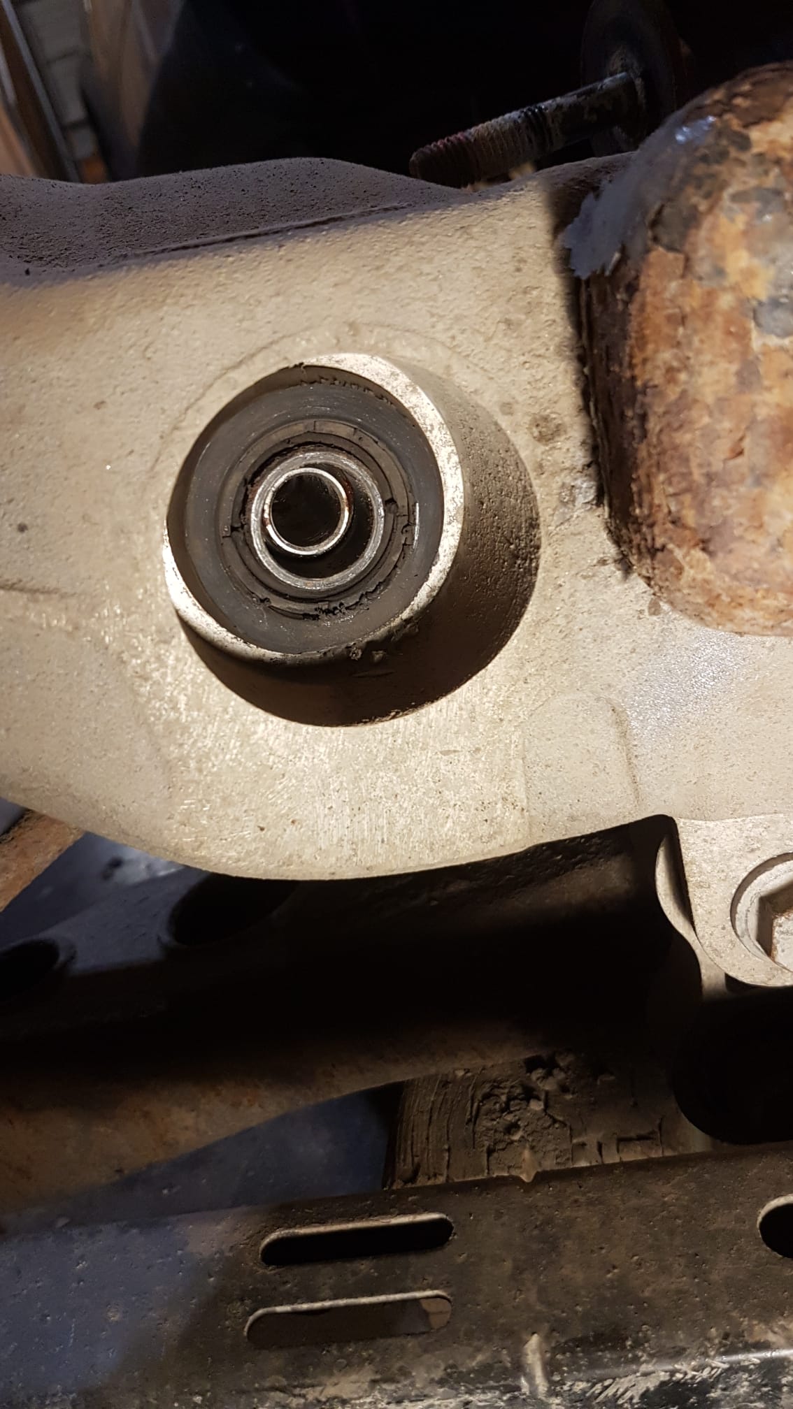

One suggestion from me is that for the rearward facing bushing I would suggest using a compression sleeve before forcing the bushing into its seat. I tried without and tore the collar on mine a little as it started to give resistance. I then found a short length of pipe that was close to the 40mm bore seat (bit bigger). and used that as a delivery barrel, thus "pre-compressing" slightly.
Also of note for anyone inspecting their bushing to track down a bad rear-end vibration. Very bad vibration at around 85km/h but my bushings looked in-tact which didn't explain the severity of the vibration. When I removed the forward facing bushing (first hole-sawed rubber core) then the hard plastic outer half, I found that the whole bushing had been moving and wore out the plastic sleeve. Problem found!
I have not been able to upload the pictures to go with this post. If I figure it out I'll comment again.
