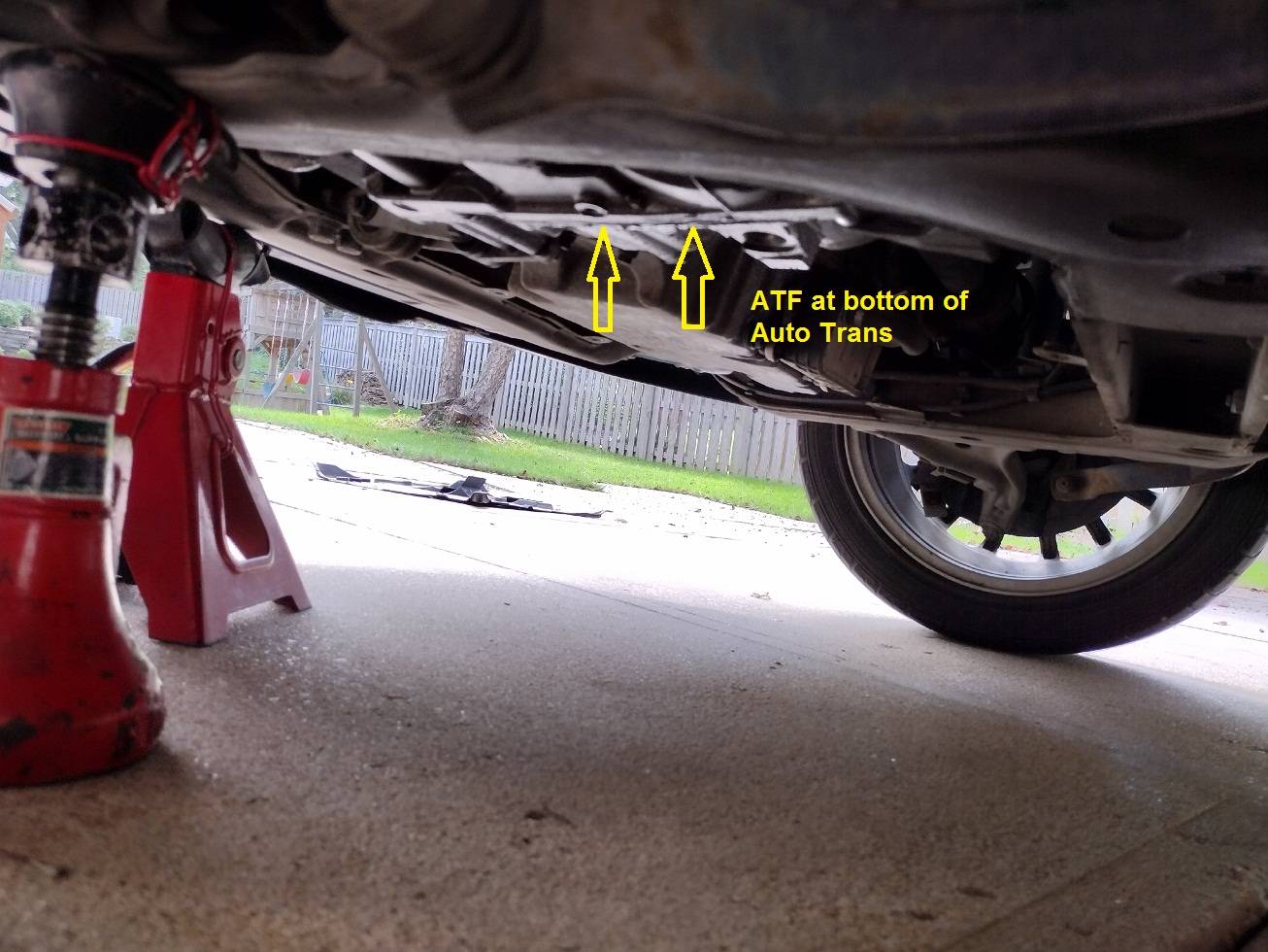

Another Update, this time it is the 2007 S60 with 125K miles...
I previouly redid the R seal in 2006 S60 with 106K miles in 2024.
The 2007 S60 LEFT seal leaking, I am becoming the seal expert lol.
I installed new Axle seals for the 2007 S60 in 2022 (3 yrs and 10K miles ago).
NOTE:
1. ATF leak at bottom of Transmission:
2. Note the garter spring came off during installation in 2022:
3. Note the 3 year-old seal with edge folding over. The fold-over section is between 10:00 and 2:00, so only leaks
ATF when driving.
4. New Seal, Wood Tool and Red Tacky grease (to be applied on the garter spring).
Even so, the brand-new seal folded over and thus destroyed, simply bc the only way to remove the brand-new seal is
to drill a hole for the sheet metal screw!
5. Luckily, I had another seal lying around.
- I used a piece of plastic. Do NOT use metal, you will regret bc if you score the metal sealing surface on the cup side
(the trans side), it WILL leak.
- So, I used the empty Clorox Disinfecting Plastic Container.
- You can use 1 piece or 2 pieces at opposite sides.
- Make sure you wet the plastic piece with ATF, go around slowly to be sure the seal lip is in correct place, it is very tight.
- To pull it out, do NOT yank it. Instead, rotate it around the sealing surface and slowly pull it out as you rotate it around
the seal.
Lastly:
1. Double-check, triple-check to be sure the seal lip is in the correct place.
2. Don't forget to add some ATF. In my experience doing the seal, some ATF will leak out during the job.
All you need is about 200 mL of ATF added at the end, when everything is buttoned up.

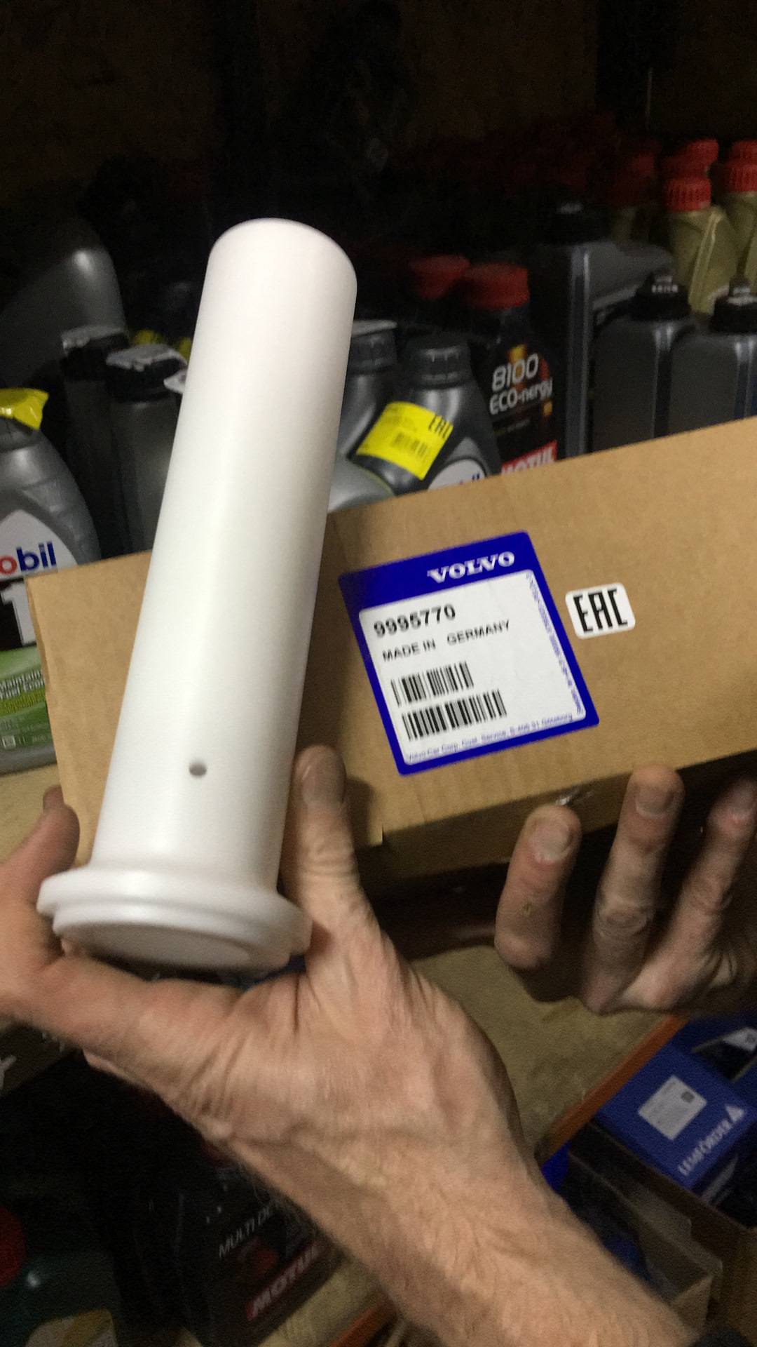

One of Russian volvo lovers (https://www.drive2.ru/l/709101163227644748/) shared me a blueprint of the tool and I asked another friend to create a 3D model and print it using 3D printer.
So he did. He used ABS plastic for printing. If you have a 3D printer or have any friend/company who can print, feel free to take files from the git: https://github.com/DJ-Glock/volvo-9995770
Hope it helps someone.
