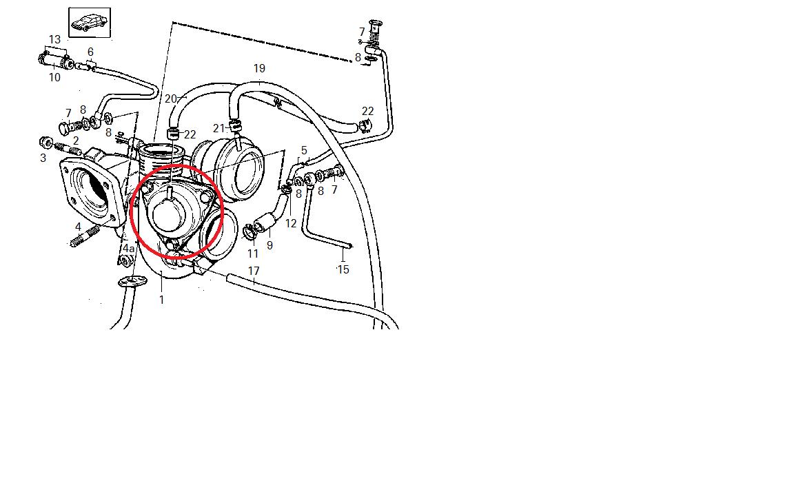

You might want to upgrade your Compressor Bypass Valve: http://www.quickbrickmotorsports.com/pr ... grade.htmlStevieb wrote:Perhaps a remedy to my low boost pressure
Hmm, never even heard of that! It seems to be the alternative to the familiar blow-off valve. I was poking my head around today but I can't seem to locate it looking into the engine bay, and have had no luck searching for volvo specific images. Based on the info in the link it would seem a car with as many miles as mine would very likely benefit from a new diaphragm. The MCB also seems promising; a performance chip is a bit too expensive. If I were to replace the air filter with the short ram should I expect any performance increase?

It's on the turbocharger compressor section.Stevieb wrote:I was poking my head around today but I can't seem to locate it looking into the engine bay, and have had no luck searching for volvo specific images.
