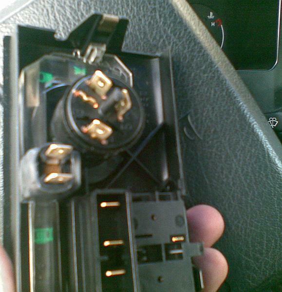

If you reconnect the yellow wire you should get DRLs on front and rear parking lights. If the dim dip relay has been removed you may be able to locate the connector which would fasten to it. It will have 5 electrical sockets.

In my case there 5 wires attached to the lights selector but only 3 contacts on the switcher.
I had a spare part with 5 contacts (from a diesel too) on the lights selector... i just mounted the the new switch and voila: I have DRL's now.
