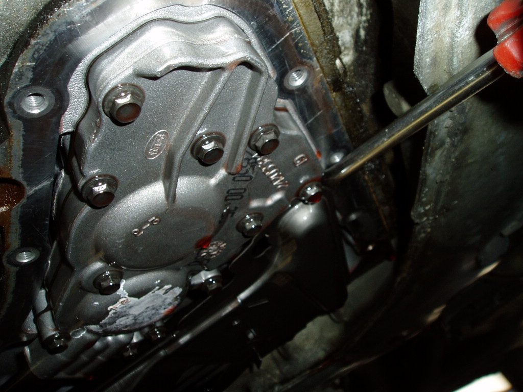

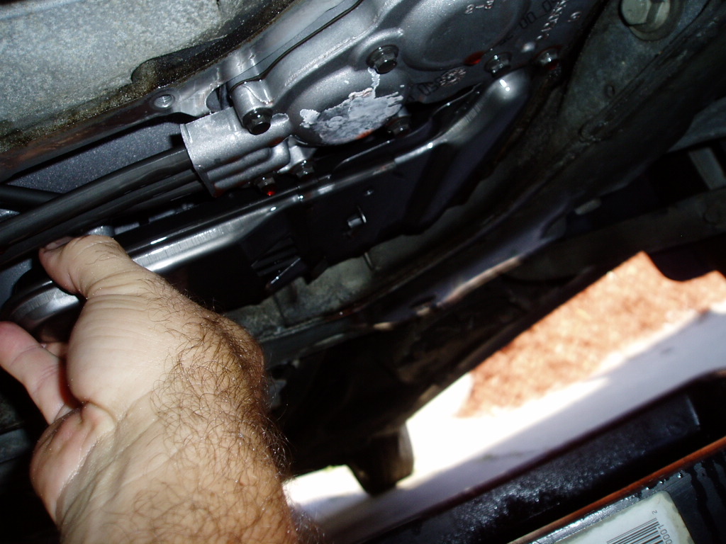

Drop the undertray down and slide it out of the way. Move your drain pan under the transmission pan. Loosen the 10mm bolts along the rear of the pan, then loosen the bolts on the sides and the front until fluid begins to flow out at the back edge:
Wait until the fluid stops flowing, then remove all 20 bolts. Remove the last bolt while holding the pan up to the bottom of the transmission. Slide the pan forward slightly to clear the subframe. Keep the pan horizontal and bring it down over the drain pan, then tip it so the remaining fluid flows into the drain pan. Set the transmission pan aside.

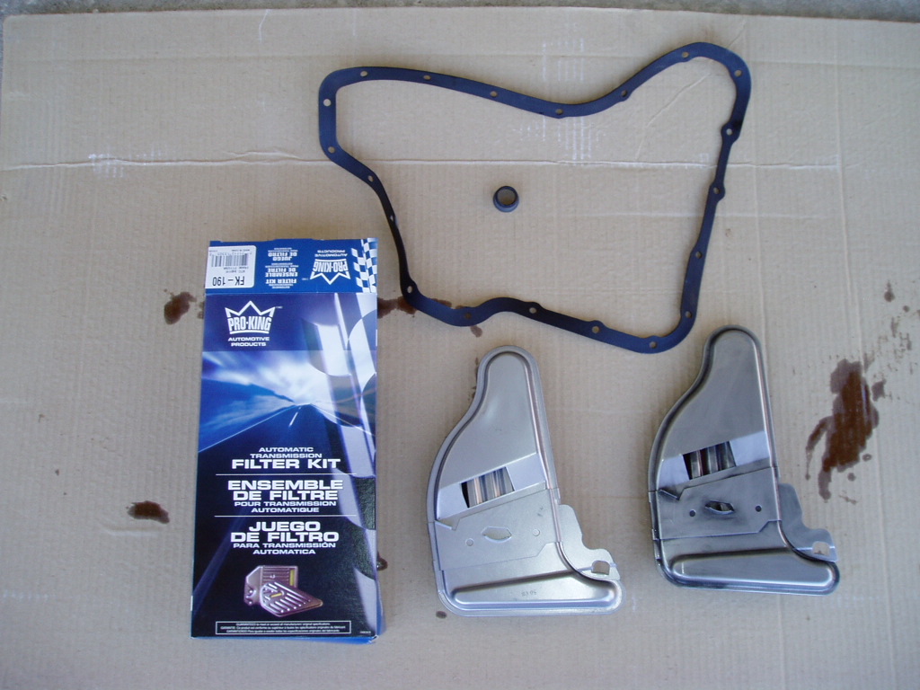

Here is a comparison of the old and new filters:
The filter on the right is the old Volvo brand filter that cost $37. The filter on the left is one I got at Advance Auto parts for $13. I told them I wanted a filter to fit a 2000 Chevy Impala 3800 (3.8 liter engine) and that's the filter they gave me. It looks pretty much the same and should work because both cars use the same transmission. Pep Boys and Autozone also carry the filter for the Chevy. Of course, there's no way to know what the filter media inside looks like, so if you're really concerned, you might want to spring for the more expensive Volvo filter. Personally, I think it's the same thing in different packaging.
The kit comes with a new rubber pan gasket. Use it if your car has a non-reusable gasket on it (like cork). If you have the rigid reusable gasket that has ridges along it's length and around the bolt holes, use that one and discard the rubber gasket. The ring in the photo is a replacement gasket for the suction tube that goes up into the transmission. You can pry the old one out and press the new one in, or reuse the old one. I just reused the old one.

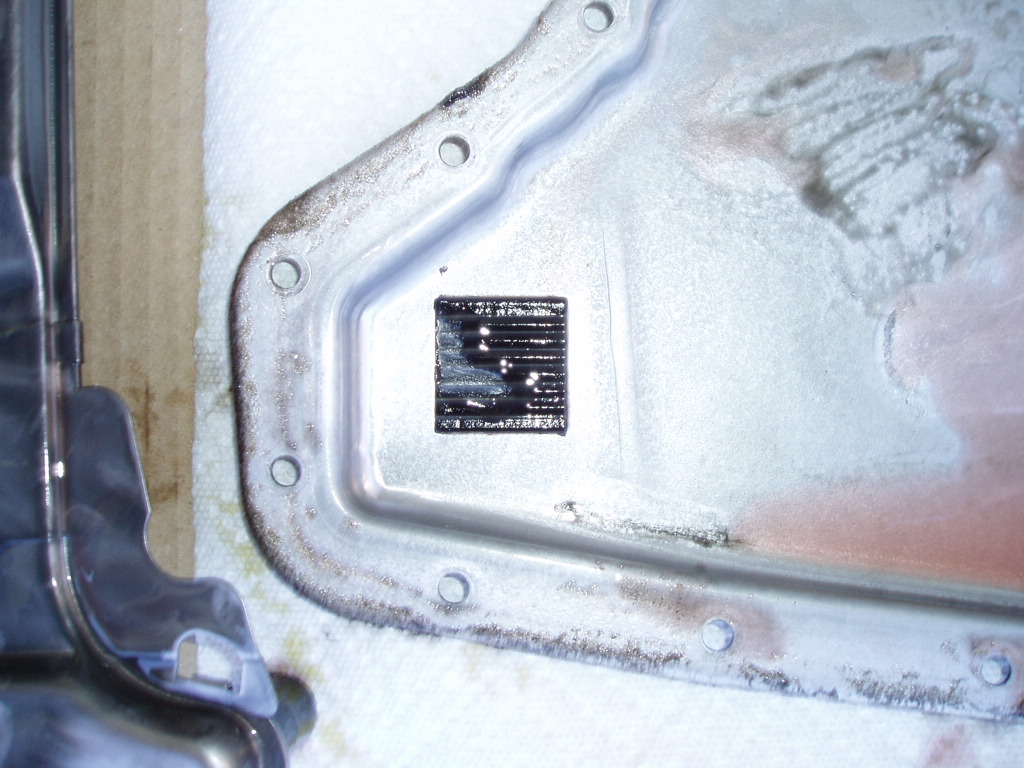

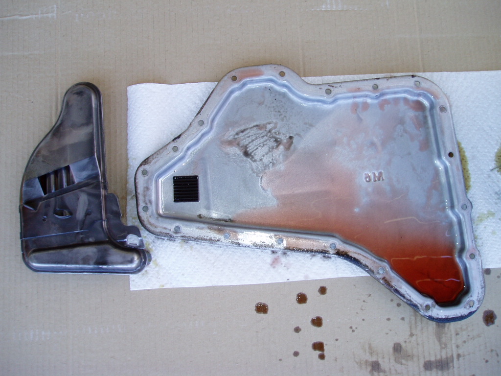

Use the disc brake cleaner and paper towels or rags to clean the transmission pan. Here are pics of my pan before cleaning. You can see some very small black particles in the bottom of the pan. The magnet (the rectangular shape to the left) has a coating of particles on it. All this gunk should be removed.

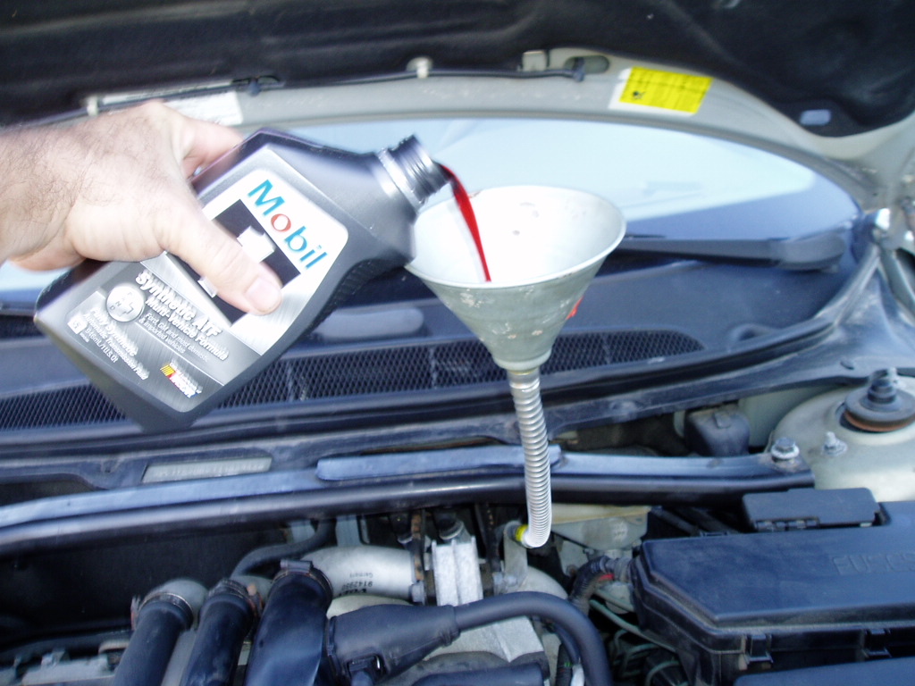

Now remove the ATF dipstick.
Insert a funnel into the dipstick tube and add Dexron III, Dexron VI, or equivalent fluid. DO NOT use Type F, Mercon, or 3309. Add a quart and check for leaks. If no leaks, add 5 quarts and check the level. It should take a total of about 7 quarts to refill it. The level is checked with the engine running and the transmission in Park. Shift through all of the gears first.
Reinstall the undertray, remove the drain pan, and lower the car to the ground. Recheck the ATF level. If you have some showing on the dipstick, drive the car a few miles to heat up the fluid and then recheck. It should come up to the HOT line on the dipstick. If it doesn't, slowly add more ATF until it does. Do not overfill.

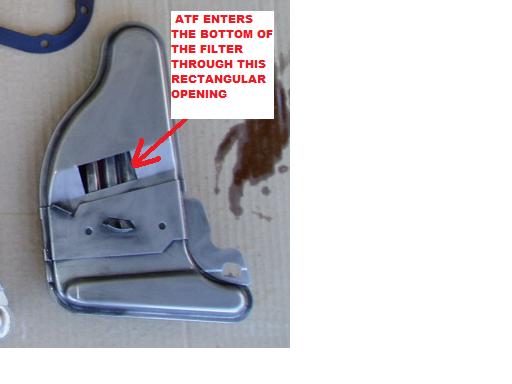

PS. Just for grins I decided to open up the old filter to see how it worked.
The fluid goes through this rectangular opening in the bottom of the filter:

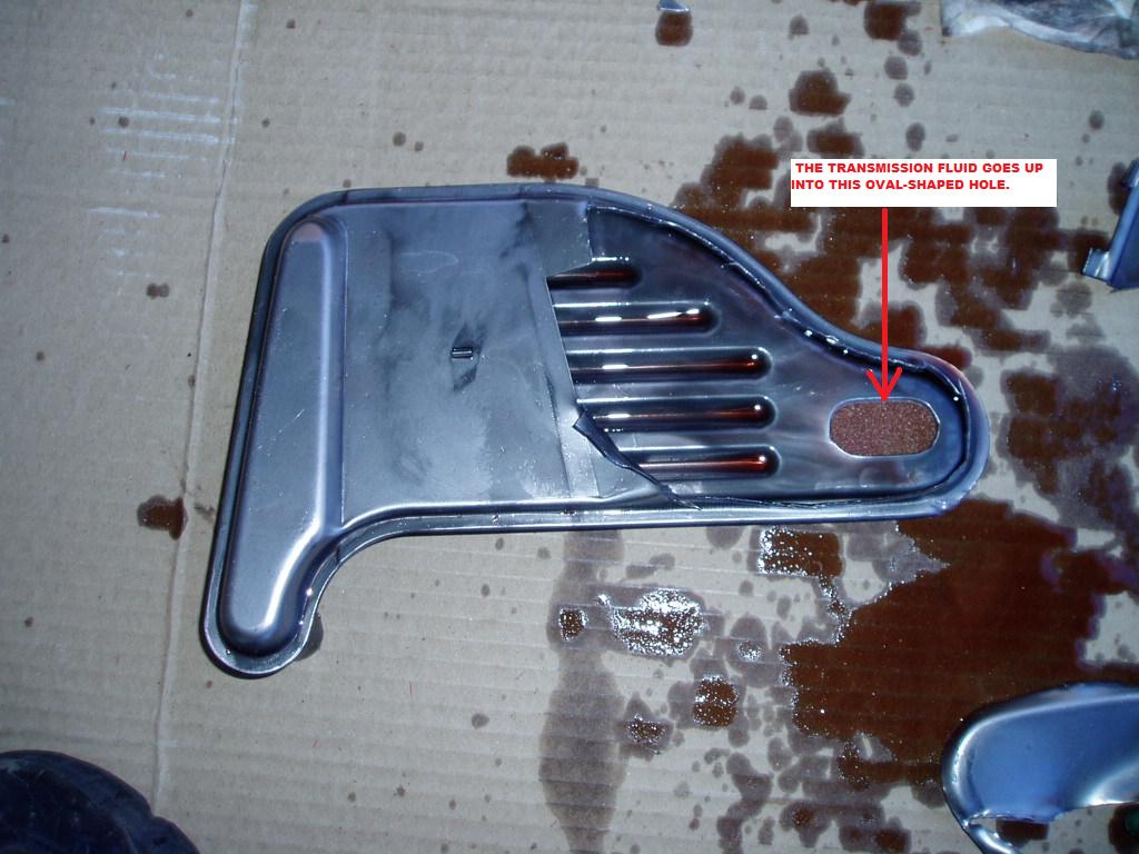

Then up through this oval opening and into the filter media:
