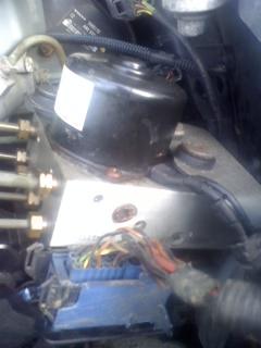

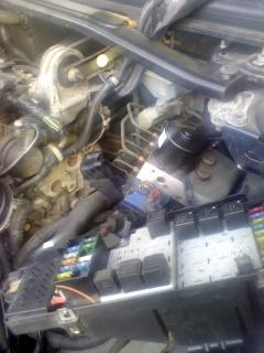

Hi, I'm New Here. First i wanna thnx the person who did the write up, But i am very stuck, i am new in the do it yourself car repair due to low coming income. i have a 99 s80 the car i bought it for my mom as a bday gift 3yrs ago, and for the past year the car started to get all those symtoms Abs light track ect. after much thinking whether to buy another car or fix it i wanna give it a go fixing it, (the car stills mess like new). i located the box where it is, and i started to remove alot of pieces and things to make room(maybe i complicated it a lil more then u guys but i only knew i have to remove that box module). and um stuck i cant seem to locate the four torx bolts that i need to remove so the box can come out. this are pics of what i have done so far.The Box is under that silver thing, but um stuck trying to separate it or dont know how to remove it. PLEASE I WOULD APRICIATE ANY HELP, ALSO I AM A BEGINNER, so please be patient with me if i dont understand something. thank you.
- The Box is under that silver thing, but um stuck trying to separate it or dont know how to remove it
- 3.jpg (11.42 KiB) Viewed 4074 times
- remove all the air tubes
- 5.jpg (13.66 KiB) Viewed 4075 times
- 6.jpg (15.22 KiB) Viewed 4075 times

First off, welcome to MVS.
The bolts, at least on a 850, are on the bottom of the module at all four corners. They are not a standard torx but an E-torx which is like a bolt head with an inverse torx pattern.
I'm not sure if this is at all applicable to your S80 but one of the other Moderators - Vegasjetskier - has an S80 and he likely knows.
...Lee
...Lee
