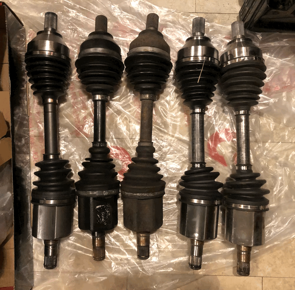

Here's a little picture to illustrate the troubles I've had on this repair:

Finally axle #5 (who's counting. Oh wait I am), went in. About 2 weeks ago just before I had 9 day work blitz.
Almost got the whole car re-assembled. Except I sheared a bolt off on the new strut / spring I put in (Mazda 3 unit), and the second bolt fell underneath the flippin engine fusebox and vanished.
Had no drill on hand - great, yes I know. Was in Vermont country. Couldn't drill out snapped replacement bolt. Very light pressure sheared the piece of garbage right off.
Back to VT with drill, bits, extractors, and spare bolts and magnet on a fishing wire to try to get that damn bolt back out of hidden engine area. Hoping to get it reassembled today. The battery will only charge up to 11 VDC max. Not good. Sat around in cold weather too long with this never-ending job.
Very happy we bought a 2010 XC70 at auction about 6 weeks ago. Much better car.
