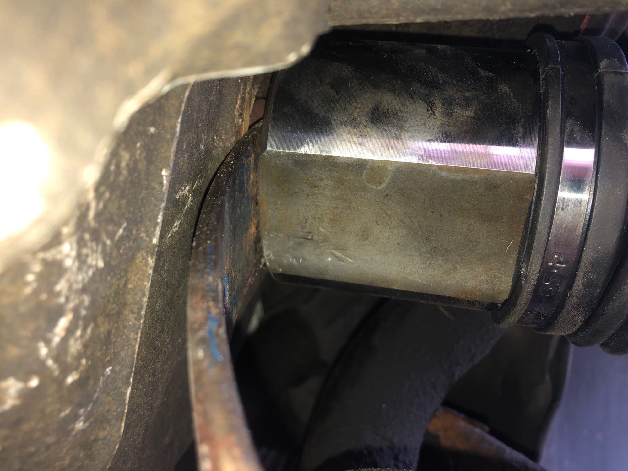

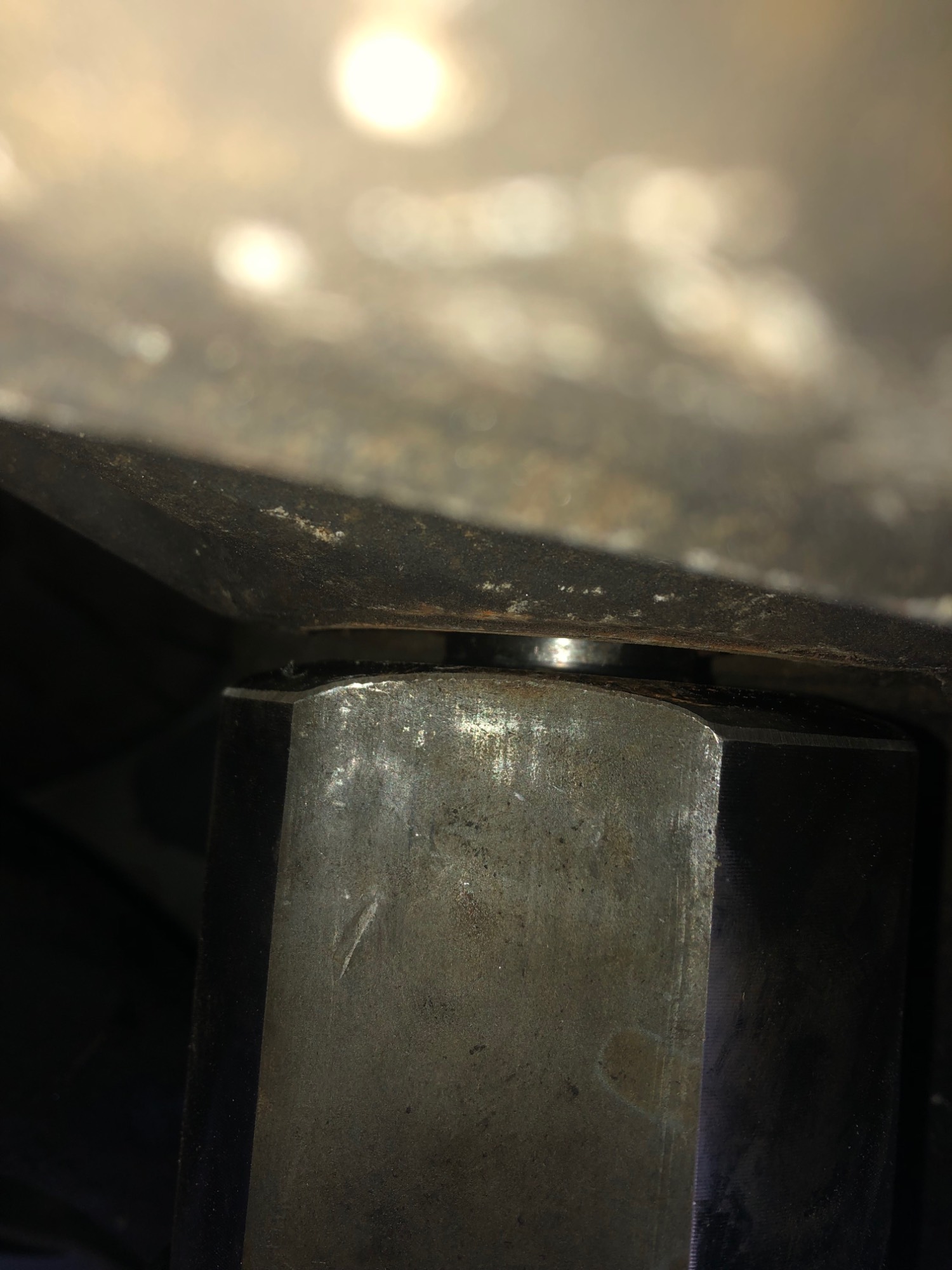

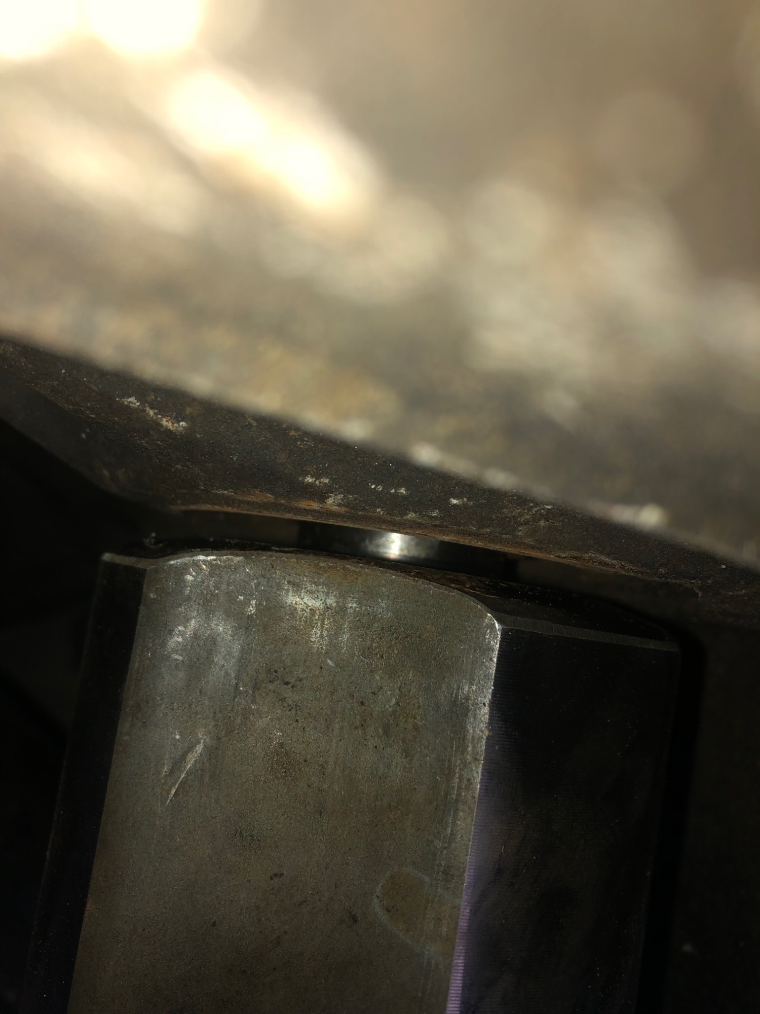

Pictures of the joint

Have you any way of measuring the position inside the trans where the circlip fits in terms of depth from the front of the casing?
Then compare with the OE axle to the cup rear and the aftermarket one. You may find the difference is there and what you have is the axle is seated correctly but the gap is just larger due to a difference in the axles.
