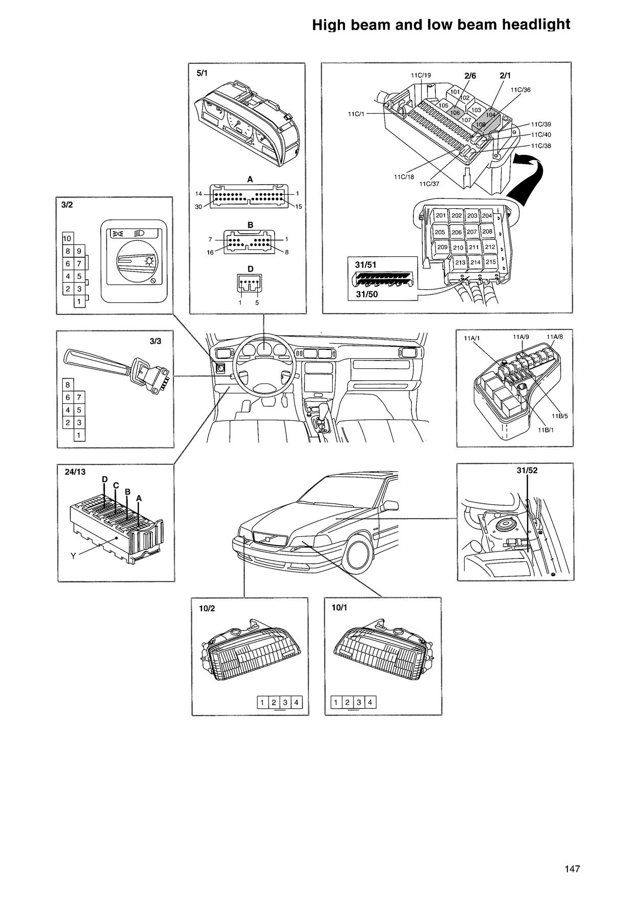

Rosebud wrote:I have a 2000 S70. The L lowbeam headlight is out. The fuse and headlamp are ok. I checked the voltage to the fuse and nothing registers for the L lowbeam. The R lowbeam fuse registers 14.8V. What should I check next?
Based on your tests you should verify the following;
1- The continuity between fuse 11C/21 and the headlight relay 2/1. It is unit 104/108 of the fuse & relay panel ( near the windshield).
2- If it test OK, replace the headlight relay 2/1.
