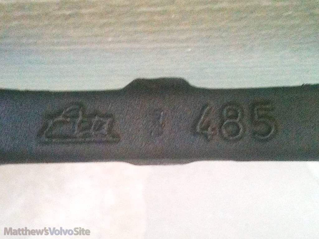

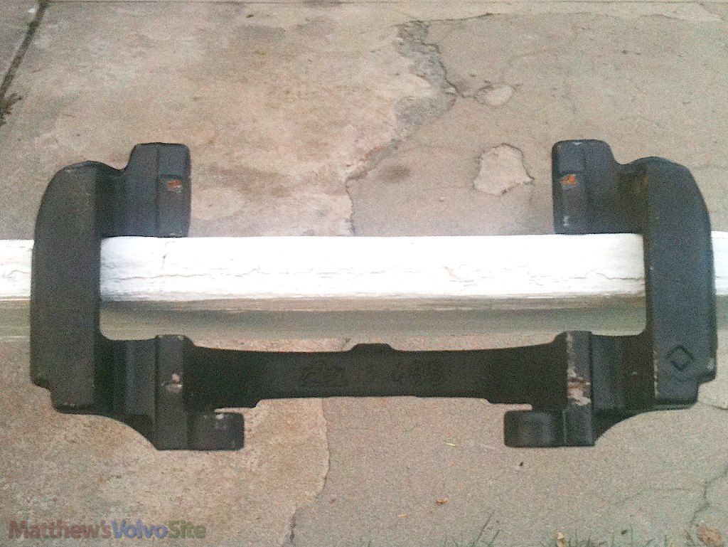

I have no problem with clearance to the wheels, I'll be picking up some 17" rims. I already installed new Stoptech pads and 16" braided lines...and have some 302mm ATE rotors as well...I need confirmation about the correct bracket/part #.

Do yours say "Ate 485"? Attached above are the ones I got used -- not yet installed -- so I can't say 100% that they are correct 302mm front brake caliper brackets.

No they do not, but you can tell from the photos that the brackets I have are entirely different
