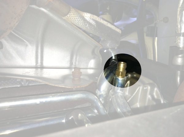

For anyone stumbling upon this prior to changing his/her coolant, here's the block petcock:
Here's the radiator petcock highlighted
But, that thing is flimsy - you want drain by detaching the lower radiator hose:
