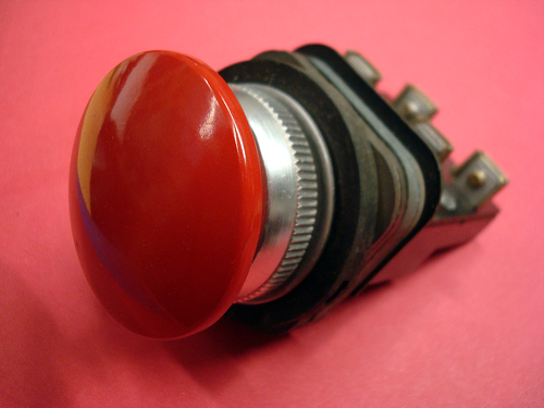

I'm totally doing this and making it a red button.

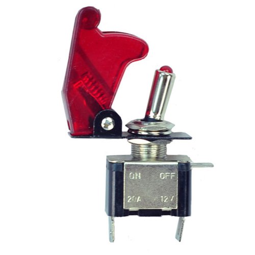

boosted5cyl wrote:I'm totally doing this and making it a red button.
Or
This 12v switch on Amazon.com w/MVS link embedded. More practical than a button, because you'll need both hands fighting that torque steer.
